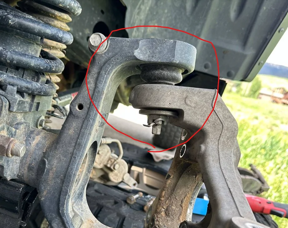

The ball joint end of the drag link that connects to the knuckle. I guess I should have said drag link end so it wouldn’t be confusing.

That image isn't from a "ball joint", though.
The ball joint of a Jeep with solid axle is in the steering knuckle and the 'C' of the axle tube (at the end)
The joint pictured may be a tie rod end or a drag link end.
If you go asking for a ball joint, that is not what you'll get from a parts store.
You need to shop for a drag link or drag link end.
the correct term can be very important. If the mechanic was looking at the end of the drag link and said "ball joint", he may be blind or learned under the branch of an old oak shade tree in his back yard. If he pried on or moved the drag link, he didn't check the ball joints.
If someone said "go replace the ball joints, that will fix it", you'd still have a drag link end that is iffy and have wasted your money on ball joints (well, not wasted, after-market are sometimes better than the stock ones)

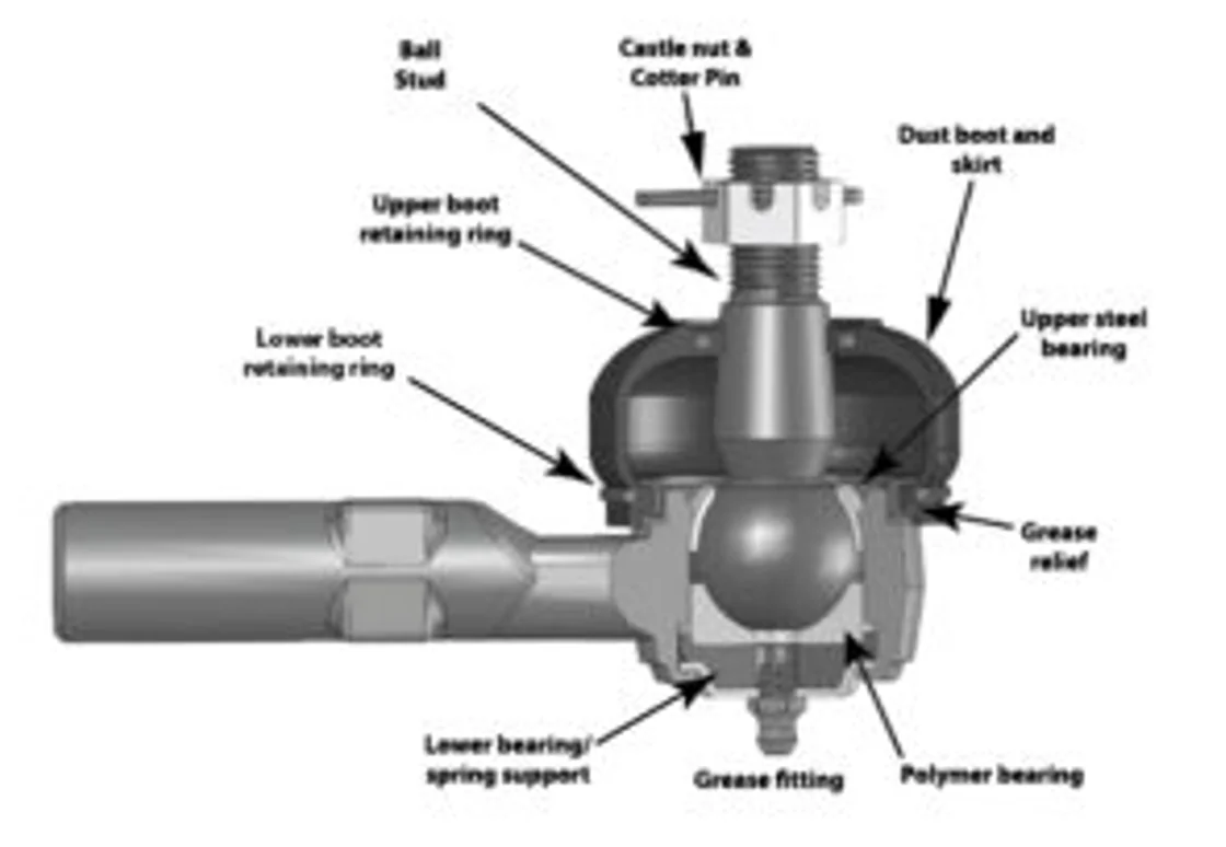

This is a drag link end -
Jeep Gladiator 2021 Jeep Gladiator Willys front passenger side clunk. 1761856816438-wj
this is a Jeep Gladiator ball joint -
Jeep Gladiator 2021 Jeep Gladiator Willys front passenger side clunk. 1761856884774-so
And it goes here - (and on the bottom of the knuckle as well)
Jeep Gladiator 2021 Jeep Gladiator Willys front passenger side clunk. 1761857031504-r
and here -
Jeep Gladiator 2021 Jeep Gladiator Willys front passenger side clunk. 1761857098630-g5

Thank you for the explanation and yeah he did pry the drag link end up and down and there was play with a clunking sound. The only confusing part is when he said the lower ball joint is shot and it's better to change all 4.......... Unless if the drag link end has anything to do with the ball joint I have no idea. He tightened the bolt at the drag link end which was a bit loose.
40,483
53,967
T
All I can think of is he was prying on that to get the knuckle to move up and down and wasn't REALLY checking the drag link, although that's what it was pressing on (in order to raise and lower the steering knuckle.
So it's possible he pried on the drag link to check the ball joints - because prying up on the drag link could move the right side steering knuckle up.
