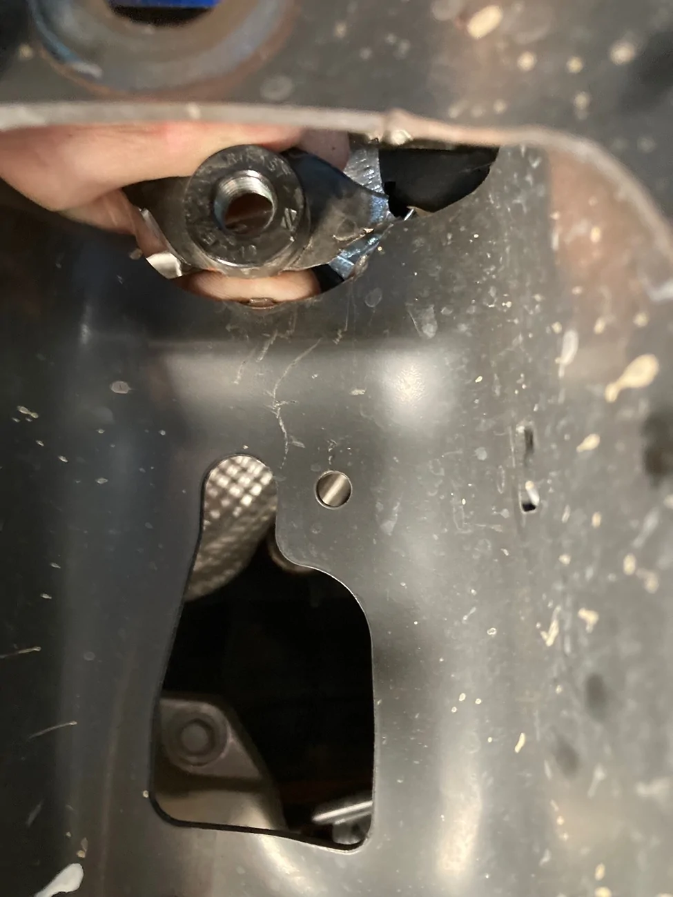

Sbro2021
Jan 1, 2022
181
495
2021 gladiator rubicon diesel
I had a clunk I couldn't find either, until I randomly did. My passenger side shock tower broke where the bung is the bolt goes into. Welded it back together and has been good since. Probably a stretch, but since the world at large thinks your clunk is an imaginary friend, might be something else entirely like mine was. Good luck to ya!
