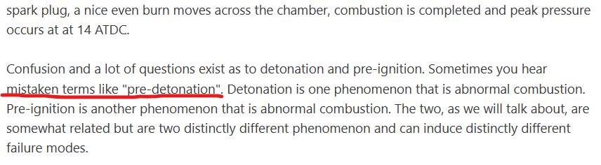

I can post a ton of materials - including this bit from a detailed study and explanation of each - look at the terms!
Jeep Gladiator 2022 Gladiator (3.6ltr V6 GPEC 2) pinging at very low throttle settings 1714602262380-qt

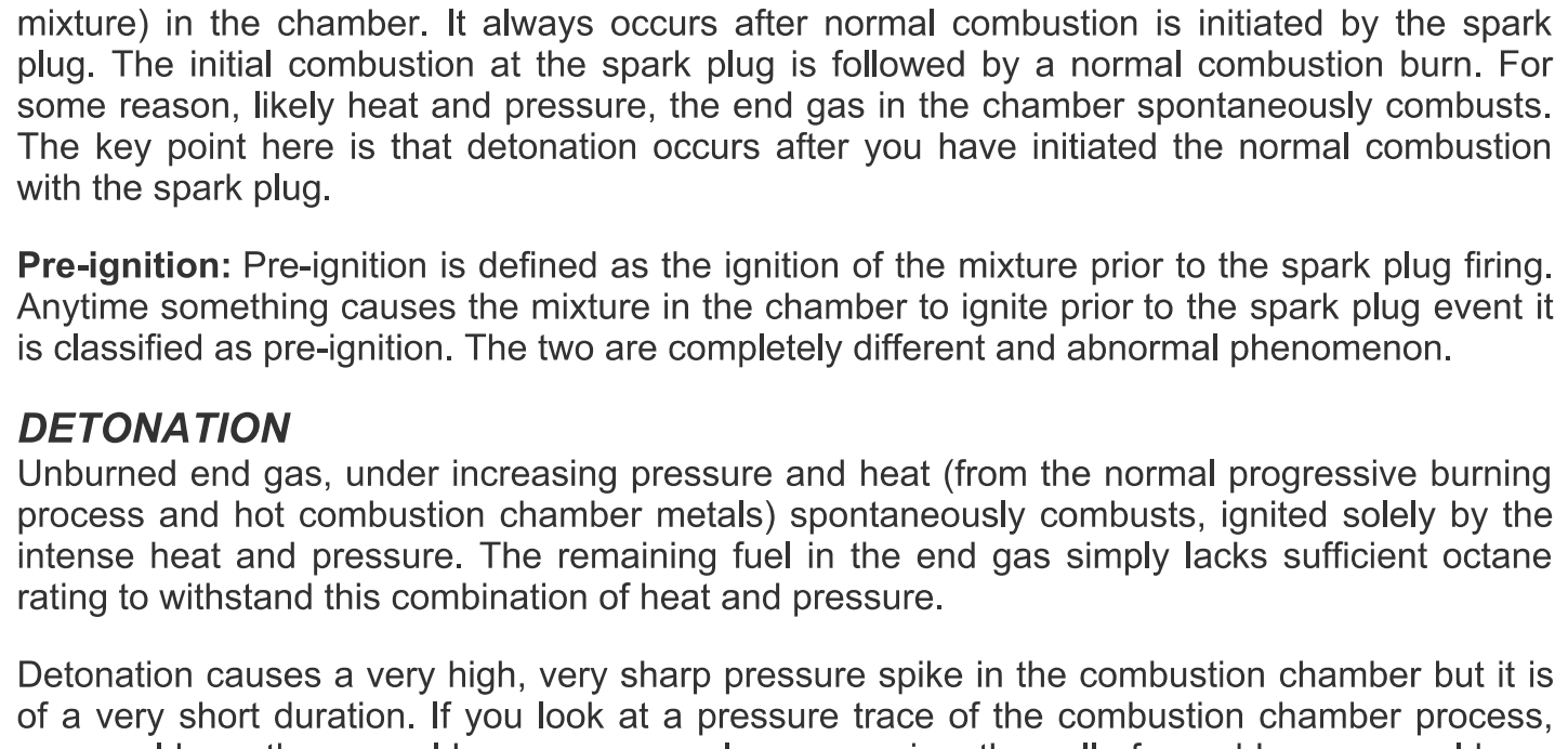

This is from a GM engineer who actually designed engines and wrote on the science of combustion -
Jeep Gladiator 2022 Gladiator (3.6ltr V6 GPEC 2) pinging at very low throttle settings 1714614084880-e2
