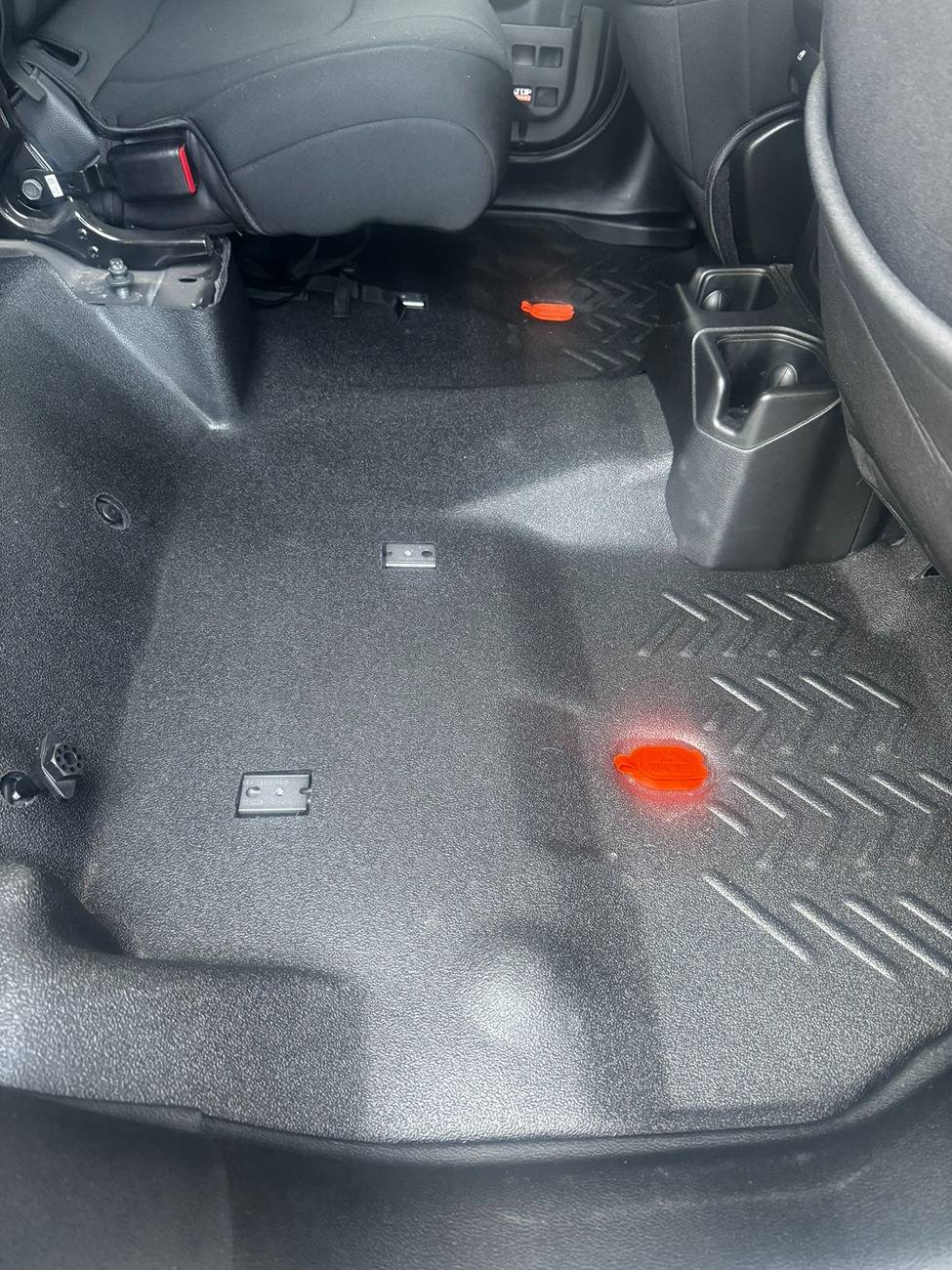

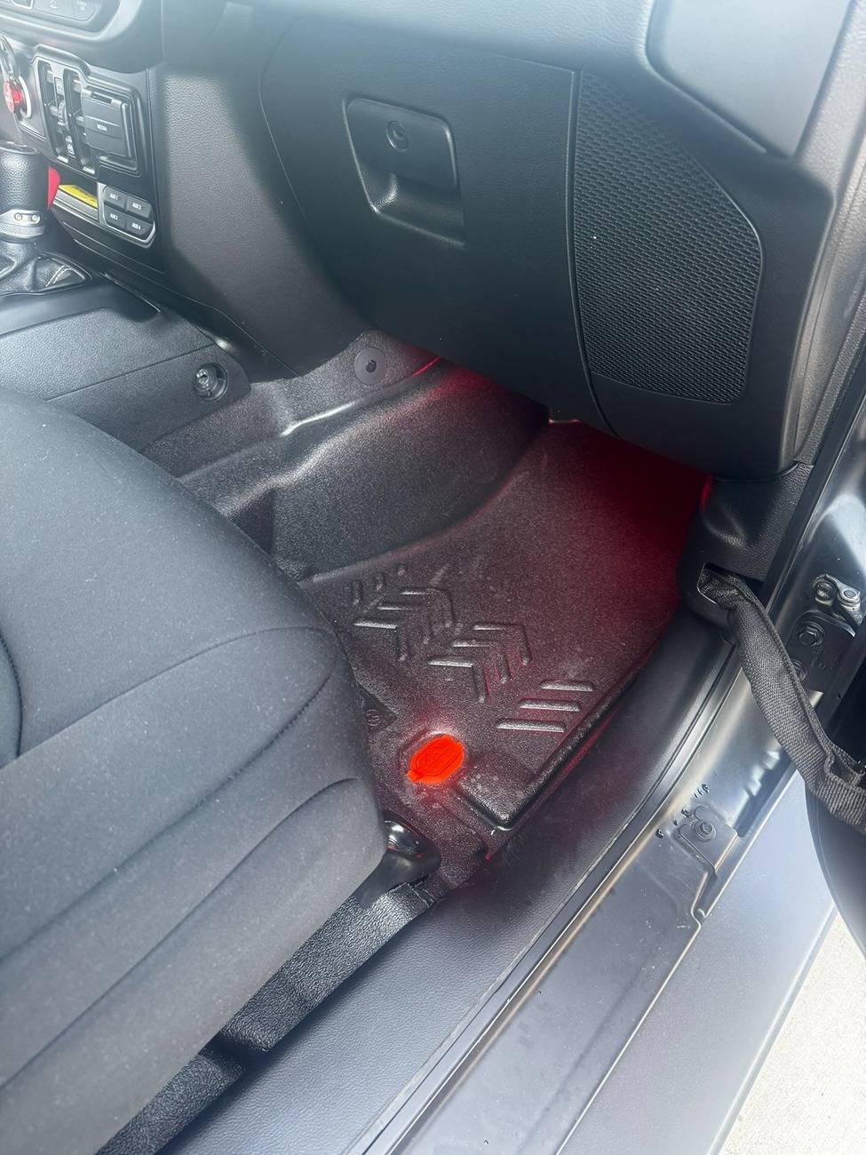

Armor Lite flooring + Seat Covers
First the not so sexy addition of neoprene seat covers from Diver Down (Amazon purchase). We do a variety of activities where we get sweaty, wet, or muddy. I have been protecting the custom leather seats with towels, but they need constant attention to keep them situated. I have always put neoprene seat covers in my Jeeps, so I decided to go this route again to protect the leather. If anybody cares, I can confirm that the Diver Down covers are a perfect fit.
Over this past weekend, I also removed the carpet and installed the Armor Lite floor system. Why? I've never been a fan of carpet in my Jeeps, so I usually pull it and then bedline the inside of the tub. I only recently learned of Armor Lite, so I wanted to give it a try. Their product is a direct swap, which makes it simple in concept, but I found it to be a PITA to install. It took me around 4 hours to remove the trim, then the carpet (easy), install the Armor Lite, and put back in the trim.
Installation notes:
> The Armor Lite isn't very flexible by design. So, aligning it to the carpet mounts is a fight with the trim around the center dash trim. I even had the pieces sitting in the sun while I took out the trim and carpet.​
> I have Seat Jackers installed in the front and ultimately, those made this more difficult. The Armor Lite doesn't fit perfectly around the blocks, so when re-installing the door trim, the trim doesn't sit level where the Armor Lite is bunched up around the blocks.​
> when doing the rear floor, it is best to start with the sections that slide under the front seats and then fitting the rear portion is easy.​
End result? I really like it. What makes the install difficult is the rigidness of the product, which is what you want in the end. Would I do it again over bedlining the inner tub? Yes.
