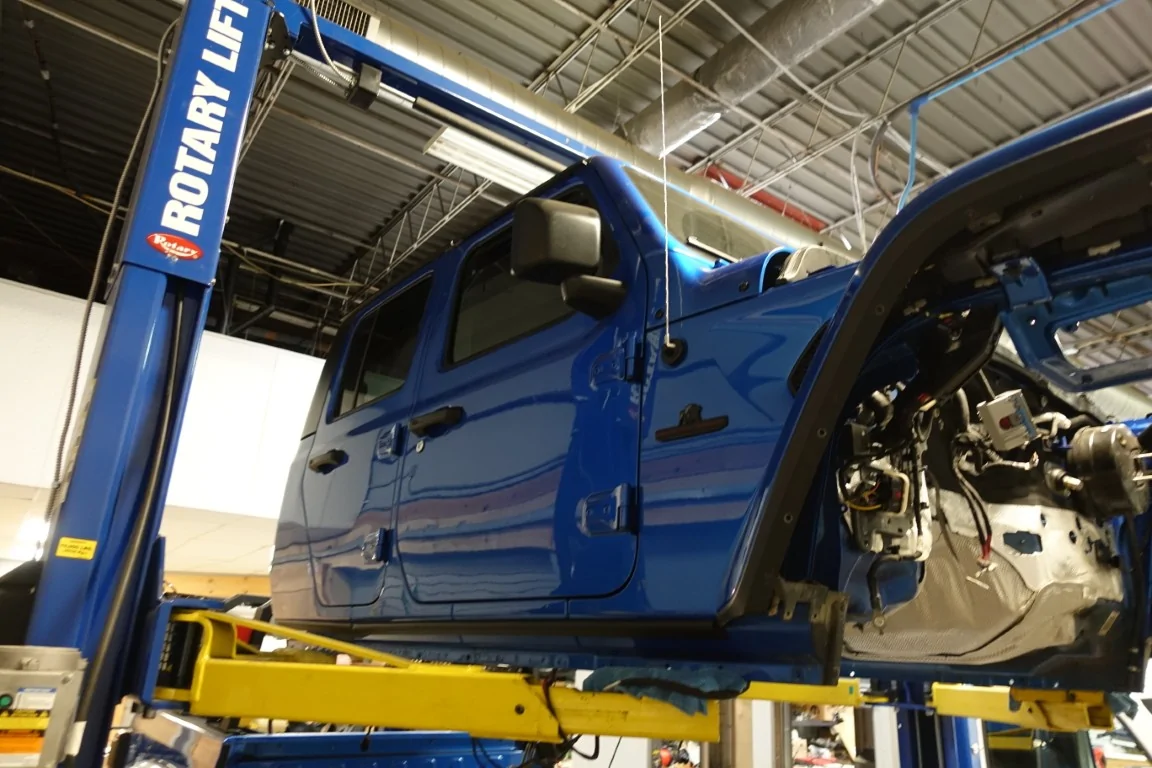

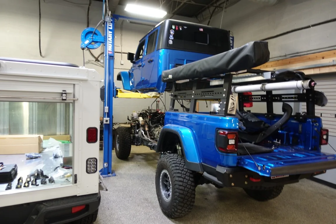

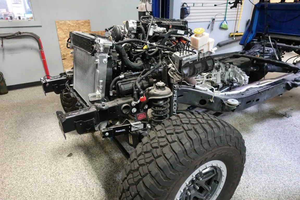

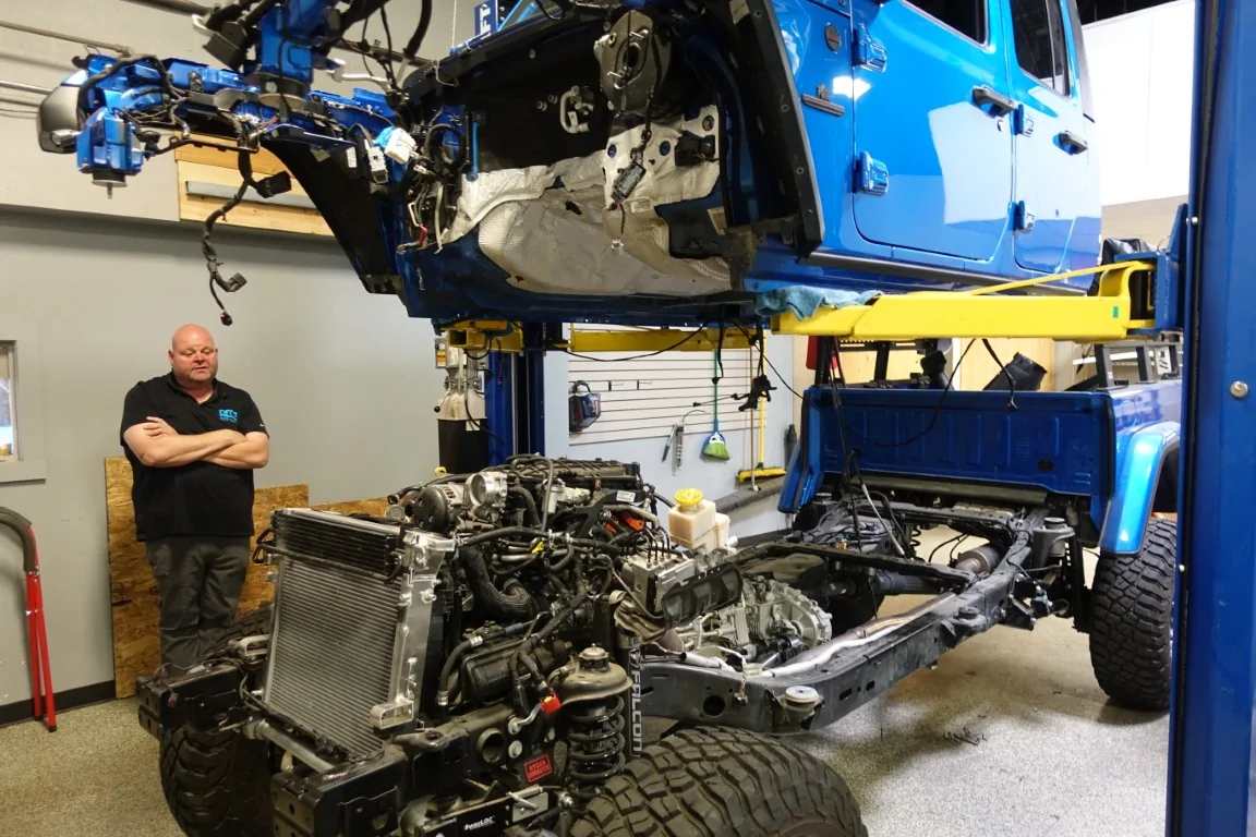

It turns out we have been waiting on a new engine mount system. After scanning the actual JL and JT engine bays, the guys at the shop designed their own proprietary mount system. They then printed it in plastic to check fit, then created one in steel, which was welded to a chassis and fitted with a Hemi. I saw that beautiful mount and Hemi in a Gladiator all bolted up. They are having those mounts produced locally right now.
My JT should be under the knife very shortly.
Note: This is not an AMW conversion but a completely new swap designed by this shop.
