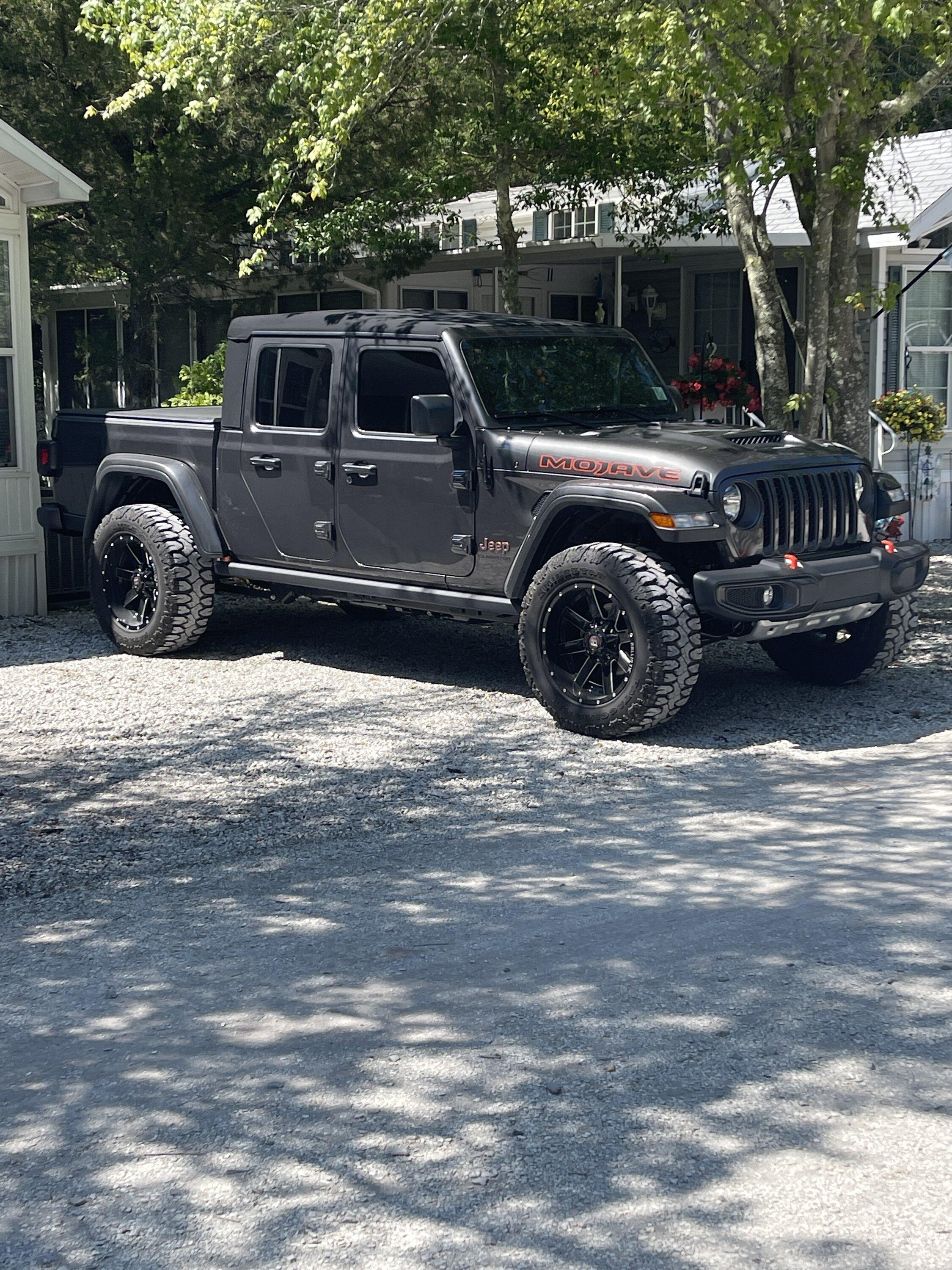

I have have several Jeeps just traded in my 2020 Rubicon unlimited for a Mojave Gladiator. Loving it so far. I had a set of 35s with TPMS sensors on the Rubicon that worked fine with it took them off and put them on 2022 Gladiator however they will not sync up with the JT. Sometimes they do than they disconnect. Are they compatible? Is there a pairing procedure?

No, they aren't compatible. Jeep pulled a switch and the older ones are not capable of connecting to the newer receiver.
Don't know if the newer ones will work on the older models.

There is no pairing or programming required for the TPMS system. The TPMS sensor change was around June 2021. The sensors are not compatible, they need changed to match the TPMS system in the vehicle.

68339096AB is the OEM part number for the post 6/7/21 build TPMS sensors.
Quadratec sells a supposely compatible aftermarket sensor, but it seems to be a mixed bag.
