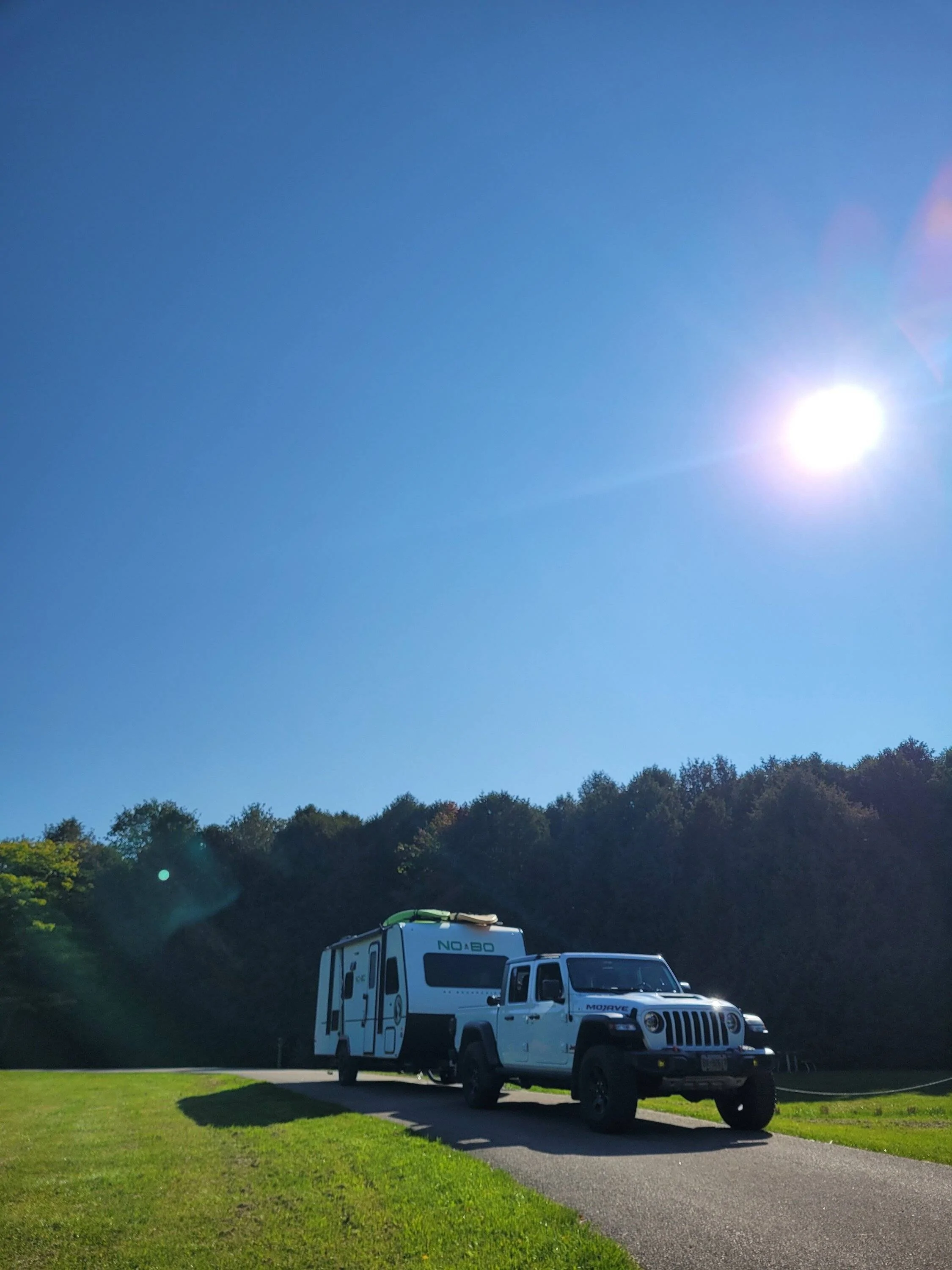

I have been towing similar trailer to what you consider. Payload sneaks up real fast on gladdy with a TT. I put light bicycles in box, and other light items when towing. 4 people, dog, hitch, tongue weight, and tank of fuel just about does it in for all gladdys and then some unless you have max tow (kids and dog small for me fortunatley for now). My trailer came with roof rack, but I find tongue weight easily creeps up and high weight not great. Trailer here 23 ft. Total length. 3700lbs empty.
