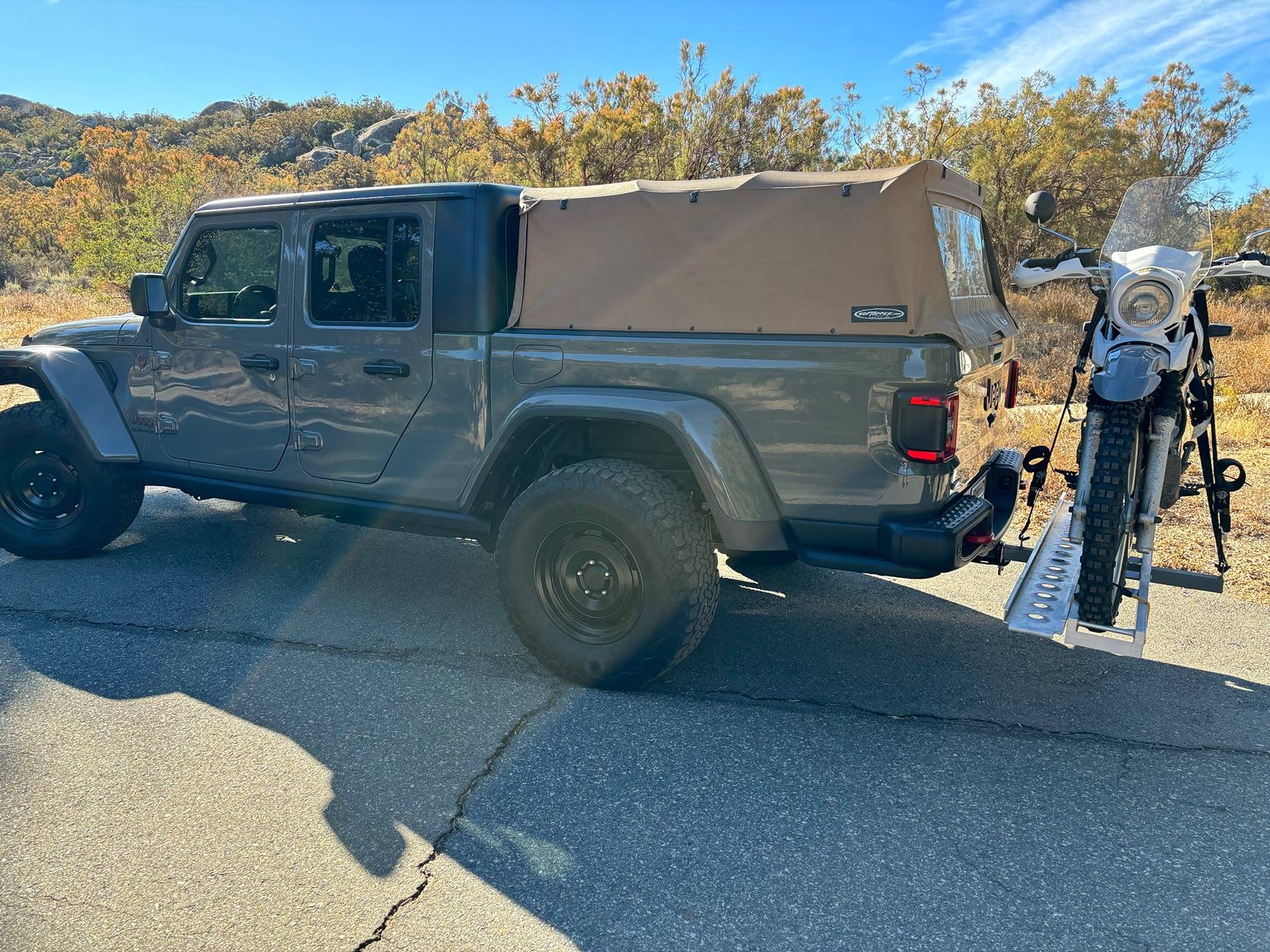

I put my little xt250 on the back with a black widow 400 rack. truck was lightly loaded with 1 additional passenger. Granted the xt is a pretty light moto, no sway issues or poor steering.
Yeah, but what does that thing weigh? I bet 300 tops, with fuel and mud included. Add the carrier and I bet you are still under 325.
Biggest thing to look for in a rack like that with the weight up that high is that the carrier is snug in the receiver and can't rock back and forth. If it can rock or move, you know about mass in motion, plus the wear and tear.
I bet that carrier has a device to clamp it against the receiver so it can't rattle and wobble. If so - then you are likely ok.
You have a light bike and it's close to the butt of the truck. (well, as close as practical)
[/QUOTE]
Yes, 325 max with the rack. I installed an anti-rattle device on the hitch to take away the slop. I wouldn‘t put anything heavier on the back than it.
40,514
54,050
Glad to see you thought of that.
Anyway, nice to see reality, personal experience, real world weights and so on.
