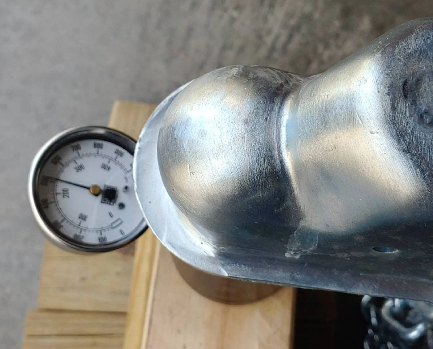

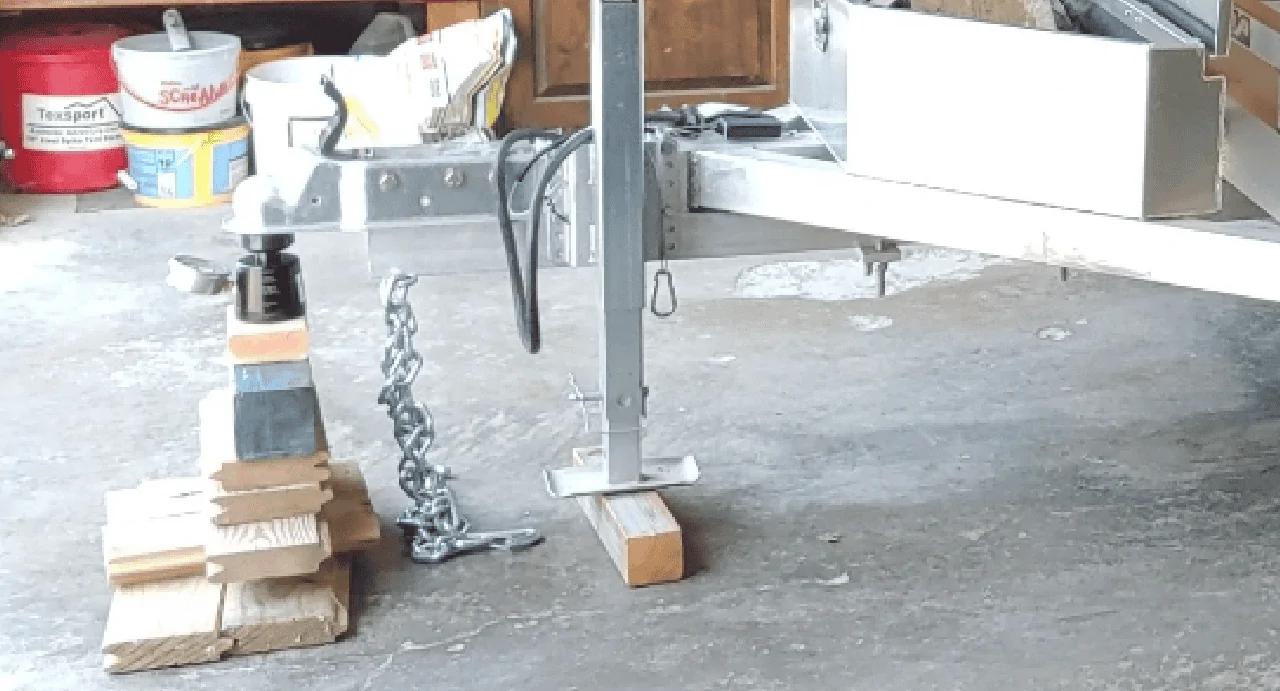

You can't go by advertised weights of the trailer, and you certainly can't go by any advertised tongue weight.
If you are wondering, you need to weigh the trailer. Any accessories or options or upgrades and you toss their factory numbers out the window.
Tongue weight is what's on the tongue - if you put 30 pounds in the trailer and put that 30 pounds in the rear of the trailer, you actually DECREASE tongue weight.
Weigh your trailer tongue - you can do this at home (google it), go to a coop scale, or here we can go to the local landfill and use their scale - weigh your trailer.
