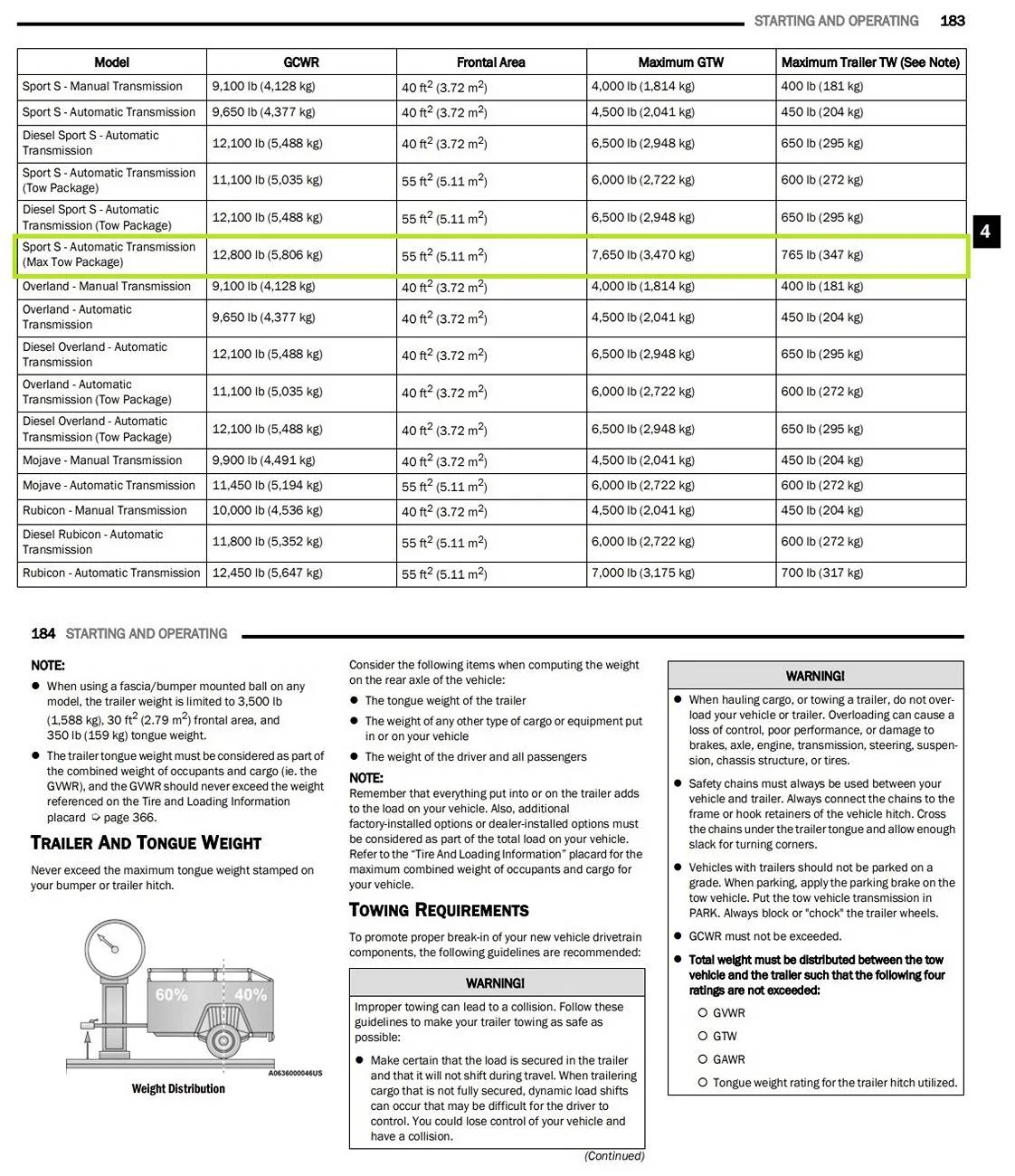

A stock Max tow equipped Sport is rated to tow a trailer up to 7650lb and 55 square feet frontal area, max tongue weight of 765lb, and a combined vehicle gross weight of 12800lb. The trailer GVW you listed is ever so slightly above your max tow rating, but if your truck is stock and you keep your weights within factory specs then it is capable of towing what you propose. All warnings and cautions apply as to payload, hitch type requirements, trailer brakes, reduction in ratings due to vehicle modifications, etc etc etc.....
Arguments as to whether you should or should not do so are separate from your initial query.

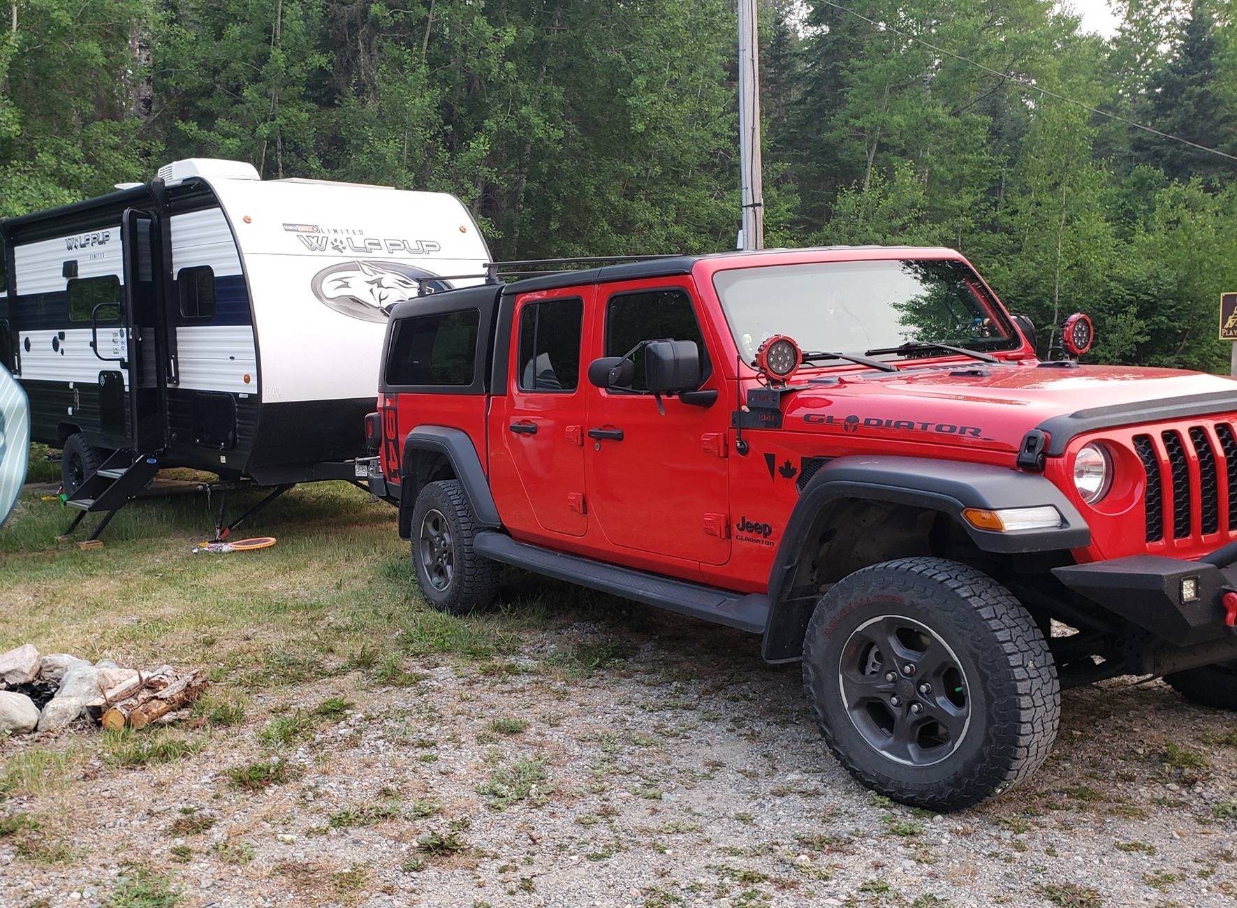

we own a 2021 sport s, and tow a 2024 forest river 17JW wolf pup. 5700lbs,plus 2 adults, 2 kids, and supplies. Use to have 35" tires,went back to 275x70-17,s and got a WDH, I do feel It is getting close to the JT limits but still handles it very well. would like to get one with the Max tow package and feel the difference. usually cruise on flat roads in 5TH and 6TH at about 3500-3900 rpm, drop to 4TH for hills.
