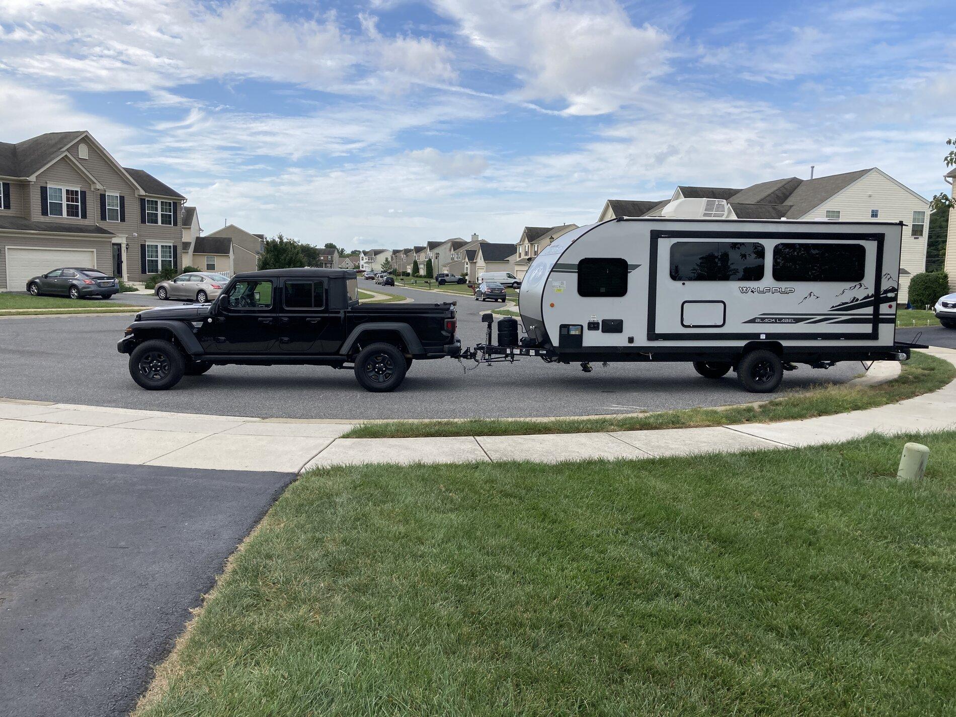

Seeking opinions on towing this TT with a Max Tow
AmishMike
Michael
Jul 29, 2020
65
1,842
4,290
Central Pa
Whipping boy
The Max Tow is the way to go. At least then you get the numbers from the factory to back up any warranty claims. The fact that you are concerned, tells me that you should be a consciences driver. ie. no Jack-Rabbit starts, high speed turns, etc.. Have you towed anything close to the limit on your current JT? That would give you a decent idea.
The biggest difference with those low-optioned F-150's etc. is that they typically have more mass and a broader footprint than the Gladiator. Therefore getting pushed around less, I don't worry about how long it takes to get up to speed but what happens on the brakes or in a turn or in bad weather.
Not sure what your towing experience is. Being a farmer in the trucking industry, I am used to big trucks from F-250's up to 18 wheelers, tankers etc.. I like a lot of truck in front of a trailer, but now pull with my JTR. I took @Gren71 's advice and added air-bags and I love them; check out his write ups about tires etc.. I would say that a WDH is a necessity.
Sounds excessive but reading something like a CDL manual can help anyone brush up on techniques like snub braking etc. that can all come to your aid.
Don't be in a rush, taking your time to travel can avoid a lot of frustrating moments. Remember, the adventure is in the journey not the destination.
(That trailer looks beautiful!) Enjoy!

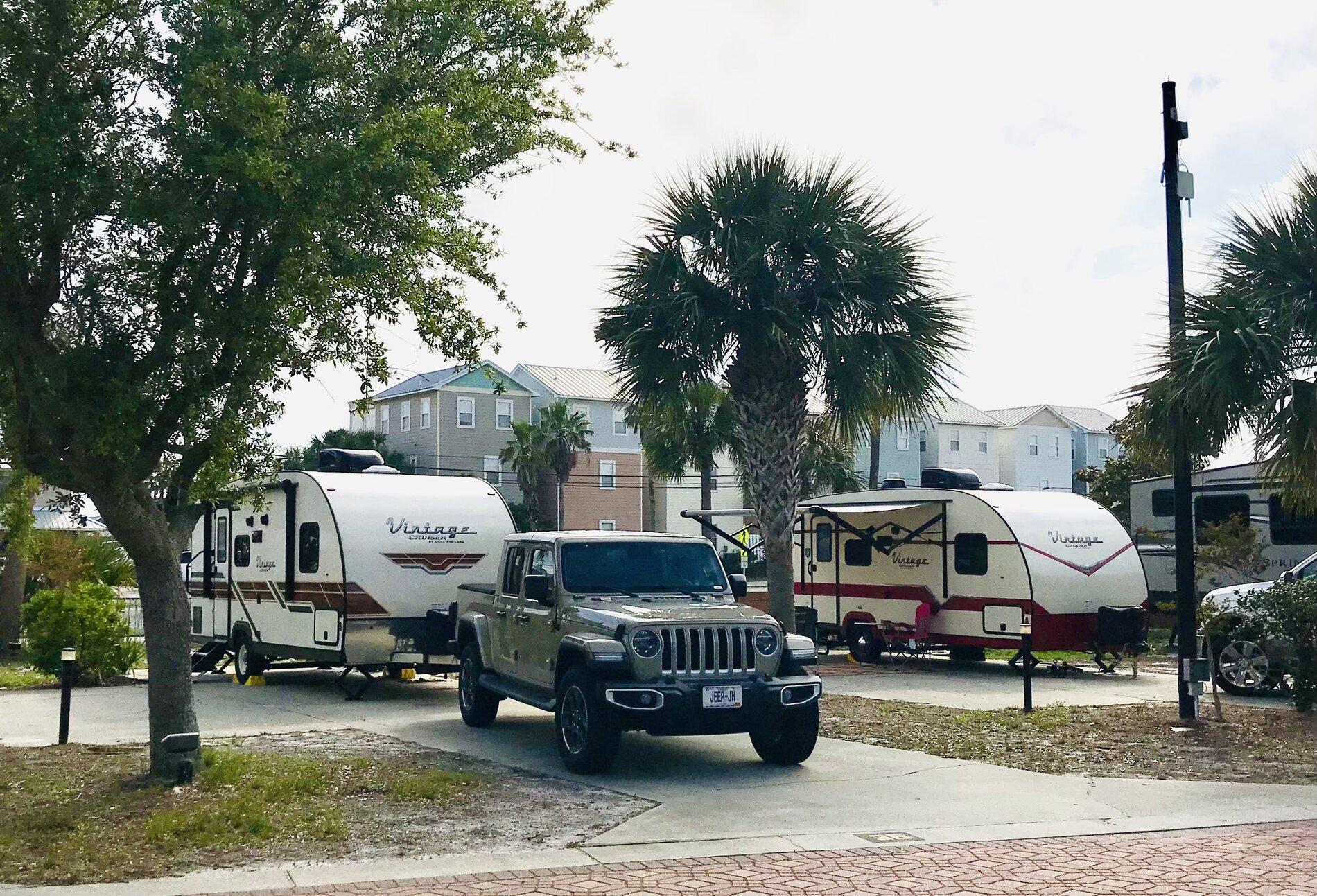

We just sold our old, old Prowler 19' camper which weighed 3500 pounds, and are looking for a Vista Crusier 19ERD, dry weight of about 3100 pounds, hitch weight 360 pounds, checks a few of our requirements, no slides, rear dinette with all around windows, large refrigerator two doors, bed that you don't have to climb over someone to get in, and between 7' to 7'6" wide. I have towed my Boston Whaler weighing about 5,000 pounds, dry fuel tank, and it brings you back to reality we are still driving a narrow jeep with a six cylinder. I feel a camper at around 3,000 dry will top out at max of 4,000 for us and I always figure a tank of fresh water in the calculations, as it is needed sometimes for remote camping. Look around some more, look at same line of camper but smaller, life on the road will be more comfortable. The Vista crusier 17 foot version, lacks the big fridge, and walk around bed, but comes in at 2560 dry weight, that is pretty impressive for a camper with a rear dinette and dry bath......Jack

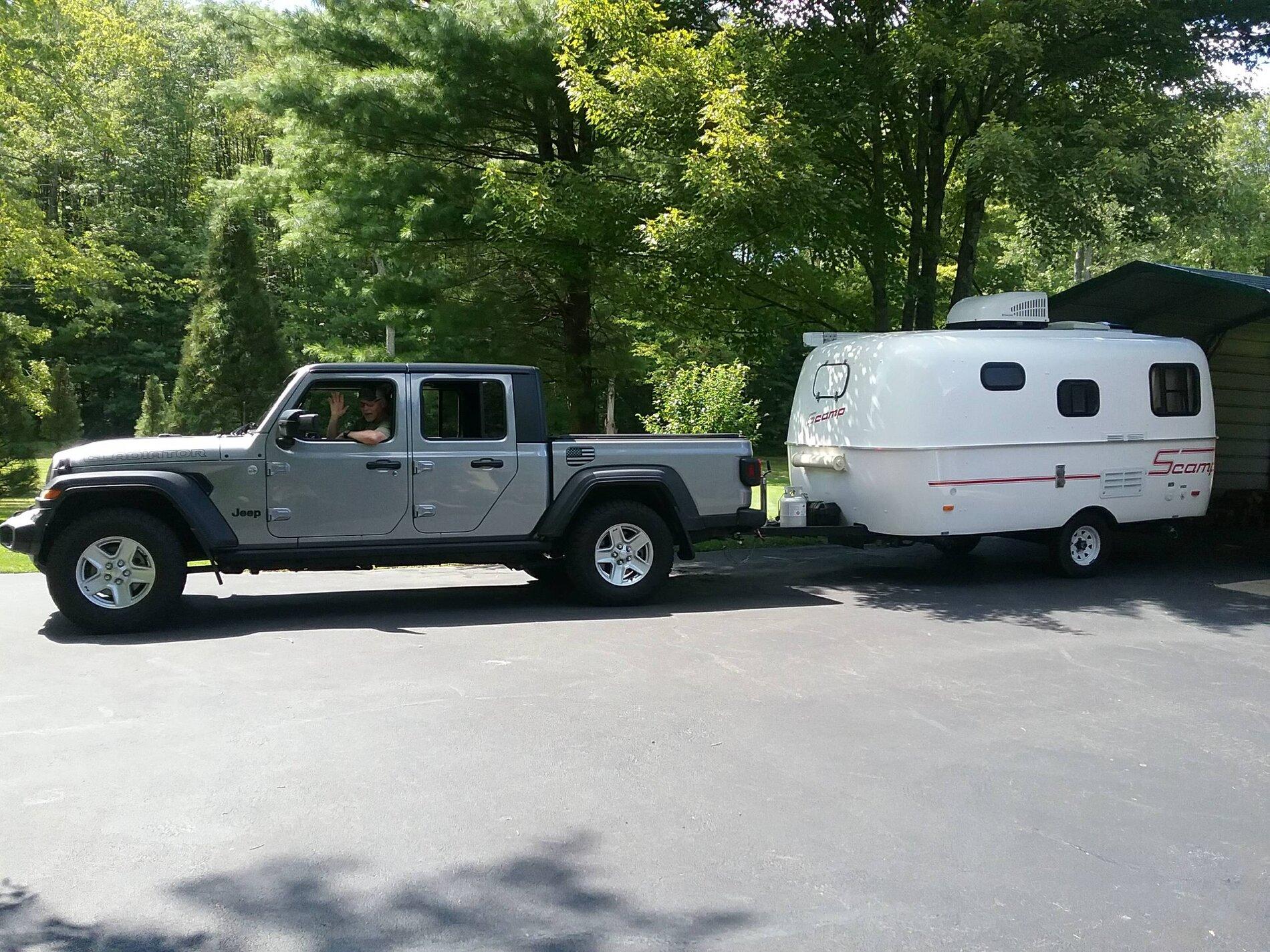

Towing a lighter TT without Max Tow. 3,400 pounds dry with 350 pounds at hitch. Mopar brake controller, Equalizer weight distribution / sway control hitch, and Gladiator tow package. Have towed 3,400 miles with no problems and good control. Even survived a near-death experience when a jackalow in an RV pulled in front of me on I-70 from a dead stop. I cruise at 60-63, leave plenty of space to stop, and travel with empty water tanks. You should be fine if you use common sense.
