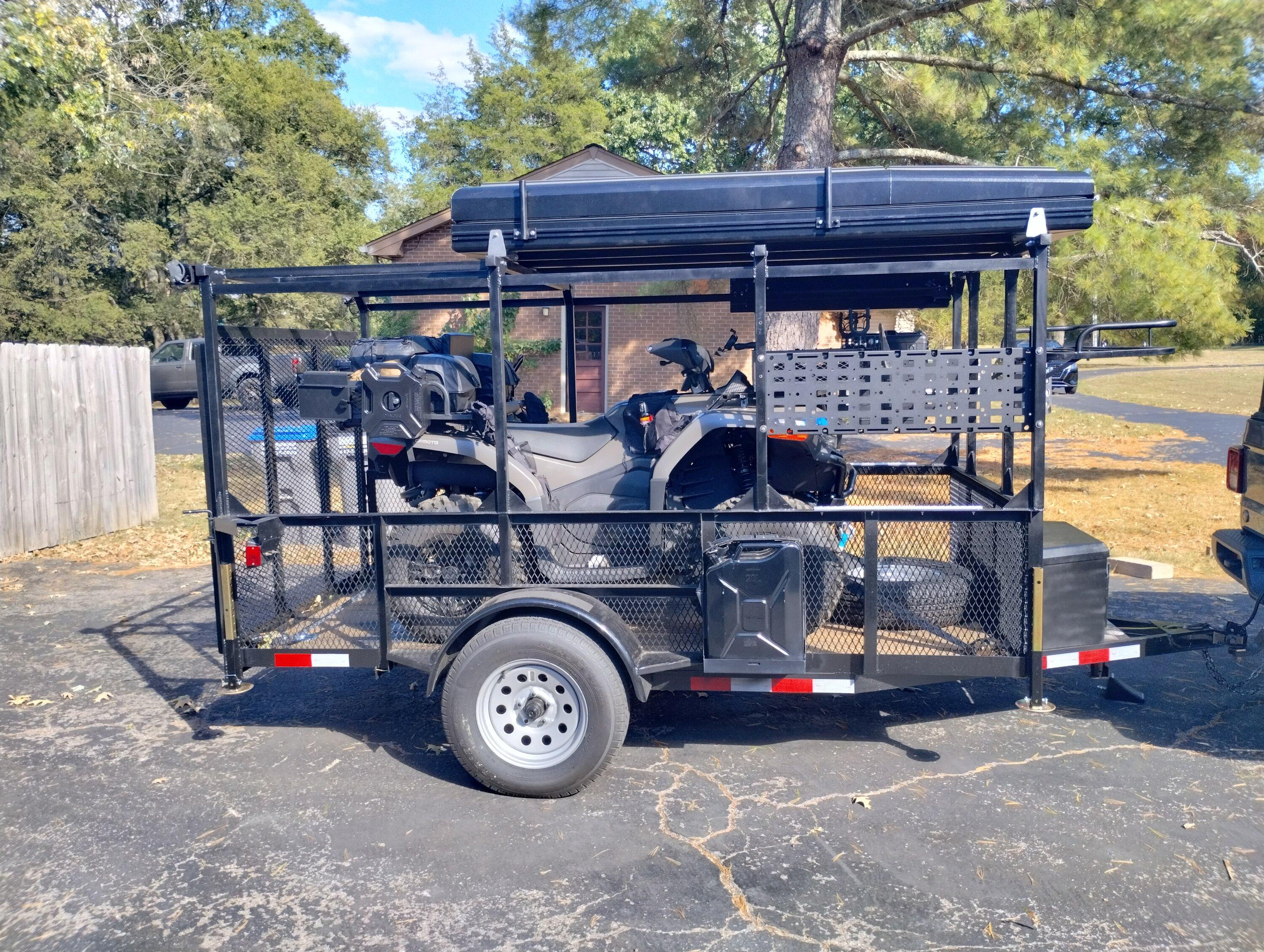

I may have missed this in the comments but I recently discovered that my Gladiator surges while towing at any speed, more when the trailer is loaded, and it it shakes violently when I hit around 58 mph. This only occurs while towing. My JT is a 2020 with the max tow package. I also have air bags in the rear as well as a 1/2" spacer. 285/70/17 KO2s on factory steel wheels. The trailer is a 5x10 utility trailer with a custom rack and RTT. I don't have trailer brakes yet or a WDH. Fully loaded with my RTT, awnings and ATV I believe it weighs just under 2500 pounds.
I went to the dealer yesterday and they refused to even drive the Jeep since it isn't throwing any codes. They blamed the trailer, but I've never heard of a trailer causing an engine to surge or spider like mine is doing.
