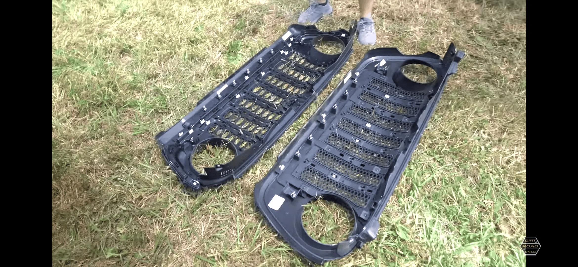

There's a reason that Jeep stopped putting the engine covers on the engines, and that they're changing the grille design to allow more airflow.
A. Remove covers bc they're penny pinching
B. My guess on new grill:
1. they saw so many people wanting the blacked out grill
2. Making it shorter allows better winch cable routing and easier for service departments to remove the grill with the winch still on now that it's a factory offered part.
3. Redesigning for better airflow likely makes it a one size fits all across all wrangler/gladiator trims (cost savings).
The new grille does flow more air on top of being shorter for the winch. There is significantly more open area now.
Jeep Gladiator Overheating While Towing Screenshot_20230613-034204
