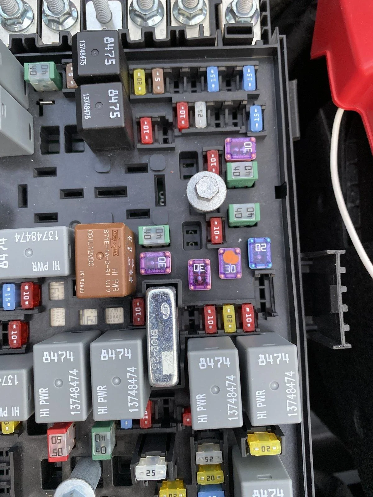

I checked the fuse box. Made sure all fuses were seated. checked the two fuses that made the most sense, and both of them were good.. Finally just broke down and took it to the dealer. They fixed it in 15 minutes. It was a blown 30 amp “purple” fuse, F37. they put an orange dot on it for reference
Jeep Gladiator charging camper from 7 pin while while towing imag

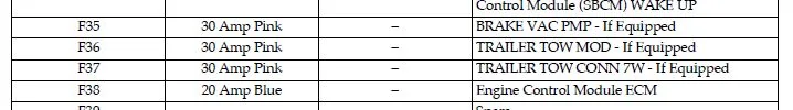

As was stated F37 is the battery. Here is a snip from the owners manual. F36/37 would have been the first 2 i checked.
Jeep Gladiator charging camper from 7 pin while while towing trailerto
