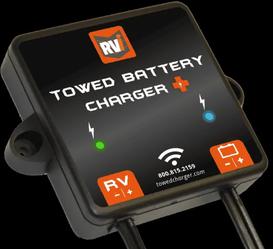

I dont know how or if this will work for you but it is pretty much what you are asking about.
We have this installed in our Jeep Wrangler that we tow behind our motorhome. It takes the power from the plug into this unit and keeps our battery charging while we are towing and have our supplemental brake on. Im not quite sure what your system is or what you are trying to do, but I don't think you can just run a wire.... you need something like this device to do the charging. The problem will be this appears to be designed to charge a car battery and you might have to contact them about your 2 6V AGM batteries to see if it is compatible and if it will work.
The good news if it will work its only $85 and a fairly easy install.
Here is a link to the web page. When you click, the middle of the page has a large black image and near the bottom of it is a button for a video..... this might help you.
https://rvibrake.com/products/towed-battery-charger-plus?variant=13115309260823
Good luck

I went to an RVI dealer about 6 months ago who told me that he would just run a wire directly to the 7 pin connector if I were him. He said don’t waste your money. My Gladiator has been running just fine ever since.
