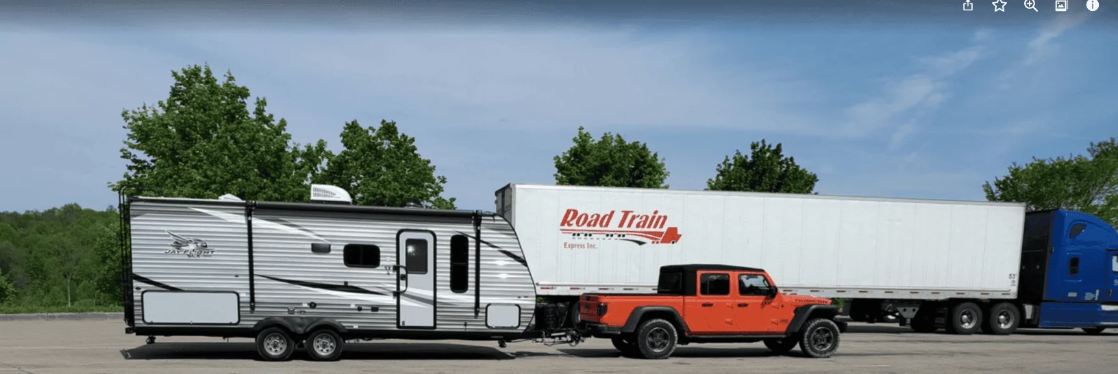

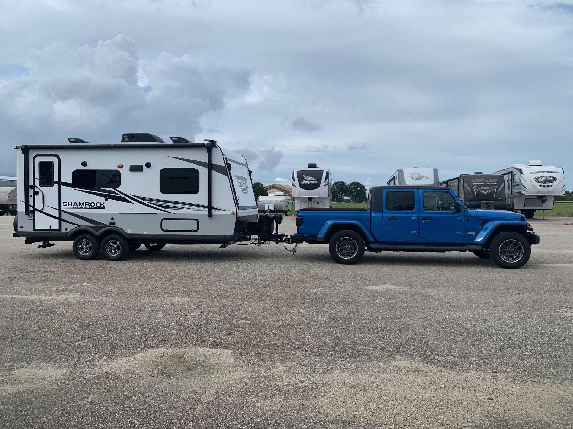

I've got an Overland with a regular tow package, using an Echo wireless brake controller/WDH and towing a Shamrock 19 Hybrid, 4,300 lbs dry weight. The auto trans seems to want to stay at 4k RPMs and I get an average of 10MPG when towing. Do any of you with similar setup have same experience?
Nice! I'll be pulling a similar length Rockwood Roo (Hybrid). I've ordered a MT. Do you have air bags, or just the WDH?

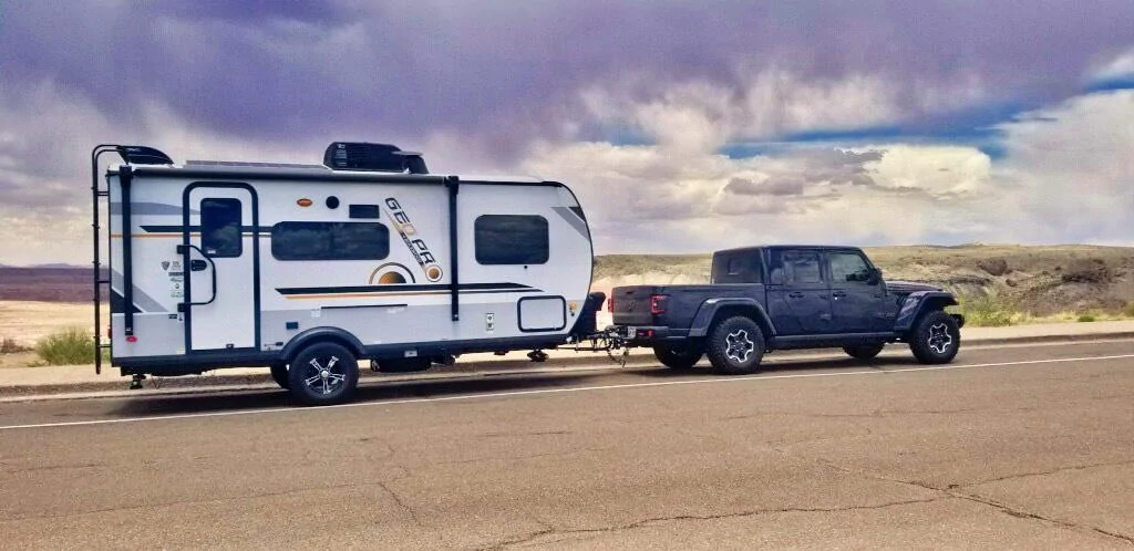

I tow a TT here in the west. Regularly at 10k feet elevation. I also am in the high-desert where we experience winds. The Gladiator tows fine. On the real steep stuff at the peak of a mountain I slow down quite a bit, but on the highway and even moderate climbs I can maintain speed limit. So far so good. Dry weight is about 3200lbs on this trailer, with 400ish lbs at the hitch. I think in reality its quite a bit more, but I don't think I top 5000lbs fully loaded. I'll go to a weight station and check in a few weeks when the temps are up.
Having said all that, having a solid anti sway / weight distribution hitch helps a ton. Before I had that, there were many white knuckle moments. Also, trailer brakes are crucial.
Great looking setup! I'd put the weight distributing hitch in the "crucial" category too. For tow weights under 3,000 probably would put it ahead of the brakes, but that choice depends on other factors too.

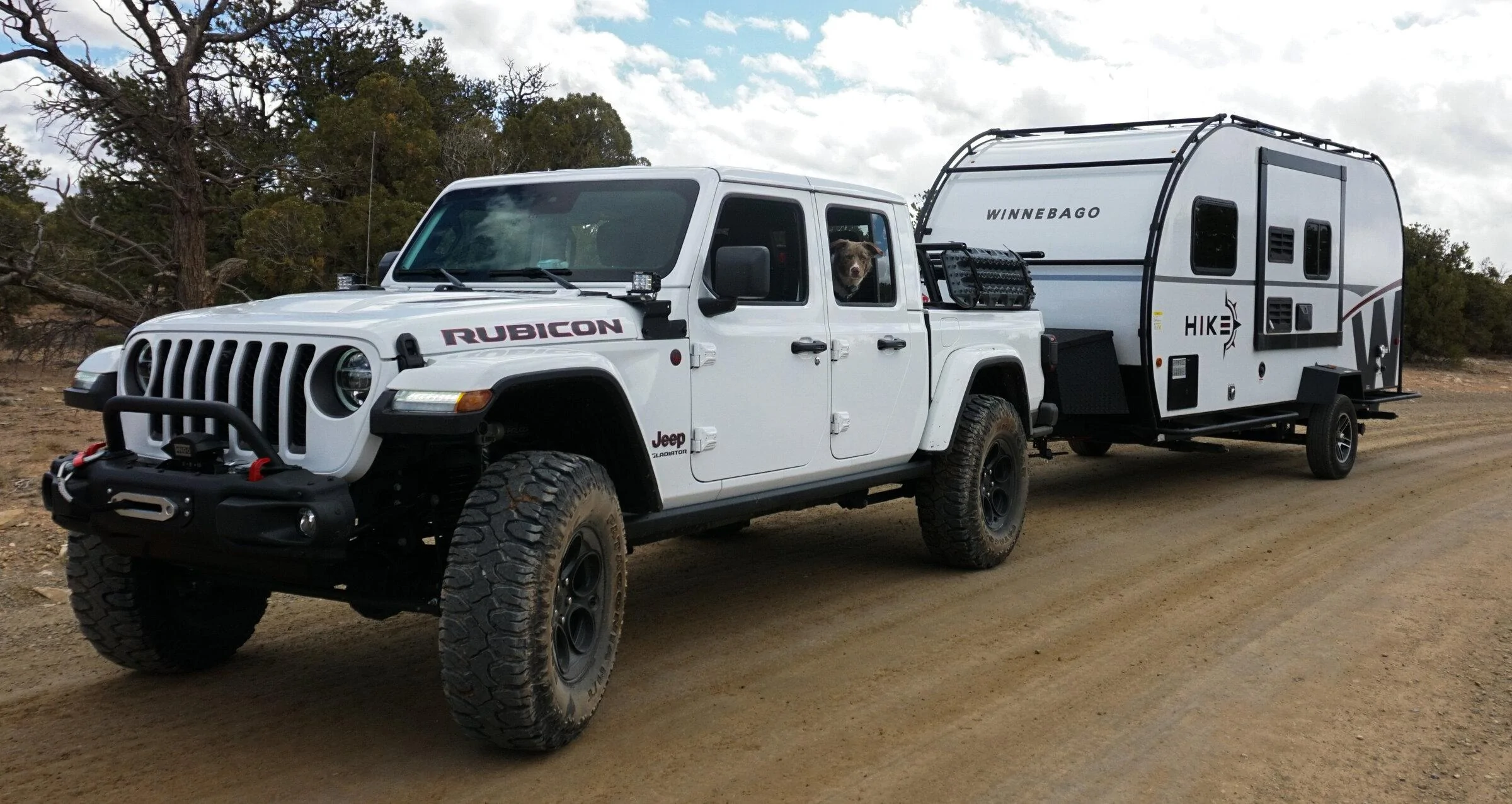

Jeep Gladiator Seeking opinions on towing this TT with a Max Tow 017FE9AC-350E-49D6-9CCB-3BFCA1DA1A64_1_201_a
That is a FANTASTIC setup. I love the Hikes. It looks great with your JT!

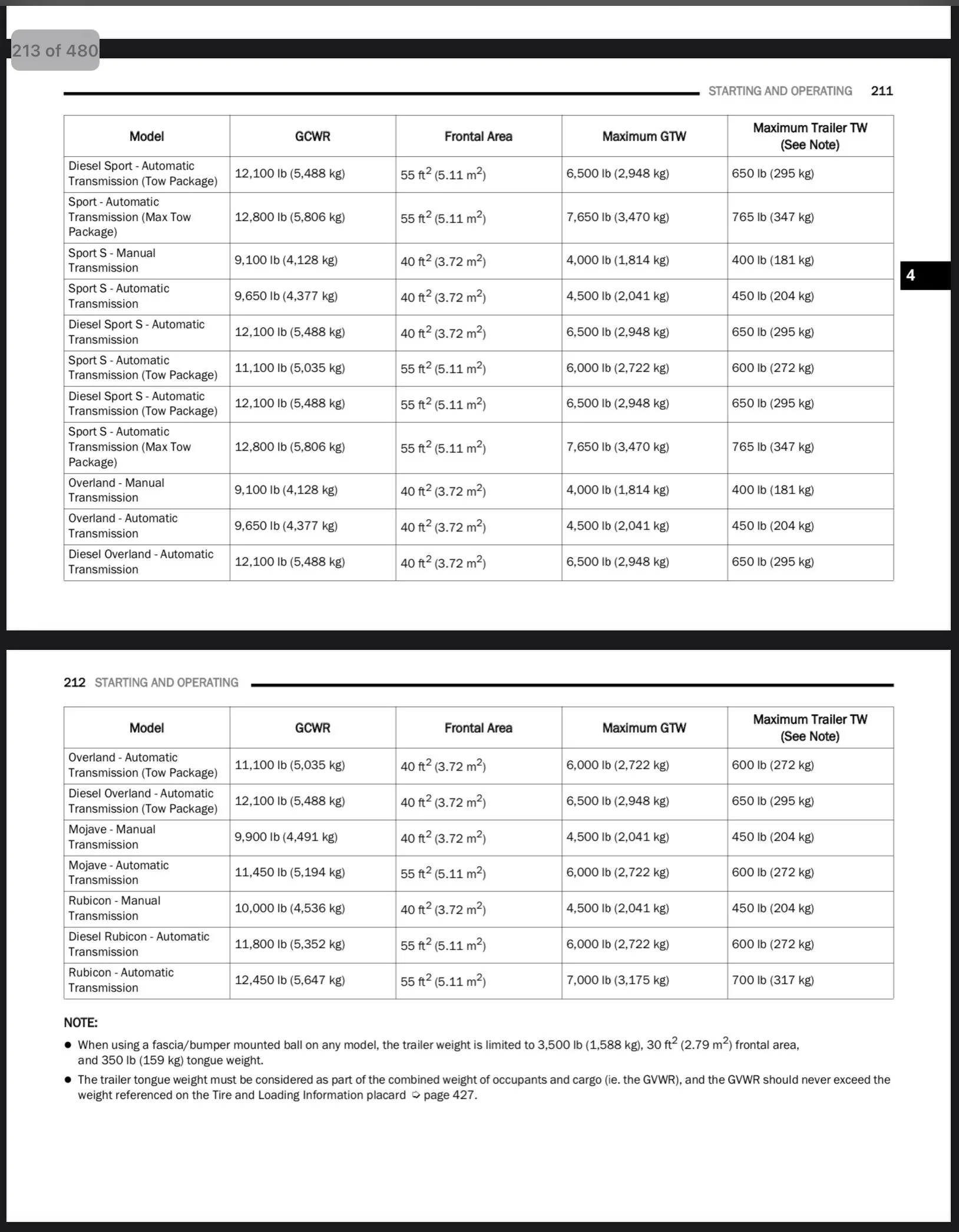

Also, no one mentioned the ownerā€™s manual regarding towing limits, specifically the frontal area.
Jeep Gladiator Seeking opinions on towing this TT with a Max Tow 3E56C304-AE0A-4D21-9B7F-E21455C0EC0E
At max 55 sqft. is not a lot. If you have a 8ft wide trailer, the max box height should be 7.33ft. I realized this is just one metric but it definitely impacts towability.
