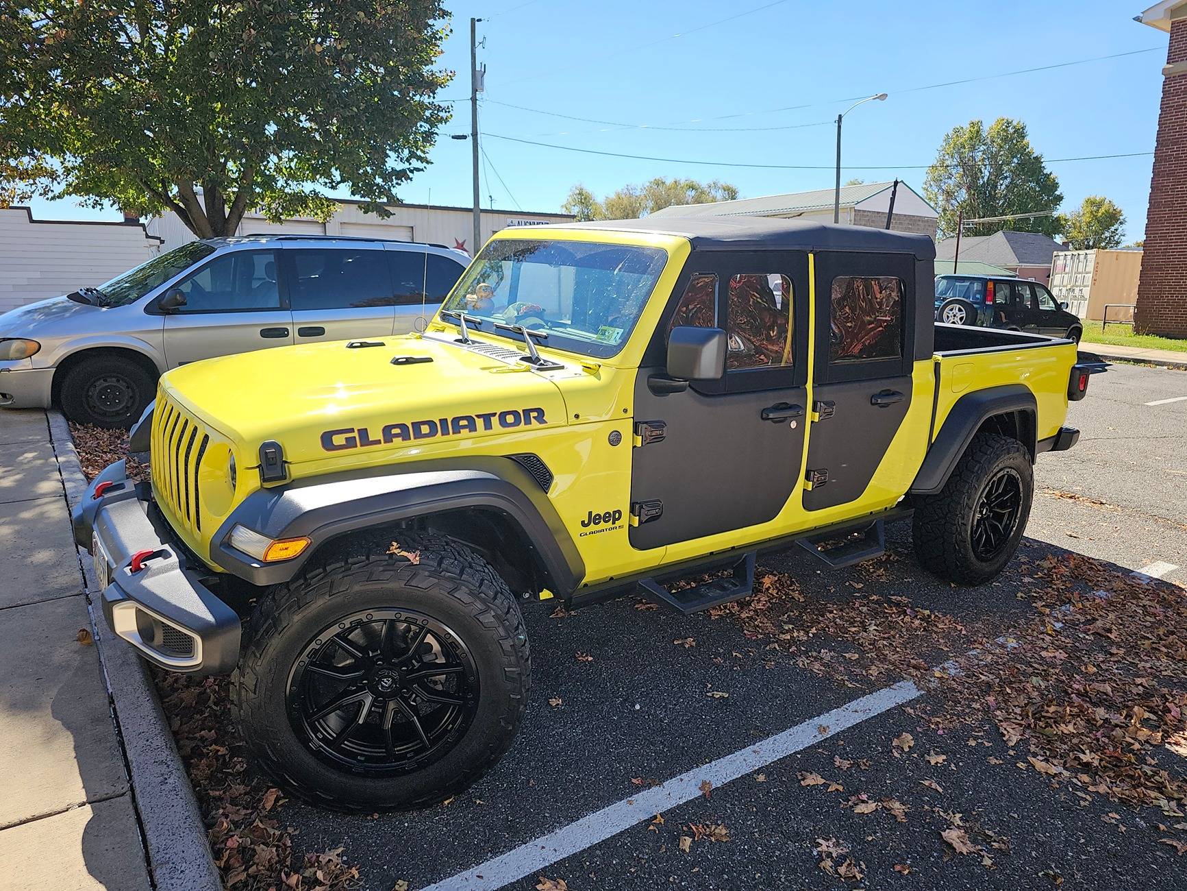

I just purchased a 2023 sport and after new tires the next purchase was a pair of half doors from a 392. They are full loaded with power mirrors ,lock and blind spot monitors. Any way I can activate these options s o. My lowly base model?
Does your Jeep already have power windows and blind spot monitoring?

No I have the base model with nothing power on it
Then how do you expect those to work?
Tazer or jscan can enable blind spot monitoring, but you'll also need the sensors and the bumper.

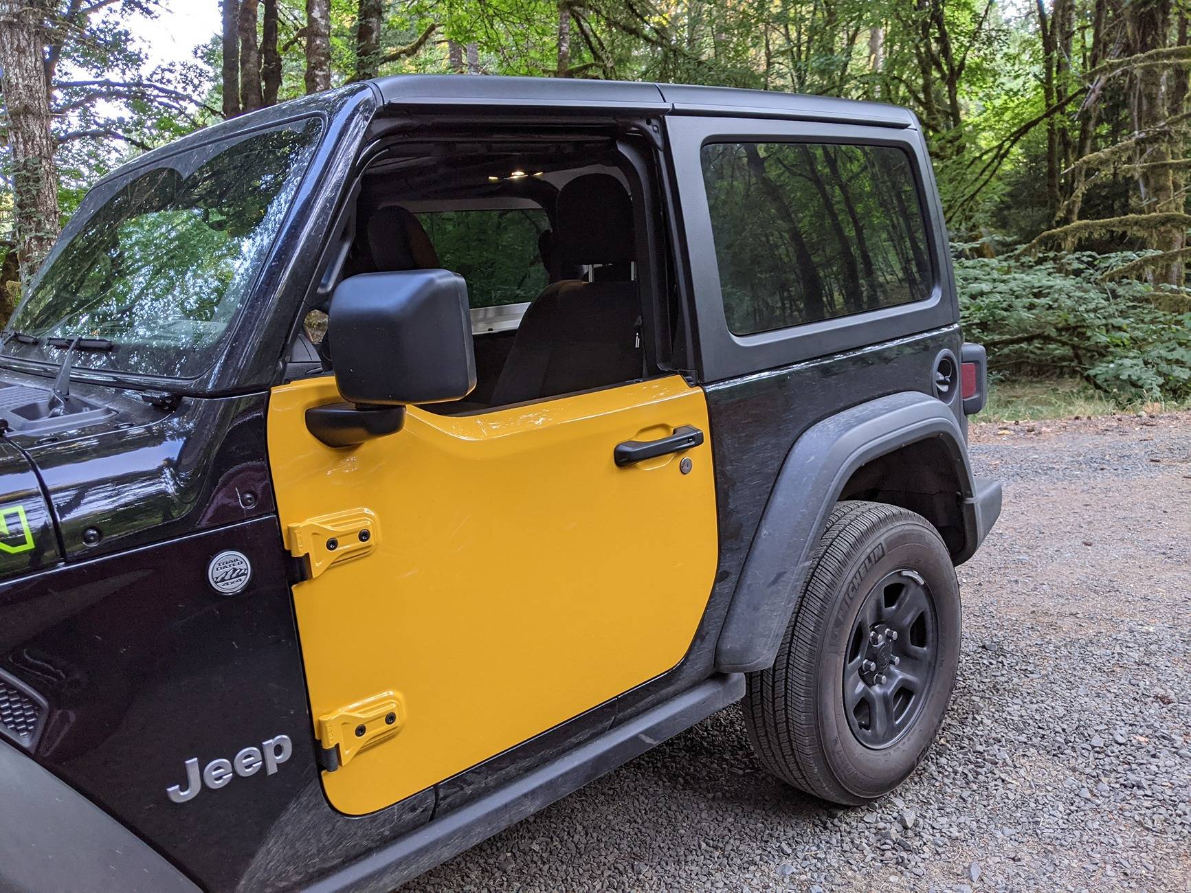

Check out out, we're opposites...

How did you manage to find a yellow pair
Hah, just random find on FB marketplace. Someone with a yellow 2-door JL didn't want em. This was a few years ago.
