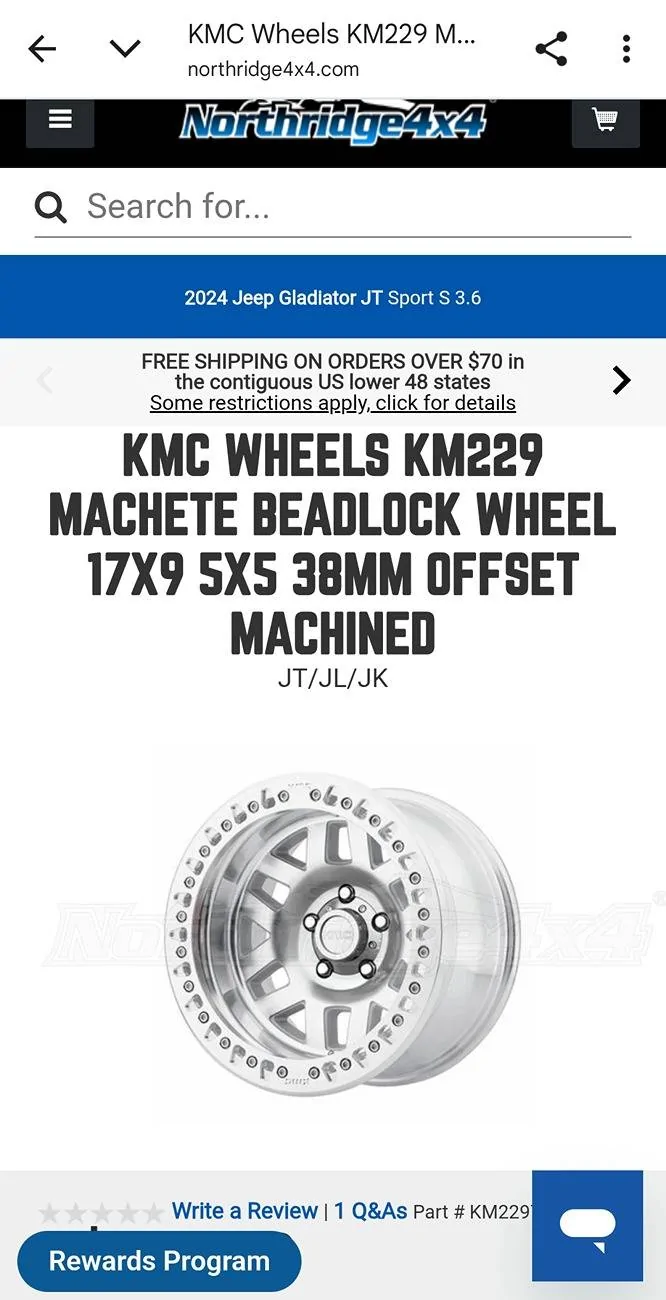

Anybody have any input on brand of beadlock rims? Was looking at raceline..any thoughts...quality issues etc

Got 37 toyo Mts on the jeep. Looks so much better! Turns out i need a new front driveshaft the boot is all torn up on factory fron driveshaft. Ordered a new one should be here this week. Ordered beadlock rims. Ordered a set of the apex sway bar end links for quick disconnect.

Rims will be here monday.
