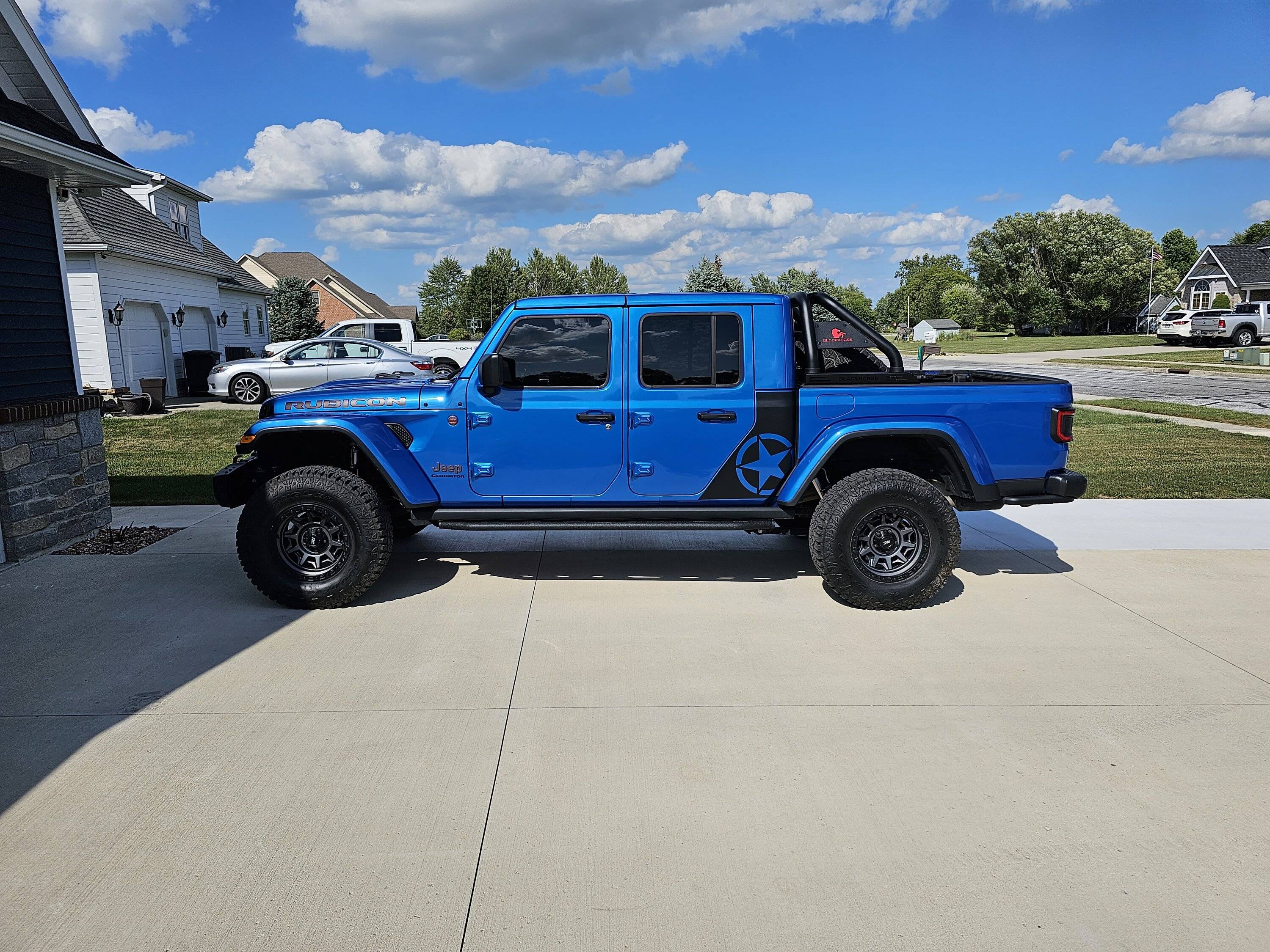

I did the JKS lift w/ lca's & Fox 2.0's w/ stabilizer a few years ago, zero issues. My goal was a general-purpose offroader done correctly if not extravagantly. I also wanted room to go to 37's in the future.
No hardcore wheeling, but plenty of low-speed putzing around in baja. Running 35" baja boss m/t's D-rated, significant difference in performance/braking but still works fine with 4:10's. I see 8th regularly on the flats. A little over 50k miles & doing great.
Completely satisfied w/this setup, glad I didn't go with a cheaper option. Hope this helps!
