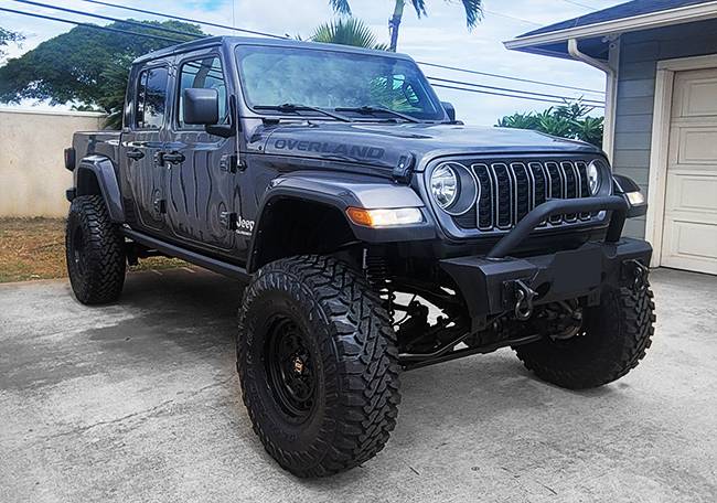

I have a 5" lift on 37's and I'm running some of those components from that RC lift kit:
  • RC front control arm drop brackets
  • RC adjustable trackbars f/r
  • RC shocks f/r
My springs are Rockrawler, not RC. However, I am still running my stock control arms and even my stock drive shafts and it drives good, not great, but pretty damn good! I'm installing the Synergy sector shaft/trackbar brace this week just for some added stiffness, we'll see how it goes.
But honestly, I've been driving lifted vehicles since the early 80's and from my experience, having some play in the steering is inevitable on any lifted vehicle.

Like everyone else has said. You need a bunch of parts. What no one has said. You also need geo brackets too to help to level out you front control arms.
