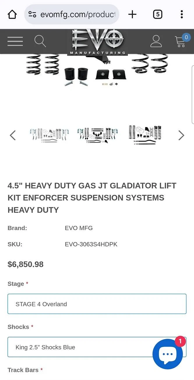

Decided on this kit will order next week! Any tips on install

Tips:
A 4 post lift (really is nice LOL)
Read the instructions and then again.
Make sure you have all tools in your sight!!! Not just "I have that" and then spend hours looking for it.
More jacks and jack stands than you realize.
2 buddies to help.
An ughadugga wrench.
Ice cold beverage of choice for the end of the day accomplishment.
Get it aligned ASAP.

A 4.5" lift with sport fenders on 37's will give you a ton of room in the wheel well.
I have a 3.5" clayton with 37s and there is room for 38's with no issues.

I wish i had a 4 post lift. Will be doing to with 8 jackstands a floor jack and alot of determination. I put long arm carli kits on dodge cummins all the time. So hoping this will be ok lol and everything is new less than 800 miles on the gladiator so hopefully bolts arent a pain in the ass to take apart
