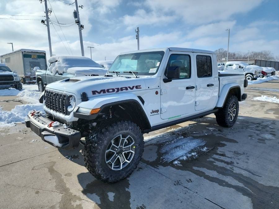

**Checks sticker and sees dealer is already giving $3K off without blinking on a $10K option package**
Looks like the trick will be to wait until December to buy a Mojave X at 15-20% off MSRP just like the '23's.
It looks like you nailed this one, Nostradamus. Care to share the Powerball numbers?!
