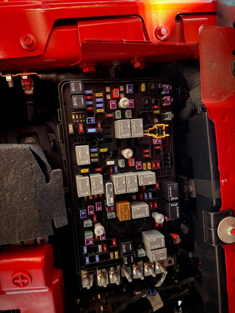

I went to Walmart this past weekend and bought an Everlast AGM Platinum H7 battery and replaced the main battery, the Aux battery, I had replaced back in December 2024. There were absolutely no problems with installing it and the battery size was exactly the same as the Mopar battery. The felt cover went on perfectly. Most importantly, got in Gladiator and she started right up, without any hesitation. I went out late in the morning and made three trips throughout the day. There were no issues whatsoever. I couldn’t be happier. Thank you and everyone who chimed in on the issue. All the help and suggestions are most appreciated!

Yes, indeed. A 3/8” ratchet, 10 mm socket, 13 mm socket, good lighting, new battery and a cup of coffee; on a Saturday morning. Not much easier than that. Thanks your help. Most appreciated.
