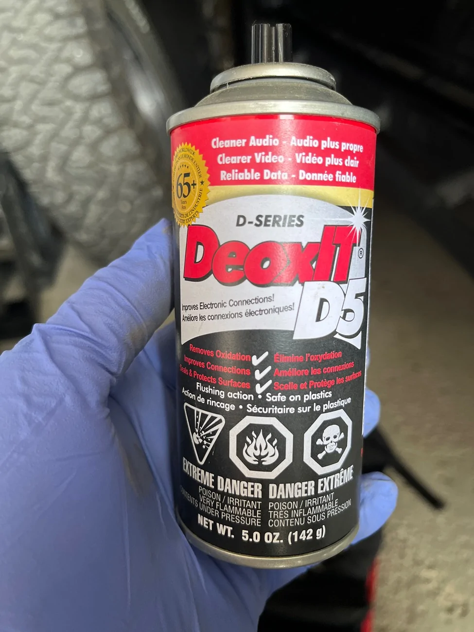

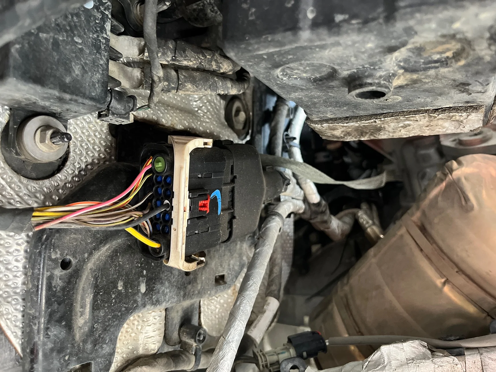

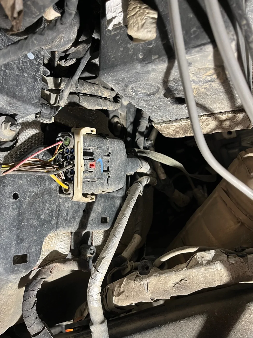

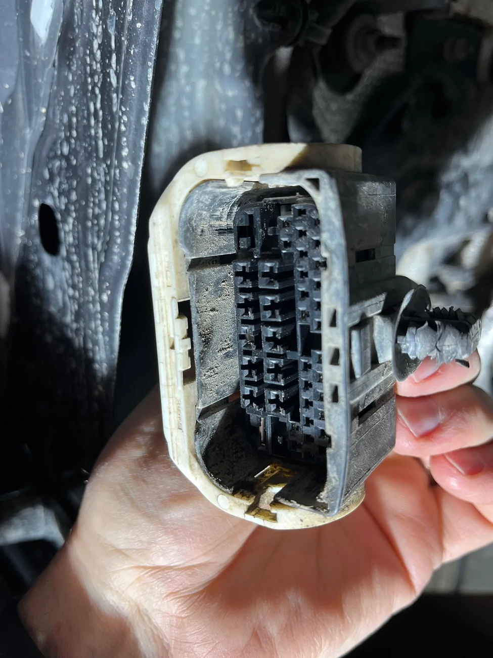

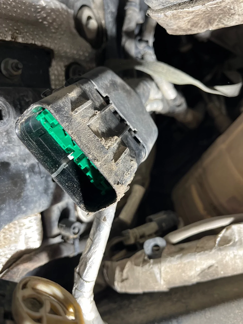

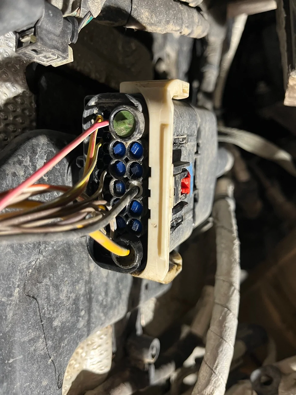

The connector behind the passenger front wheel liner and below the aux battery is the TCM (transmission control module) susceptible to all kinds of exterior conditions. This connector gets very dirty and IF there’s an issue with the seal where the connector mattes together or water ingress at the ends where wires go in at out, corrosion sets in on those pins and the things your experiencing could be a corroded pin.
I never had a problem with this connector but I had water forded a couple times before and I knew that connector was under water/mud so my separating the connector was to just give it a good cleaning and to make sure the seal was in its proper place, then spray both DeoxIT D5 (first) then followed by a light mist of DeoxIT Sn5 (for salt, moisture and other exterior contaminants). I put a light film of dielectric grease on the matting seal and I was done.
This was preventative maintenance and I did that with all those big ass connectors.
That's nasty.
When I take any of mine apart, they get cleaned and a good dose of dielectric. Any connector, no matter what or where.
No way water or dirt can get in then, and it is a good lube making assembly and disassembly a lot easier in the future.
