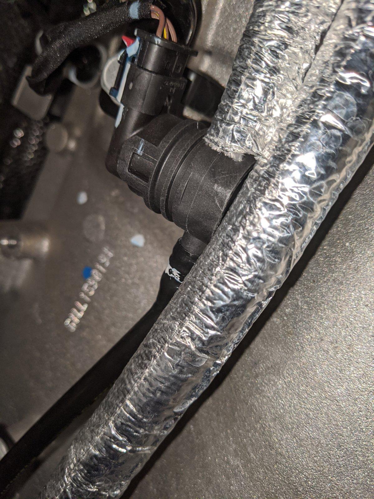

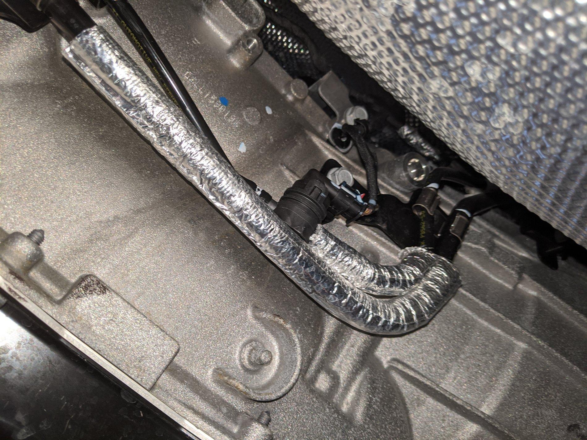

Sounds like you definitely kinked a fuel line. It’s great that you straightened it but you should still have it checked. Once that plastic is linked, it could become a weak point and kink again causing you the same issue. As you hit a log, don’t expect warranty sympathy.
mad far as the A/C controls, I have no idea unless you knocked a ground loose and fixed it when you reconnected the batteries.
