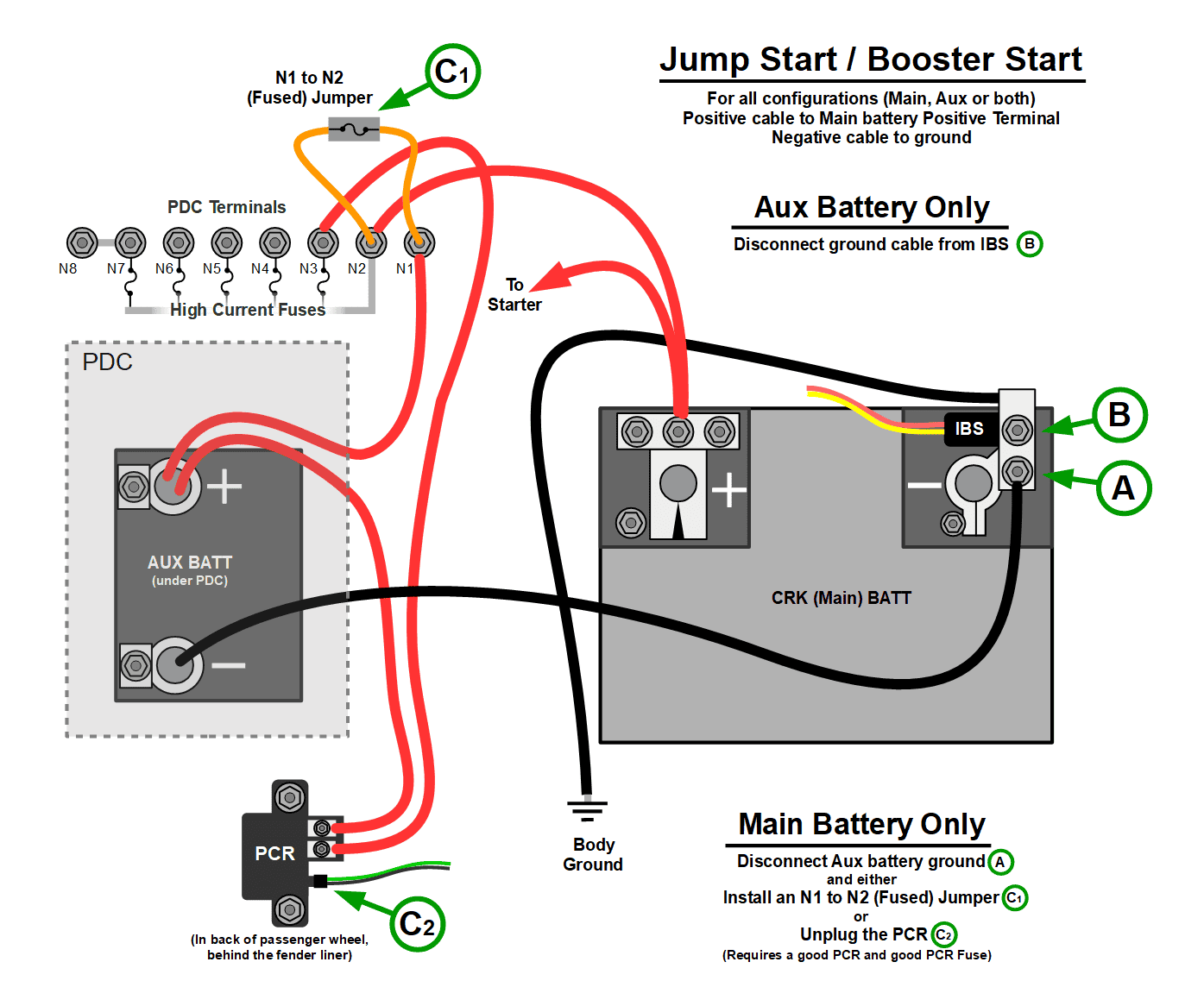

only hope, disconnect both neg terminals. connect a good battery inline with 1 of the neg cables. charge to full.. then do the same with the second battery.. 3rd charge both neg terminals seperate to full charge.. either 1 or both batteries will not take charge and dissipate rapidly.. best way to troubleshoot at home
Jeep Gladiator Puzzled Truck Won't Start underhood-jumper-3a-
