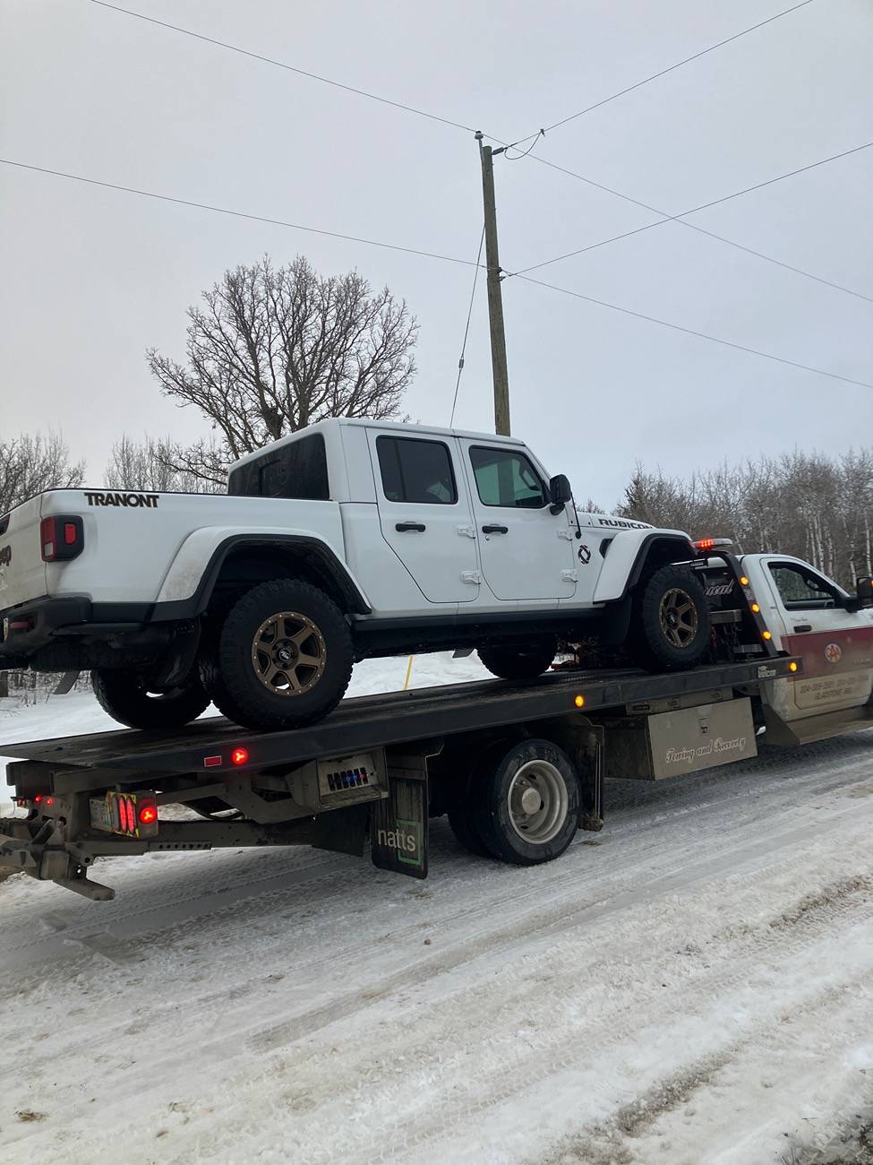

Jeep Gladiator Diesel won't start- bad batteries or bad starter? IMG_4853
And….she’s off. Hopefully back soon.
What an ordeal to deal with the roadside assistance. I got the states version and we had a lot of trouble to find addresses and even the VIN number. Said I would have to pay the full tow of 900 then try get reimbursed!
She finally realized I was in Canada after telling her my address five times.
Called the Canadian one and in about an hour the tow truck was on its way.
Will update with what the dealer says. He suspects an injector tip broke off and leaked fuel. He said they’ve had a few 3.0 in rams do that.
