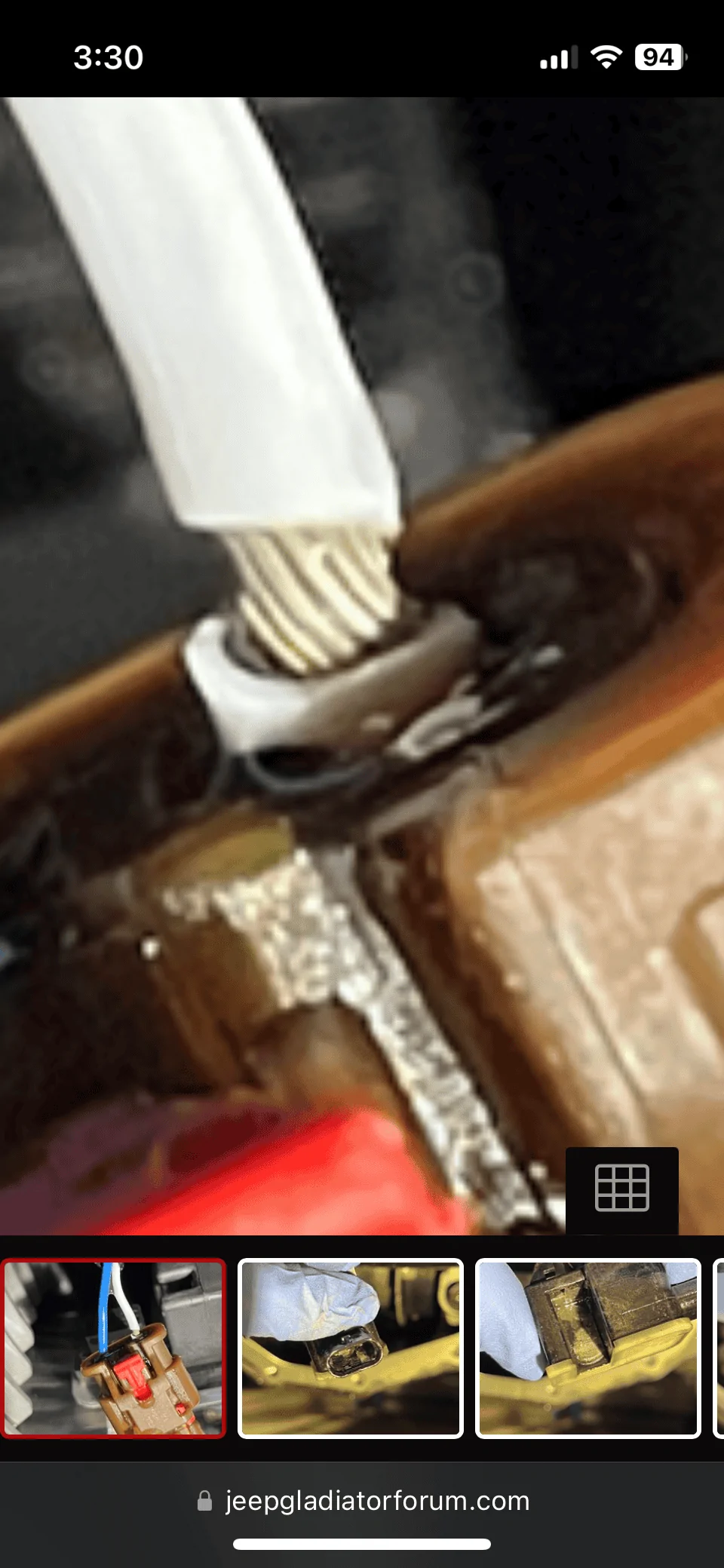

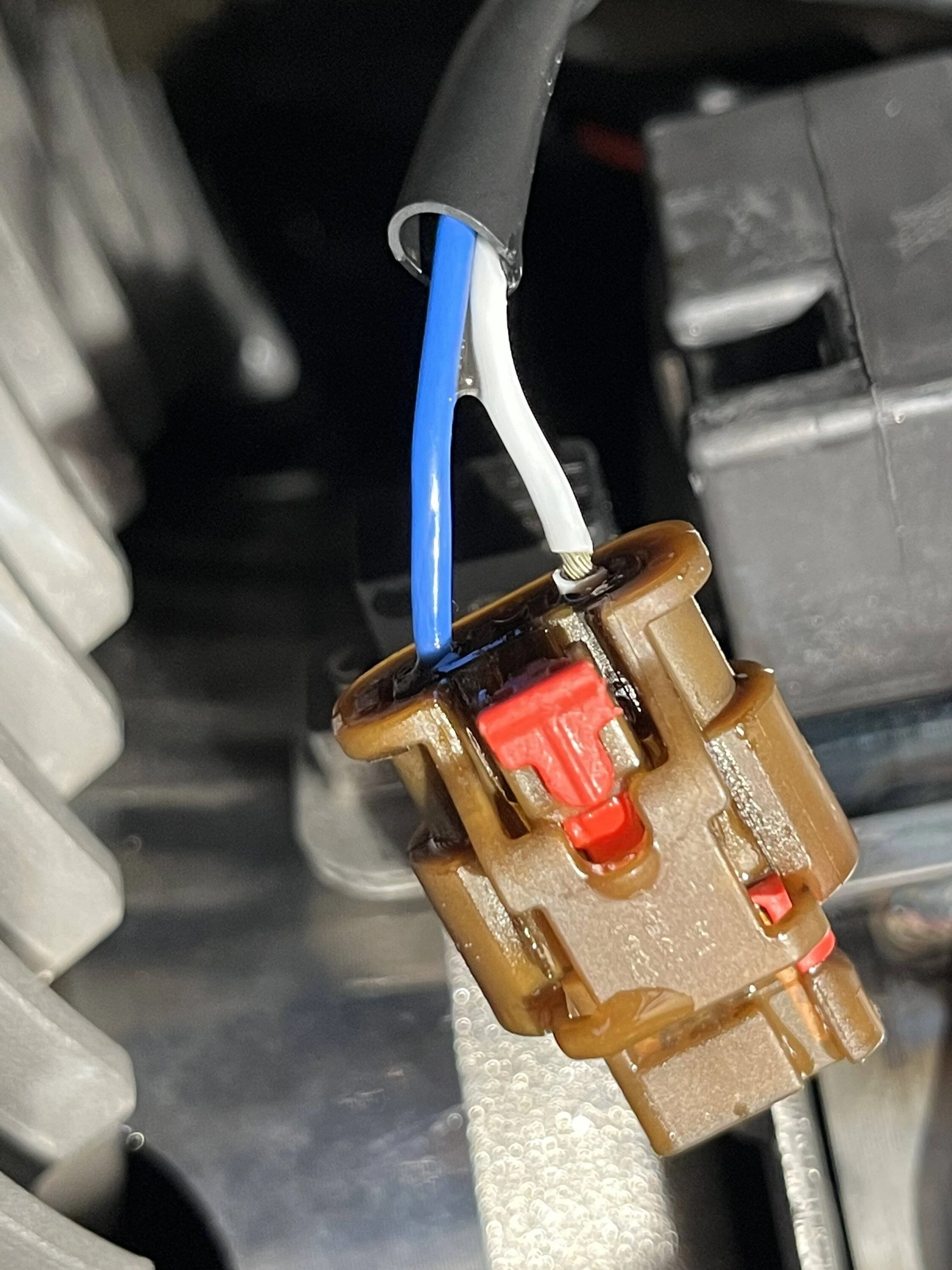

I potted both sensors today and I found a slice in the white connector wire for the rear locker. The locker worked prior to the potting today. Is this a problem?
Well, since you potted the sensors, that wont be an additional oil pathway into the sensor.
If thats a ground, no worries for sure. I doubt if its a positive, that it has enough voltage to ground through the metal in used gear oil.
Proper way to fix would to de-pin it and heatshrink over. I can't reall drum up a scenario where thats going to be a failure though.
Hopefully someone else has insight.

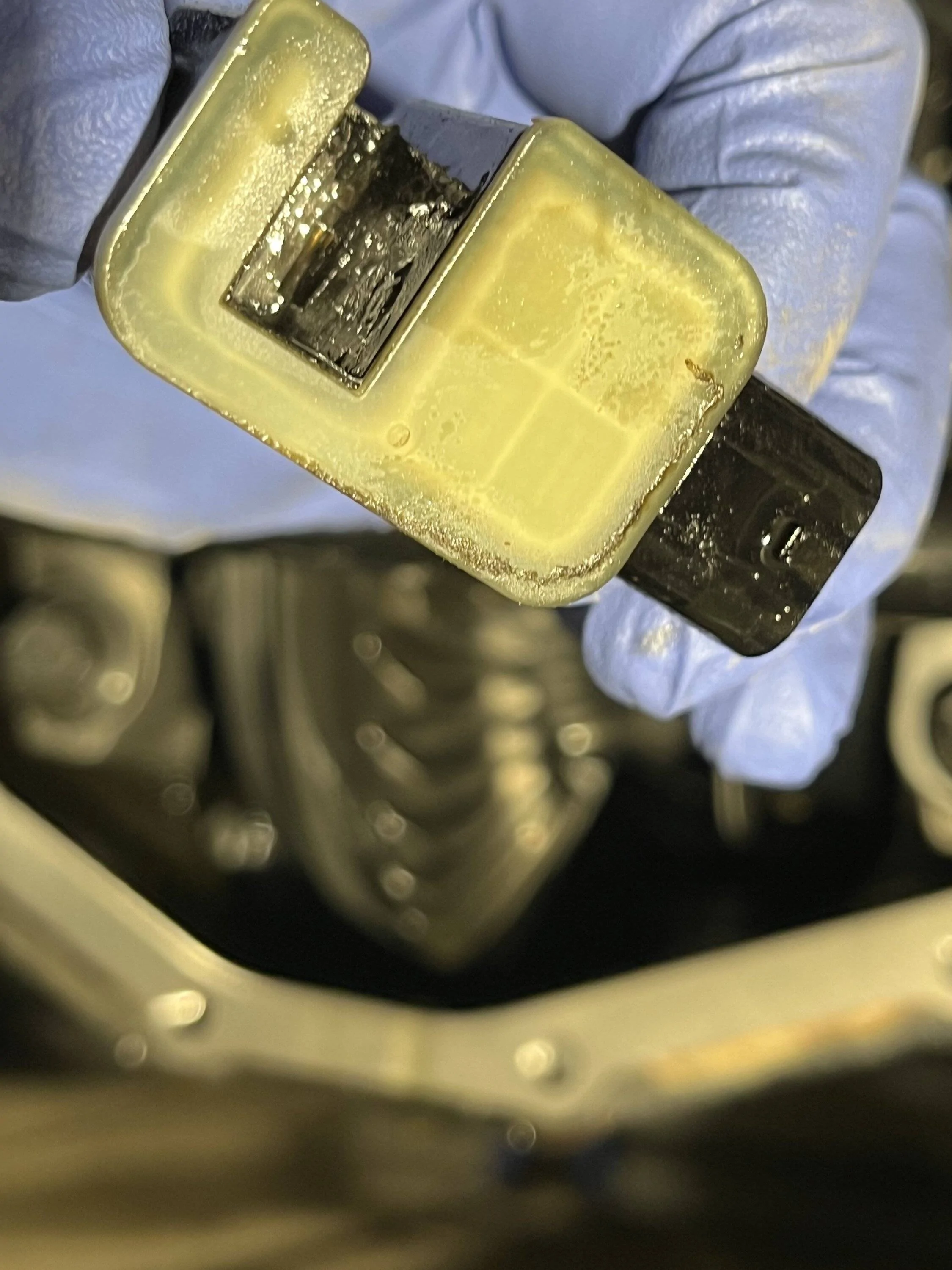

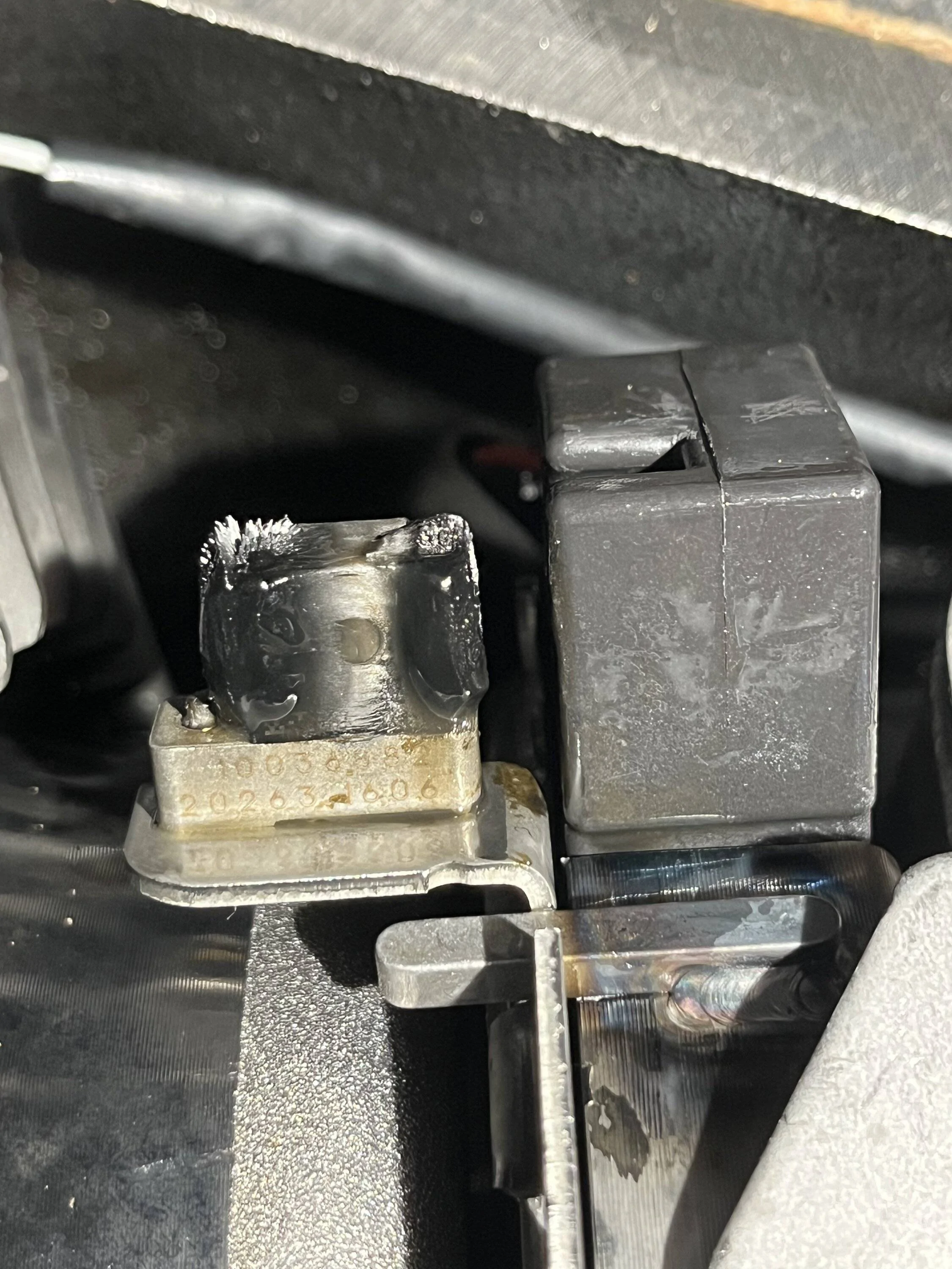

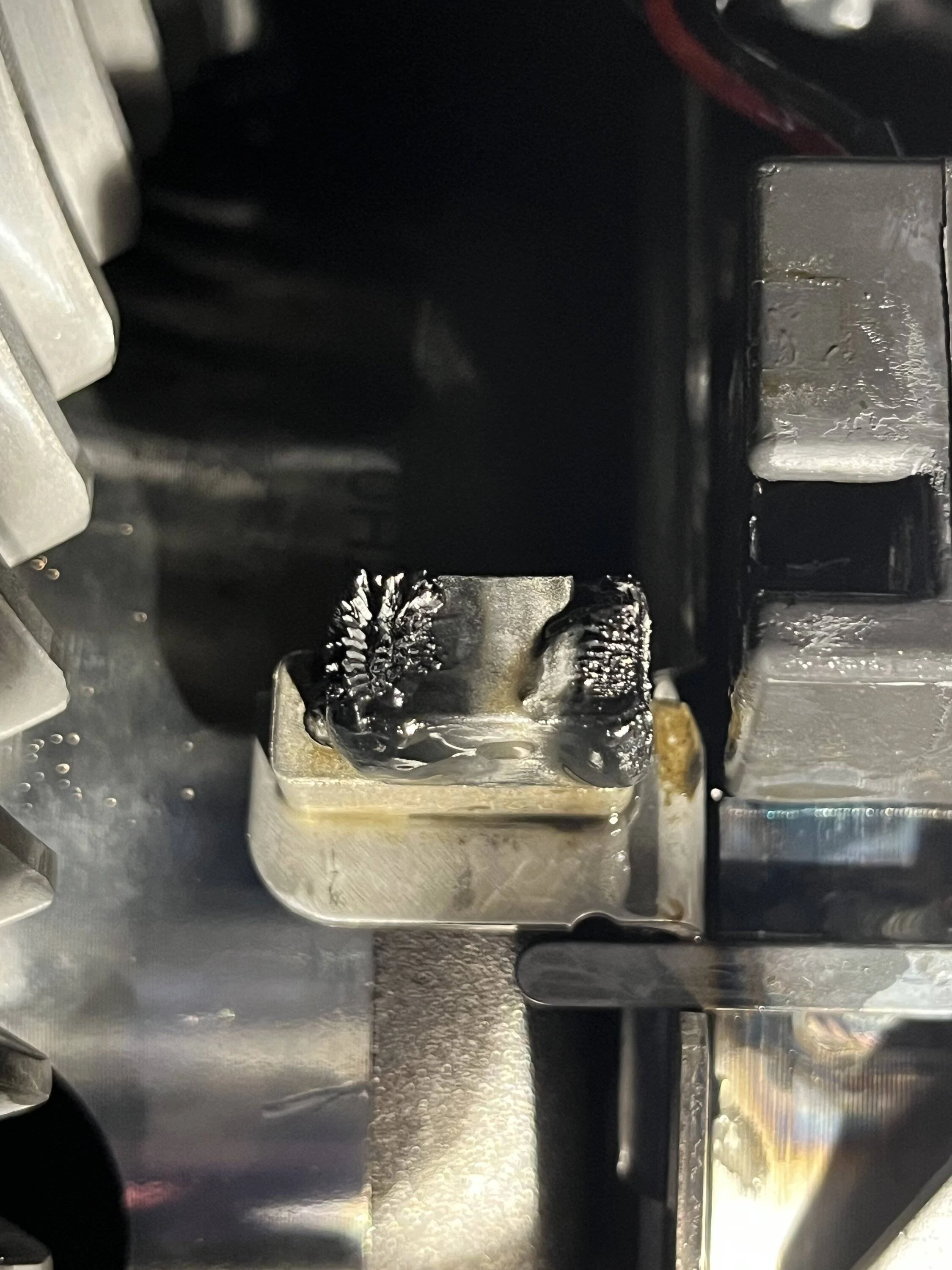

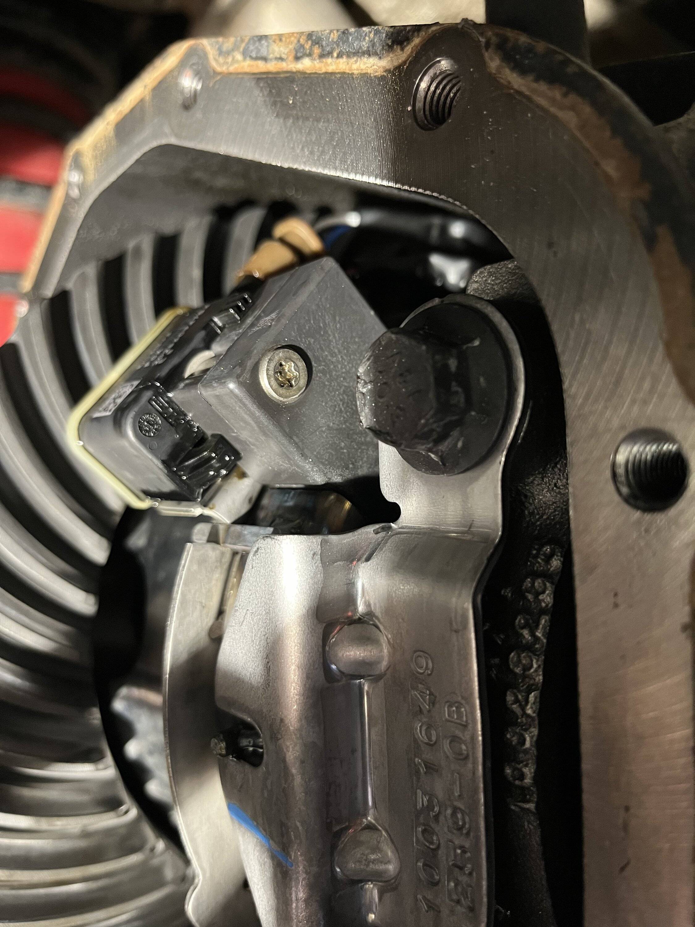

My experience with doing this exercise was very good. Thanks to all those that gave examples and photos. It was good to pull the diff covers, clean out the inside and spray it down with brake cleaner and inspect gears.
Sensors were good so that was a bonus. The removal of the sensorwas easy with just taking out the single torx screw.
The rear magnet had a good amount of filings and sludge on it.
I waited the 24 hours for the potting material to cure then put it all back together and went out for a drive and tested the lockers. WOW!
So before, when engaging the lockers the locker symbol on the dash would blink up to 10 times before giving steady signal and that would be the same for release. Now, after the job, lockers engage and release on the second blink, both front and back. The response is immediate!
I didn’t do anything about the split wire casing, it works. If it becomes an issue, I’ll find the replacement wire and swap it out.

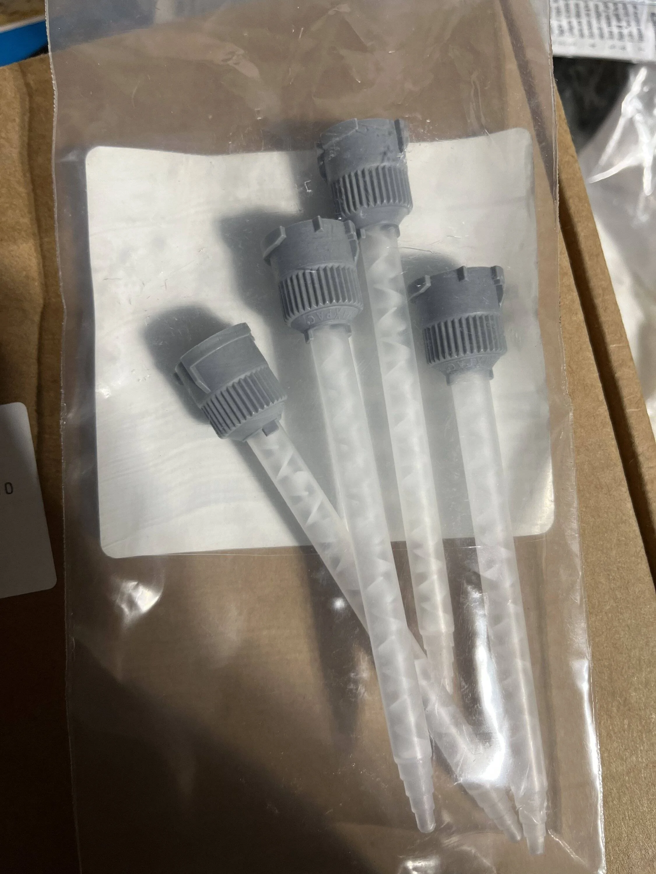

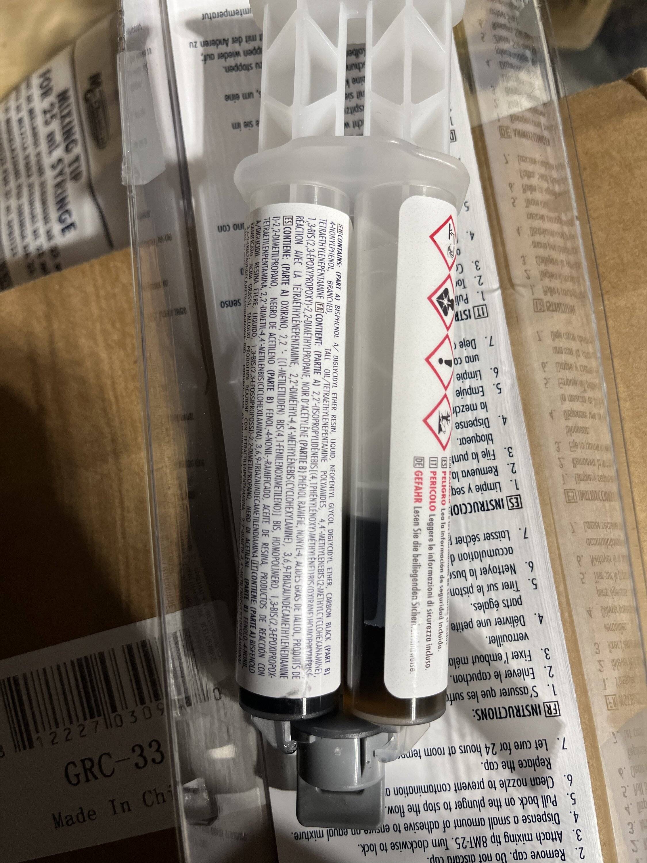

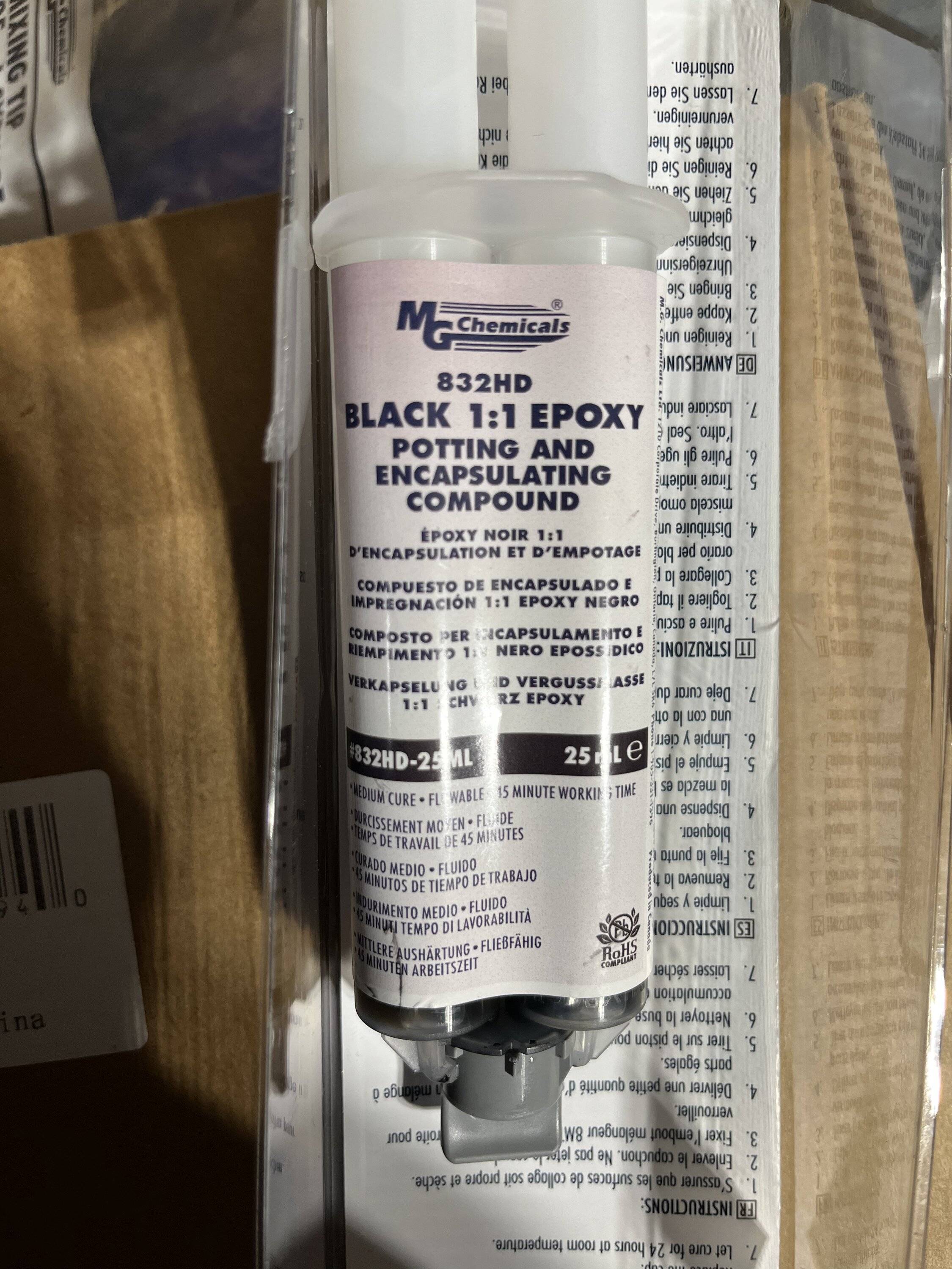

When you refer to " potting material ", what exactly did you use? Based on the amount of metal present on your magnets I will likely remove my covers and clean out the diff. How many miles on the truck? Thanks for the Info.
Maximus Gladius
Jan 30, 2021
75
2,917
3,733
Calgary, AB, Canada
2021 JTR, 2023 JTR
The stuff I used is excellent. (See pics) Got it off Amazon Canada. 25ml is plenty. As you can see, this is what’s left from filling both sensors. Odometer is at 49k kms (30,447 miles)
I should also add to the story that sometimes when I tried engaging the lockers, the symbol would just flash long enough to quit. I’d have to keep trying until it would finally work.
Works like a dream now.
