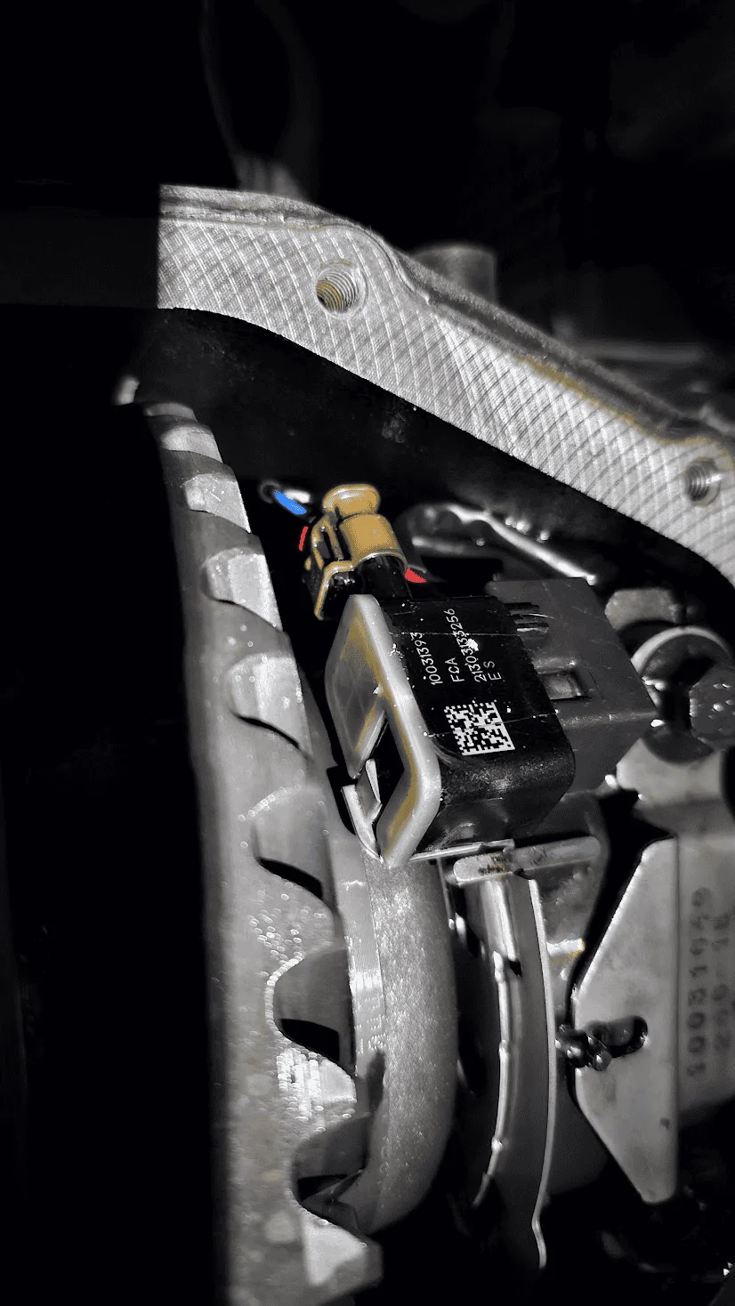

Well... looks like mine will be failing soon (at least the rear one).
Jeep Gladiator Axle Locker Sensor Issue - Repair Kit Fix Released for JT / JL! 1707142678620
Two questions for y'all:
1) If it's not failing yet, but you can see there is some oil in there, is it too late to try and fix it (by potting)?
2) The MOPAR part number in the first post shows what looks like 5 pieces in the kit:
Does it really come with 5 sensors for $300? I can't seem to wrap my head around why there would be 5 - we only have 2 axles... and I can't imagine MOPAR would sell anything that cheap (5 for $300). The picture is confusing to me...​
Thanks!
Thanks!
I had priced one sensor up here in Canada and it was just over $500 cad for one. This ad warrants contacting Mopar on line and asking.
I have read a while back in the JL forums that if the sensor hasn’t failed, drilling those small holes and spraying in the circuit board cleaner, drying it out and potting wouldn’t hurt it. If you’re super careful with the drilling part, the cleaner won’t hurt it.
@AllMoparParts.com Can you confirm what's included in this "kit?" Thanks!
I'm gonna guess it's just one, but why the picture of 5 with numbers on them?

My rear locker started the blinking light problem. I order the Z Auto bypass cable and it's been working with no issues. Had ARB air lockers in my TJ and they didn't tell you they were locked either. You'll know if it isn't locked lol
if it’s not failing yet then there’s still hope to save it. It’s worth a shot if you want to keep things OEM (and not use that z bypass cable).
it’s super easy to do. I did mine a while back.
Hi Austin,
5 are included but only 1 is used and is dependent and unique per each application. I have attached the service info for additional context.
- Benny

Hi Austin,
- Benny
Interesting... so it's trial and error until you find the right one :)
