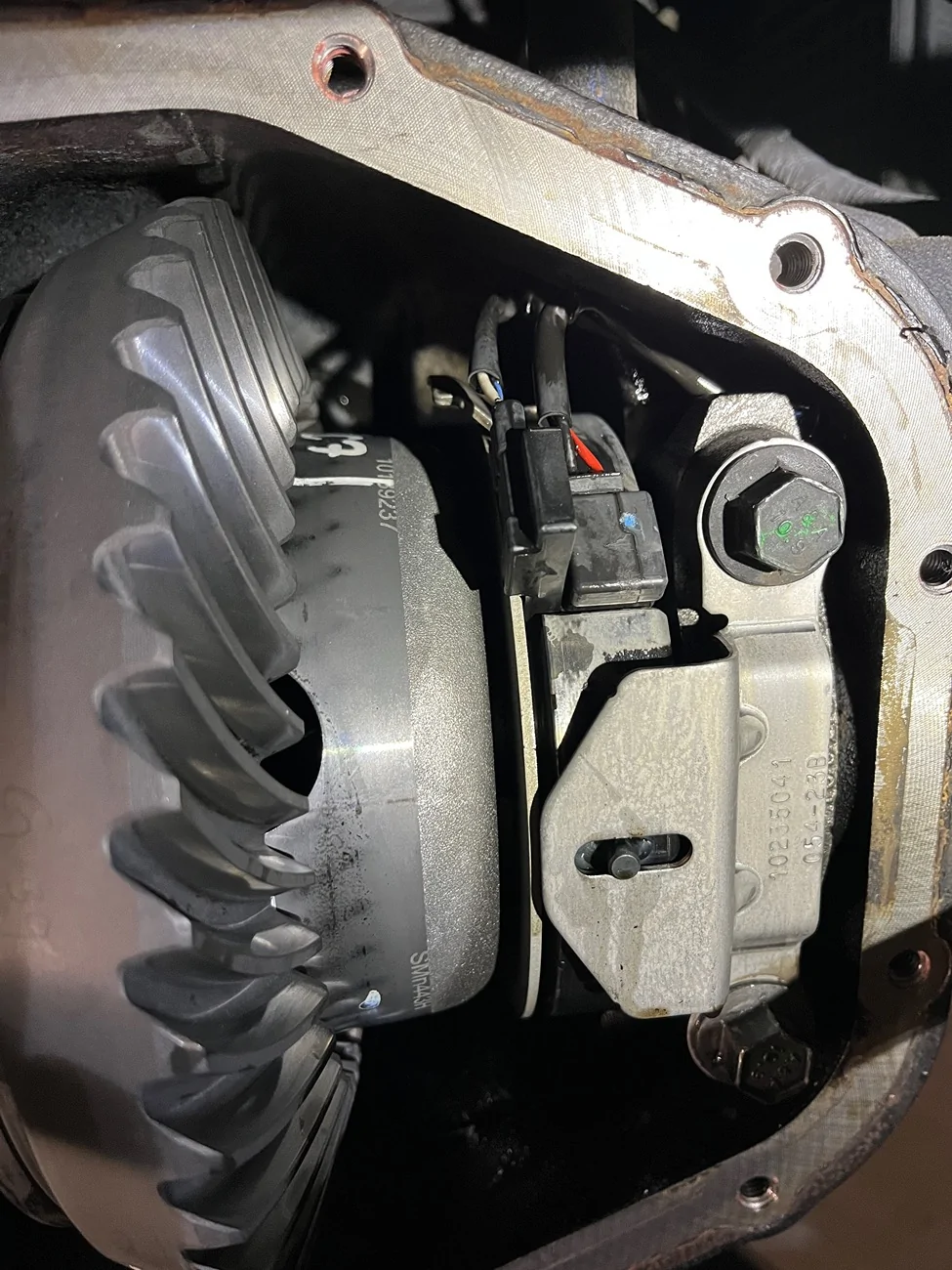

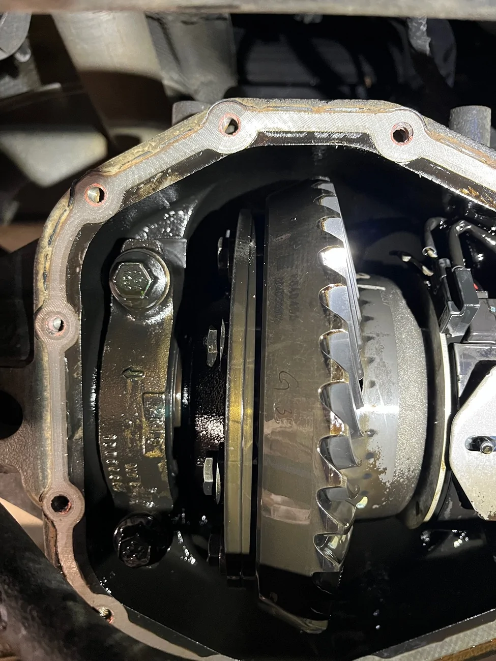

I just got my 23 JTR with 25k kms/15k miles, no drain plug and my first order of maintenance was to change all fluids and run a sample of each to the lab.
The previous owner only changed the engine oils 3 times in the 25k km run and no other oils. The lab highlighted 3 problem areas, the iron levels were very high in both diffs (710ppm rear, 416ppm front) and the silicon levels high in the transfer case (179ppm), (caused foaming).
I don’t have the magnetic drain plugs but when I pulled the fill plug, those were magnetic but…they’re up high so not as useful as the low ones. I also had a magnetic drain plug made for the transfer case and put that in.
I pulled both diff covers and oil was dark brown/black, didn’t smell burnt and all the surfaces of everything inside had this dark coating that brake cleaner made short work on to strip off and wash out. (See pics)
If I had this from new, the oil would have been dropped a hell of a lot sooner and the lab wouldn’t have highlighted anything.
Diff covers went back on and slapped on earth magnets to the bottom of the covers. Going to order a couple strong pull fishing magnets to replace the earth magnets.
