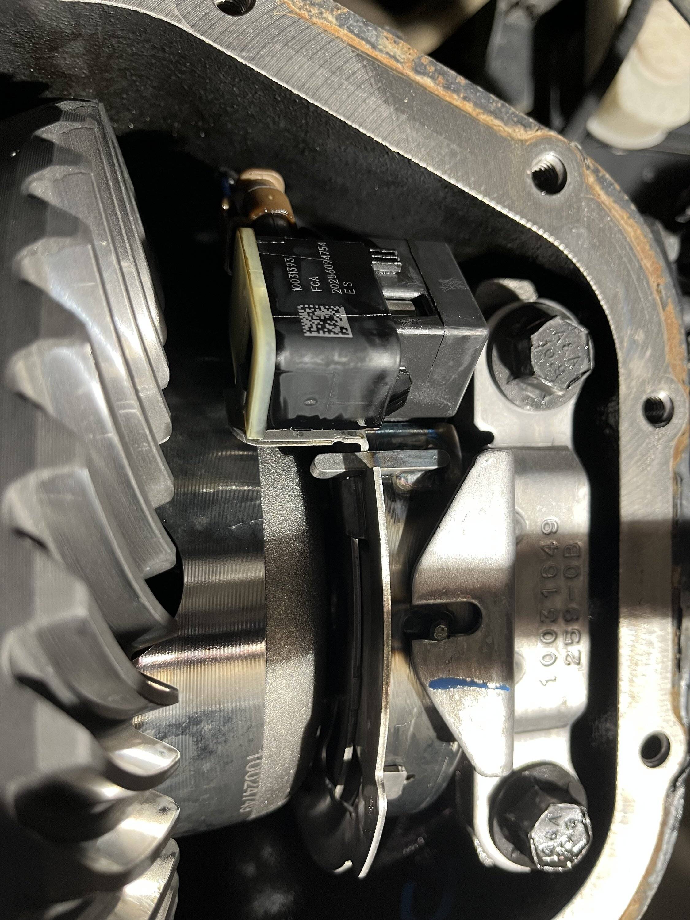

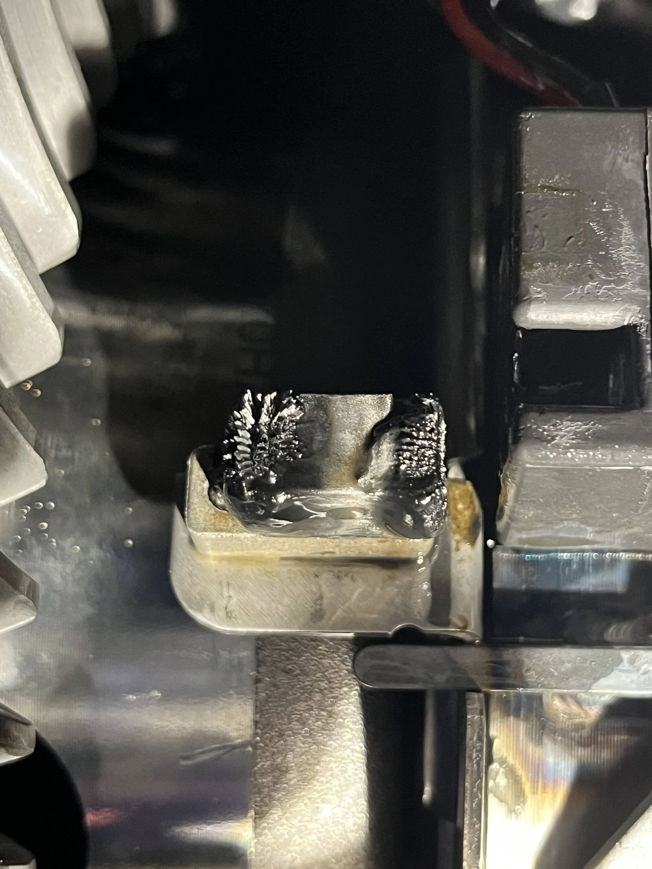

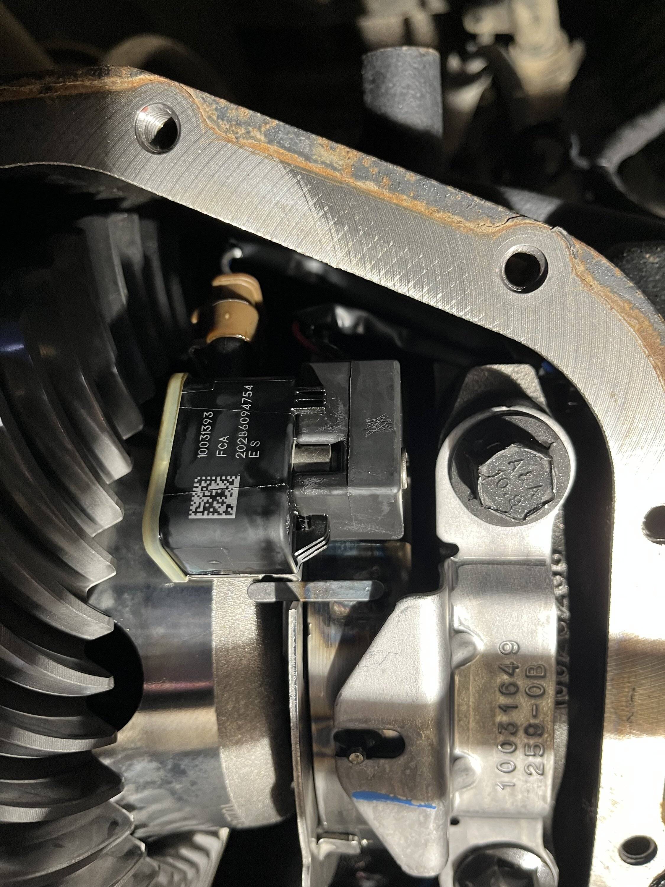

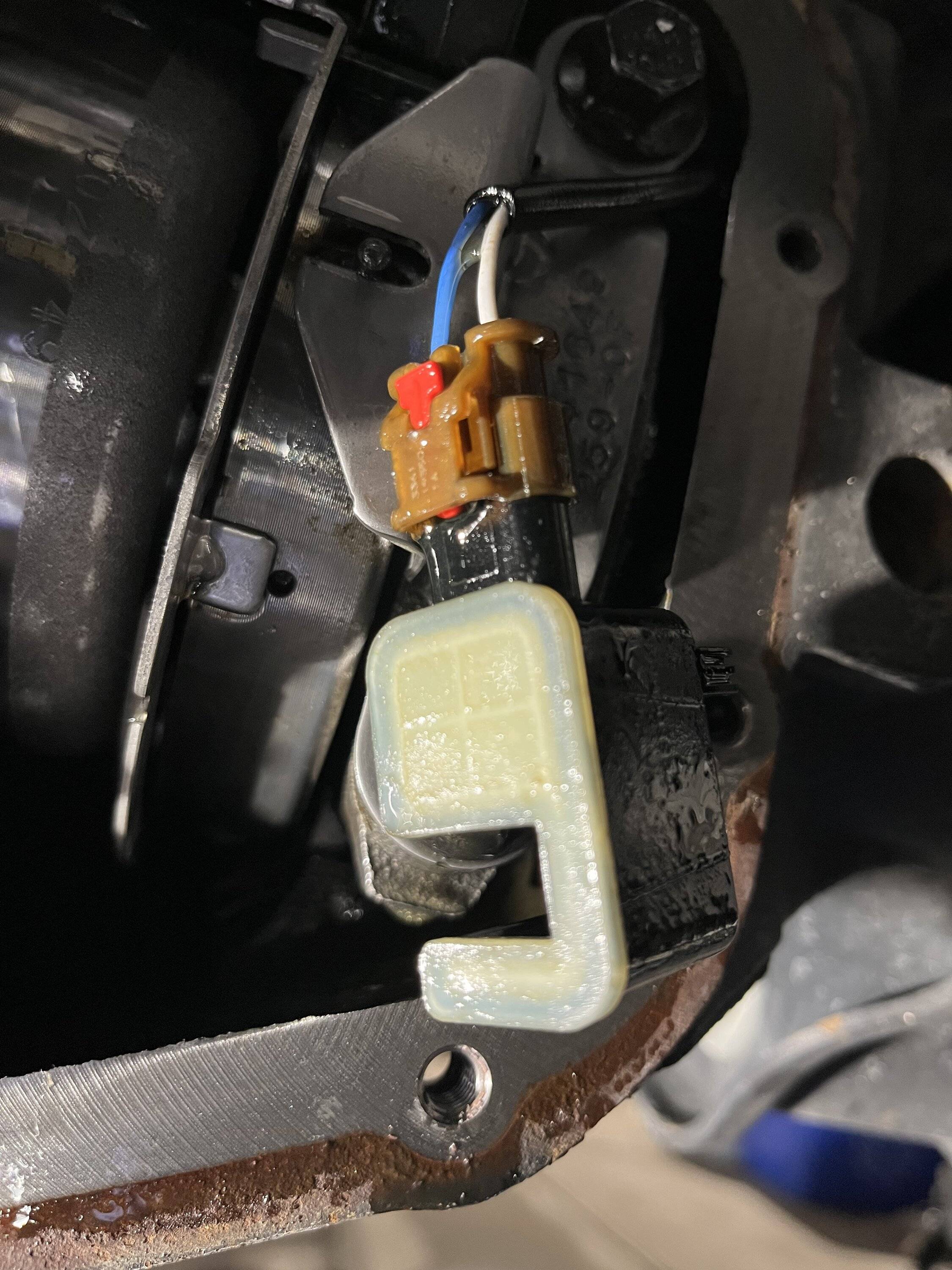

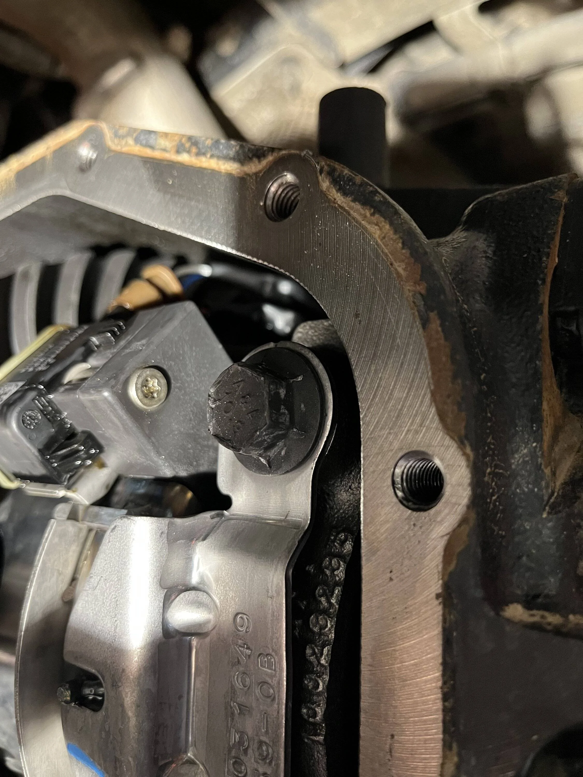

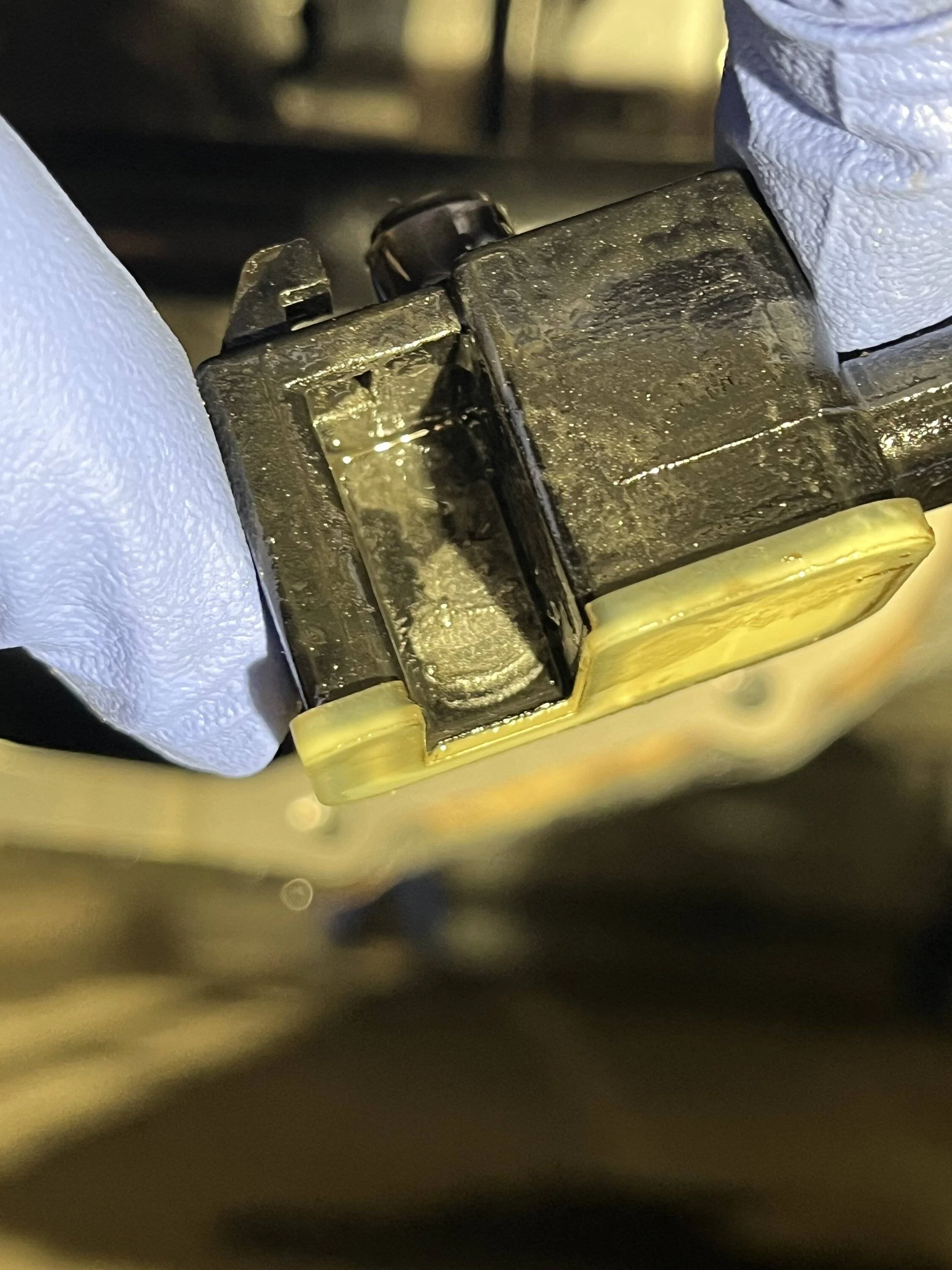

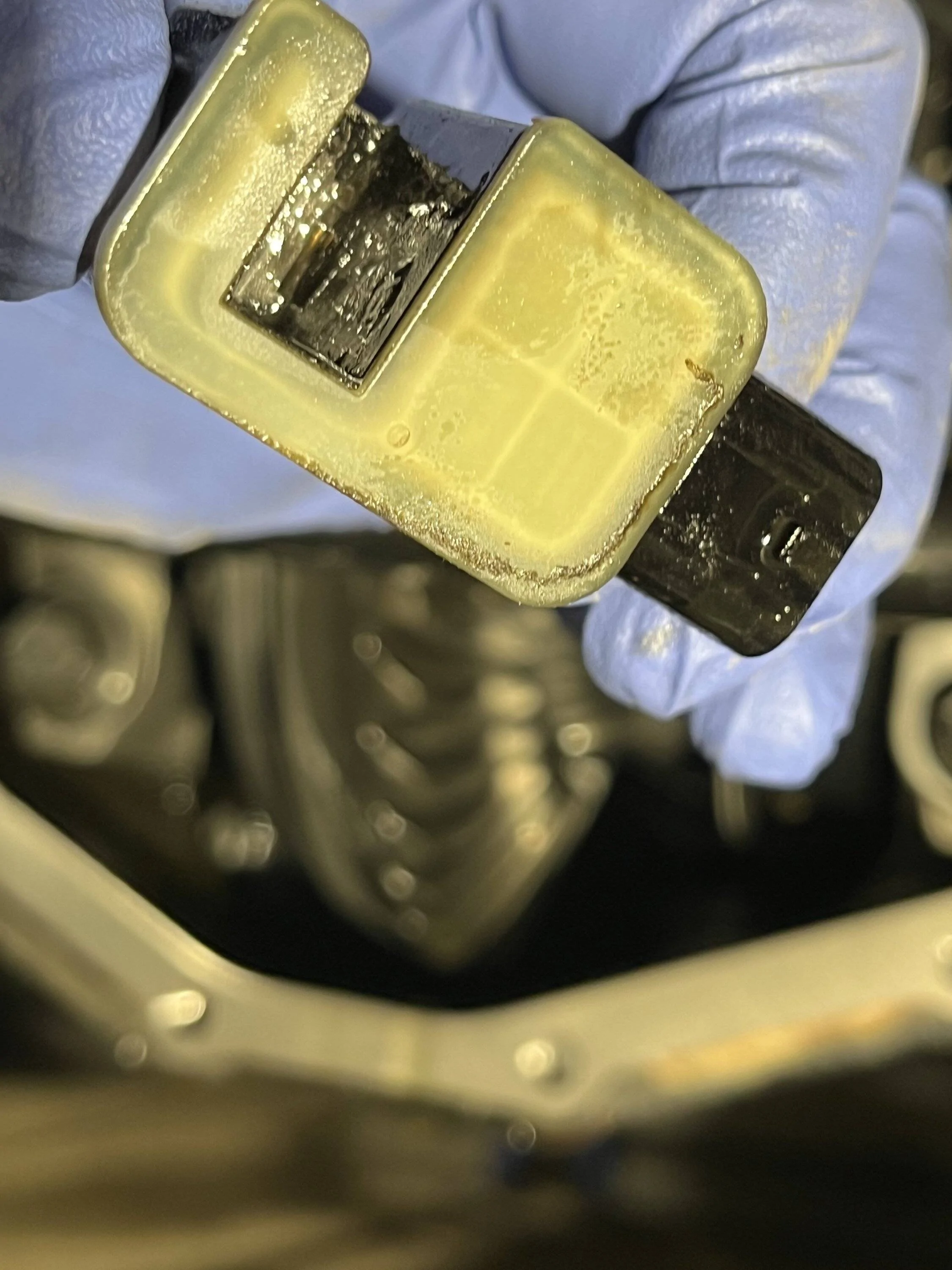

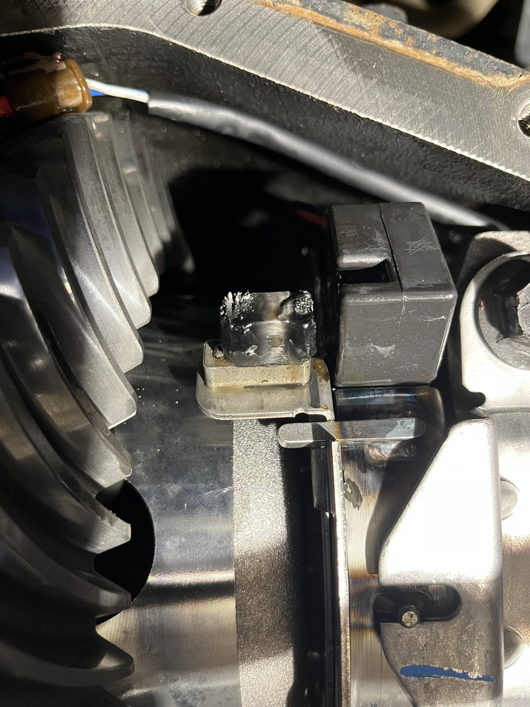

I’m going to say, if locker engagement and disengagement and the flashing locker dash light is a problem, the first culprit is going to be a plugged up locker sensor magnet that’s coated with metal filings. The only way to correct it is to just get after it.
Pull off the diff covers (rear or both depending what you have), do a nice clean of the internals, undue the locker sensor, (there’s one Torx screw holding it in place over the magnet) and clean off the magnet.
This is a great time to check the sensor to see if oil has breached the sensor. You will easily see oil inside of it if it has and if so, the sensor has shorted out.
If it has and you have warranty, you are now at a cross roads of either fixing it yourself and buying that sensor (approximately $300) and replacing it OR put it all back together and tell the service department to inspect the sensor.
If the sensor looks fine and you see no oil inside (and you still have warranty) you’re at another crossroads. Do I “pot” the sensor and take the chance of voiding that warranty or don’t pot it and just leave it alone. “Potting” it will guarantee that no oil will ever breach the sensor and short out but the sensor magnet will always attract the metal filings and will need cleaning when locker engagement and disengagement becomes an issue again.
Many of us and JL owners have potted their sensors and there’s plenty of detailed “how too’s” here and on the JL site.
When the locker works perfect, the dash light will flash 3 times and it will engage or disengage that fast.
Yeah I’ve read the threads. I’m sure it is a bad sensor and I’ll either get the bypass or get the new replacement sensor. Can I assume that the locker is actually not engaged? I think all the symptoms I’ve read are the locker lights flash and you have a warning on the dash. This eventually will turn into a code or codes and an actual “service locker message”. I have not seen where someone has a solid locker light.
Jaxmax
Jack
Jun 28, 2020
54
2,856
4,637
Bally, Pa.
Electrical Manager
As Kevin above states above it was reported a long time ago by others that it goes through stages if you keep driving with the occasional locker light flashing after a while it stays on more, then the system detects a problem with rear locker and when you get the service locker code your locker won't work. I had it at 90 miles a couple years ago and cause I have a company truck, I parked the Mojave until it came in ( couple days) and it has been trouble free since with about 35,000 miles now. I have an excellent dealer who agrees with me that the Z bypass is a good idea, and has no problem replacing my sensor under warranty whenever I want , but I'm not sure I ever will, it works you know it all the indicator lights work, my only concern is the Z wiring is pretty thin, but I did tape it all up so might just not worry about it....Jack
Maximus Gladius
Jan 30, 2021
74
2,901
3,692
Calgary, AB, Canada
2021 JTR, 2023 JTR
Would I be correct to say the Z bypass doesn’t care if the sensor magnet is full of filings? The wire bypasses the whole sensor and magnet and that just becomes redundant?
Jaxmax
Jack
Jun 28, 2020
54
2,856
4,637
Bally, Pa.
Electrical Manager
BINGO my friend!!!!
Really when you think about it if you need a sensor to confirm that your lockers are locked after you pushed the button and the light came on...perhaps you should not have a locker, Ha.....Jack
