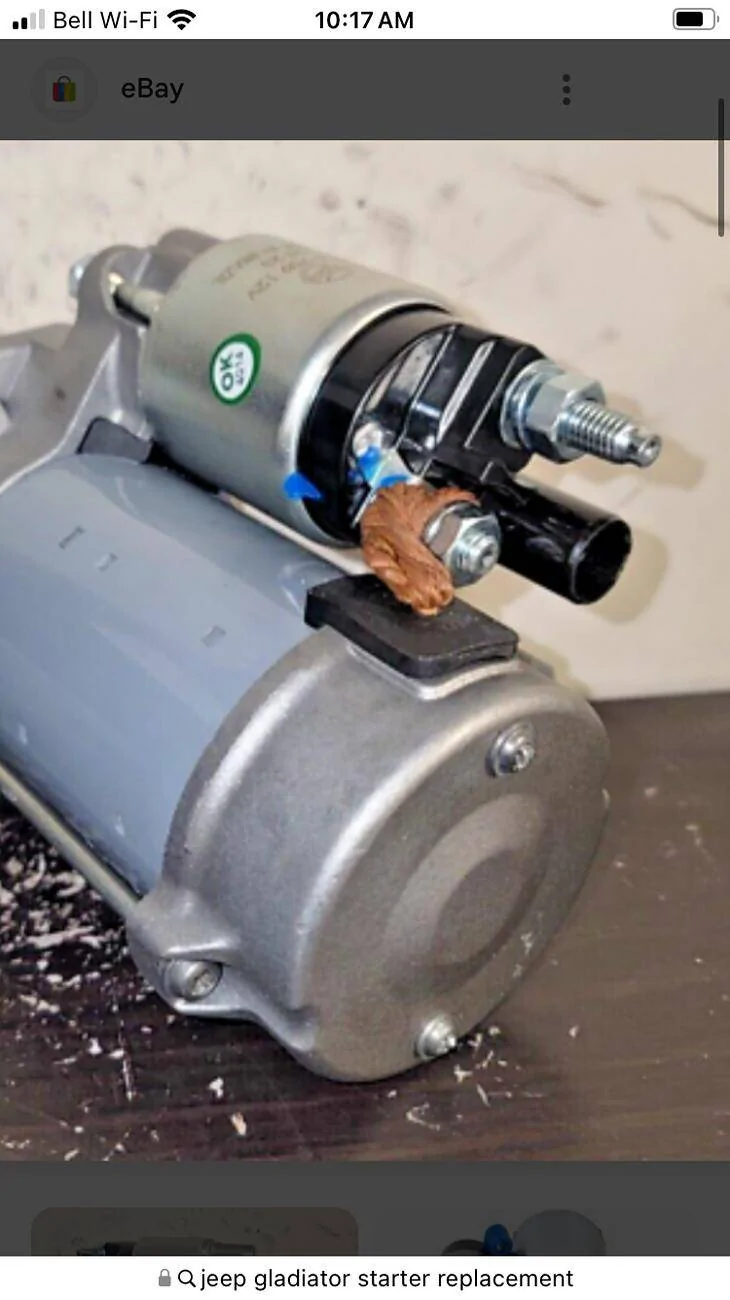

Another small update. I went to the dealer and paid my diagnostic bill. 213 bucks.
I went outside with my tools and turned over the motor. It turns over both ways no problem. So there is no issue there. Tried starting it quite a few times and all the starter does is click. So it’s either seized or has a dead spot in it. I crawled under and banged on the starter with my breaker bar handle to try the old school tricks, but no go. I’ll be driving by the dealer on my way back from hockey tonight, so for shits and giggles I’ll pull in and try again. But as it is right now, I have a car hauler rented for Saturday morning and I’ll go get it.
As for why I couldn’t turn it over before, the only thing I can come up with is the starter bendix was still engaged in the ring hear and I was rotating it and it put the starter in a different spot. I left it at that and when they had it they just hit the starter butting and it worked? I don’t know. That’s all I got!! Sounds like voodoo when I say it out loud!! 😂

So a final update. Picked up the truck yesterday. 1400 dollars later. Around 800 for the starter, and almost 500 in labour plus taxes. Starts every time!! :LOL:
It definitely starts faster. Like it turns over faster. Either the new batteries or the new starter itself, or a combination of. It also sounds a bit different after it starts. Kinda like the starter is slightly staying engaged a split second longer than it should.
I asked to see the old starter but they said they had sent it back for the core charge already. Although the tech said she bench tested it and the bendix came out, but would not turn at all. Seized solid she said. Would have loved to have kept it and taken it apart to see what happened.
