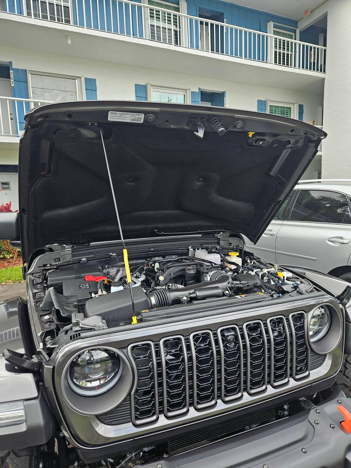

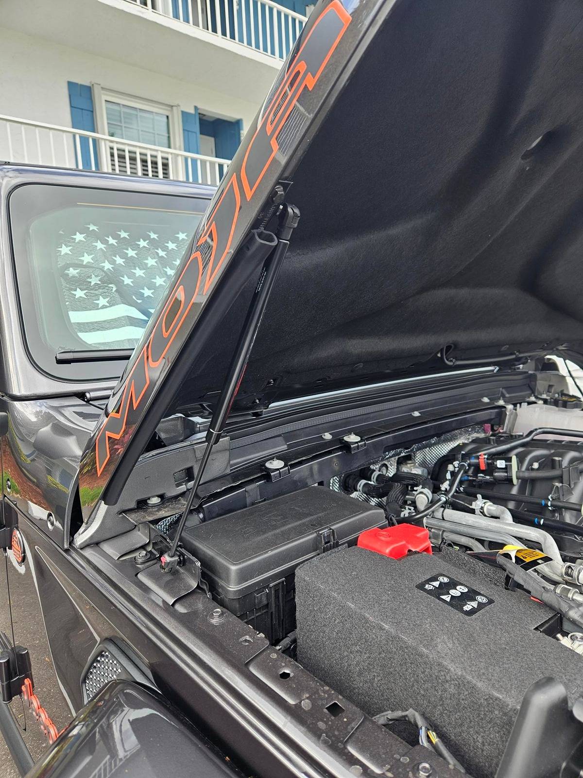

In an effort to get this build journal back on track, I did 2 quick and easy mods today.
1. Hood Stuts. These are specific to the Mojave due to the heavier hood. Red Line Hood Struts
Before
Jeep Gladiator 2024 Mojavicon to be Hood Before
After
Jeep Gladiator 2024 Mojavicon to be Hood Strut 1

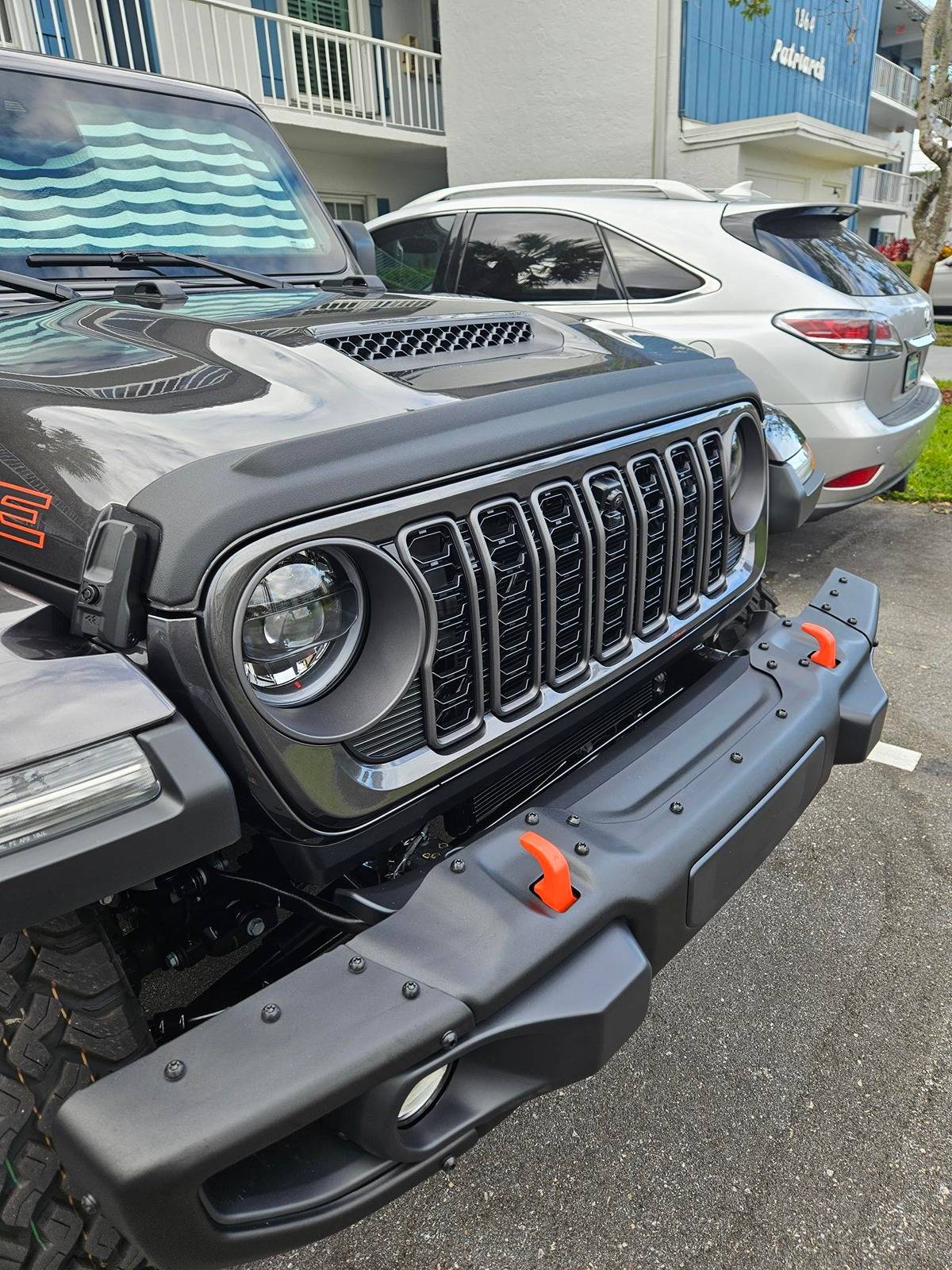

2. Hood Protector / Bug Deflector - Bushwacker
Jeep Gladiator 2024 Mojavicon to be Hood Deflector

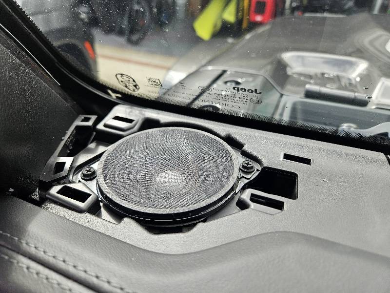

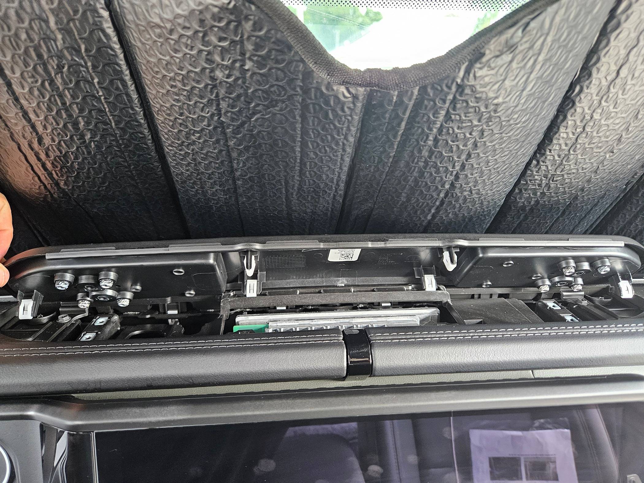

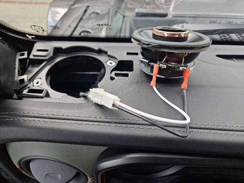

I FINALLY had the chance to install the Infinity Reference speakers in the dash. WOW! Night and day difference. I had to turn down the highs because they were just too bright with where I had it set for the stock speakers. The only downside is that the deficiencies of the soundboard are now even more evident. So, new soundboard speakers and polyfill are on the way! ?
The install wad straight forward and simple.
Jeep Gladiator 2024 Mojavicon to be 20240505_100439
Jeep Gladiator 2024 Mojavicon to be 20240505_101421

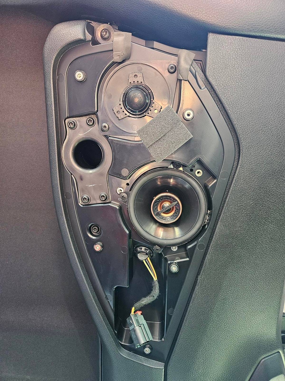

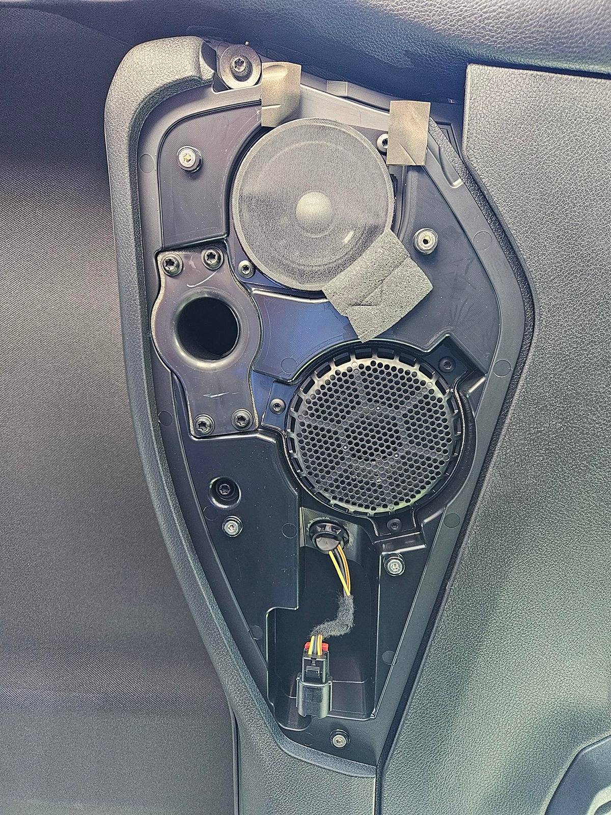

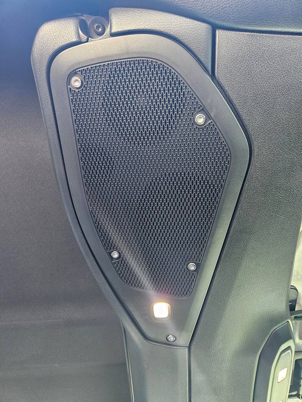

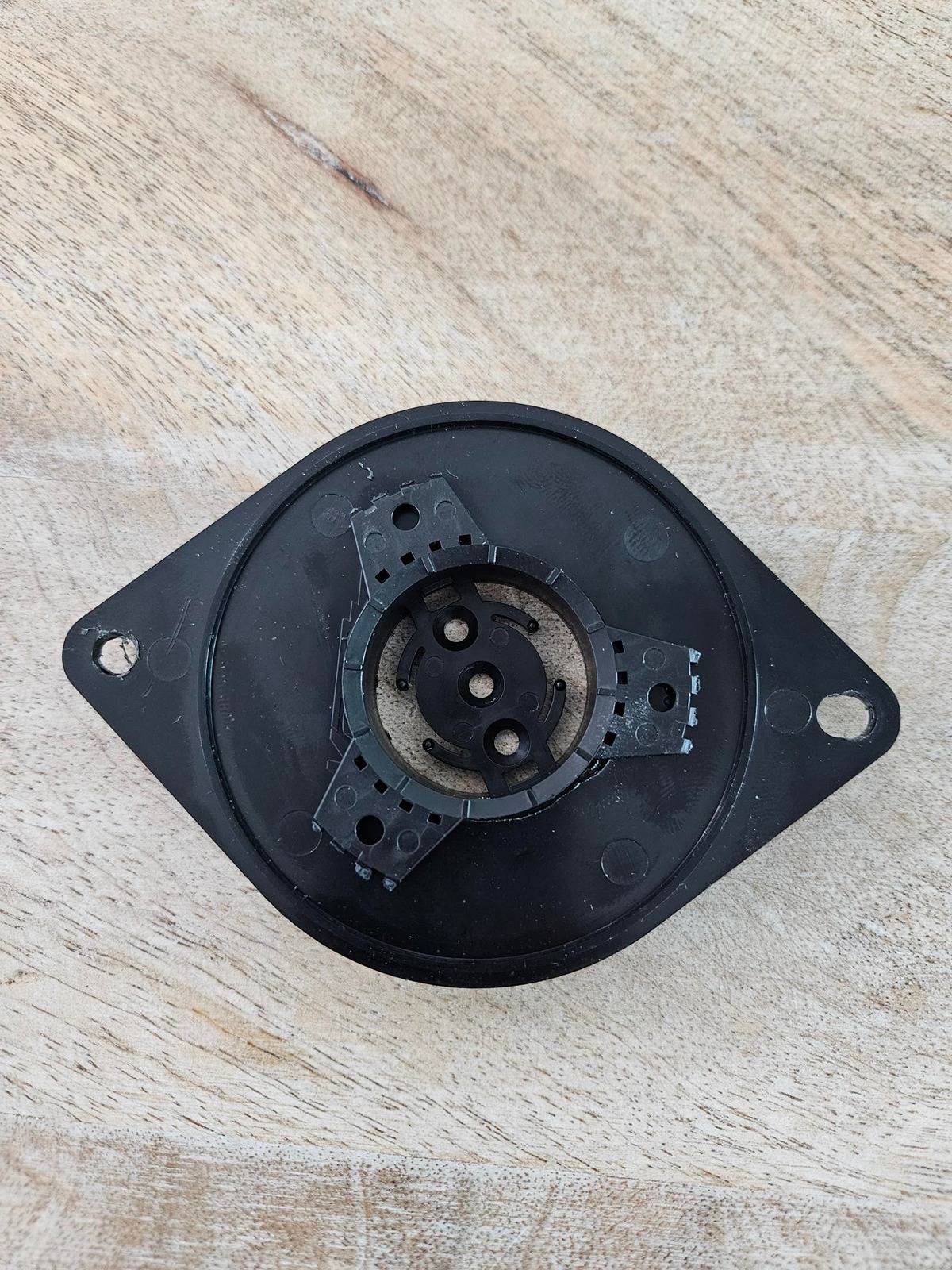

Sound bar speaker upgrade!
The 2024s are different from previous years.
Jeep Gladiator 2024 Mojavicon to be 1000000796
Jeep Gladiator 2024 Mojavicon to be 1000000797

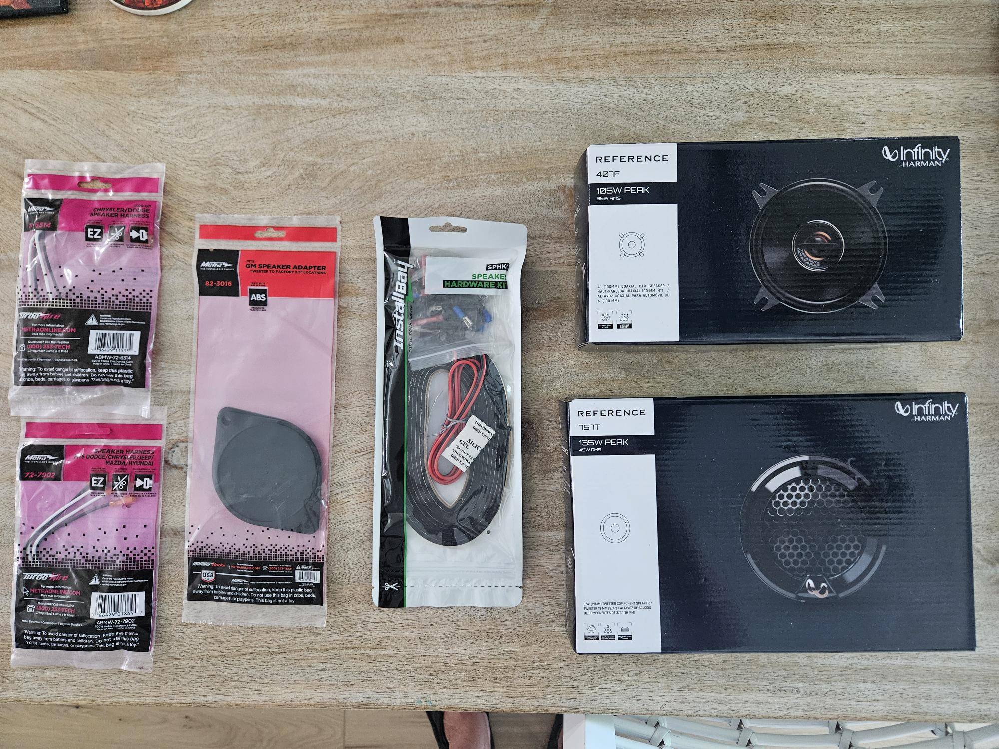

This is what I used.
Jeep Gladiator 2024 Mojavicon to be 1000000800

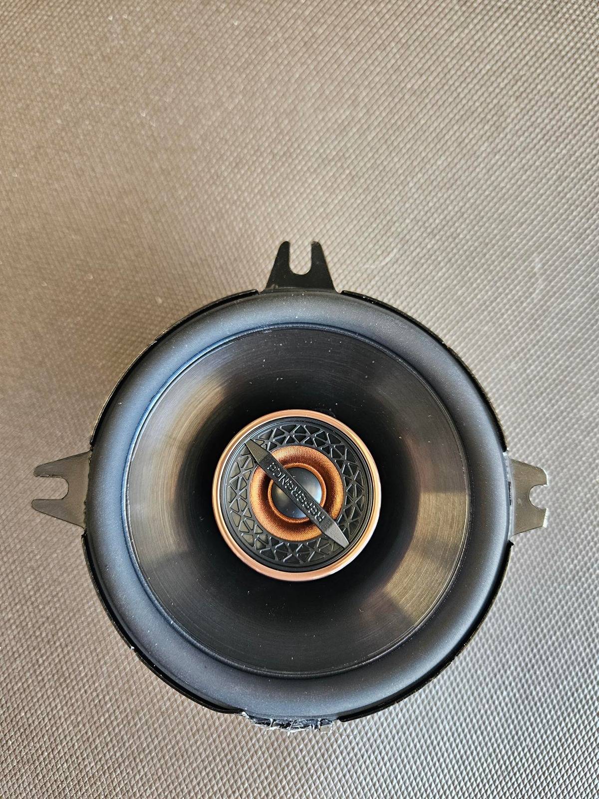

Once the speakers were removed, I installed the 4" coaxial speaker using a Metra plug and play adapter.
I needed to remove one mounting tab, and shorten another one to allow the speaker to fit. None of the holes lined up so I used 3 self-tapping screws.
Jeep Gladiator 2024 Mojavicon to be 1000000803

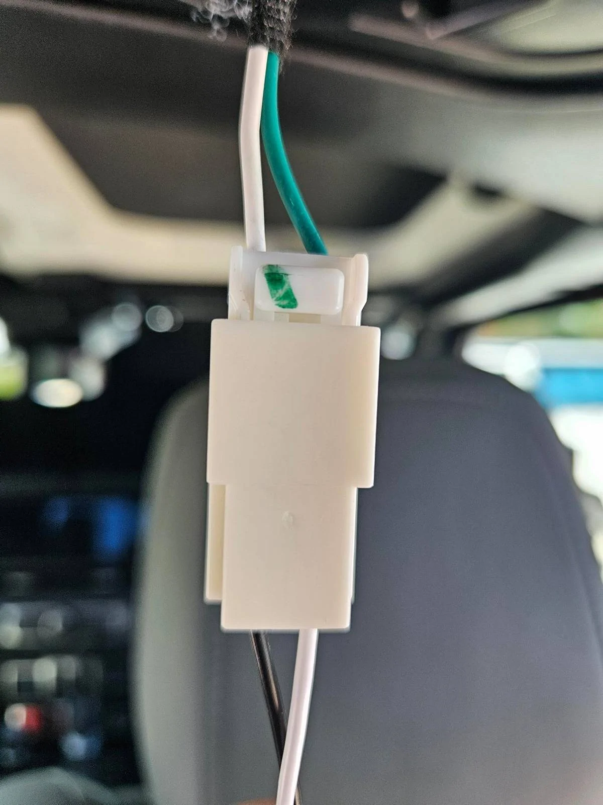

The adapter looked like it had a polarity issue to me. After testing and checking, the polarity is correct.
Jeep Gladiator 2024 Mojavicon to be 1000000804

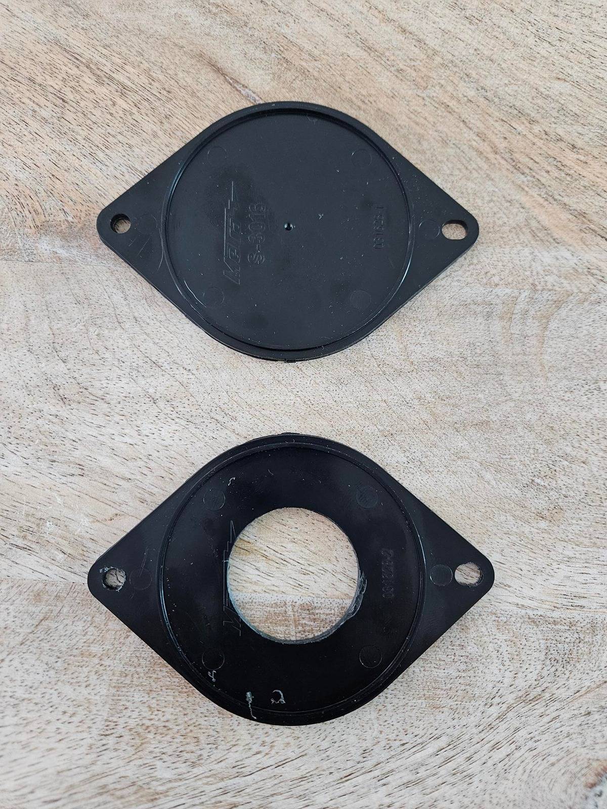

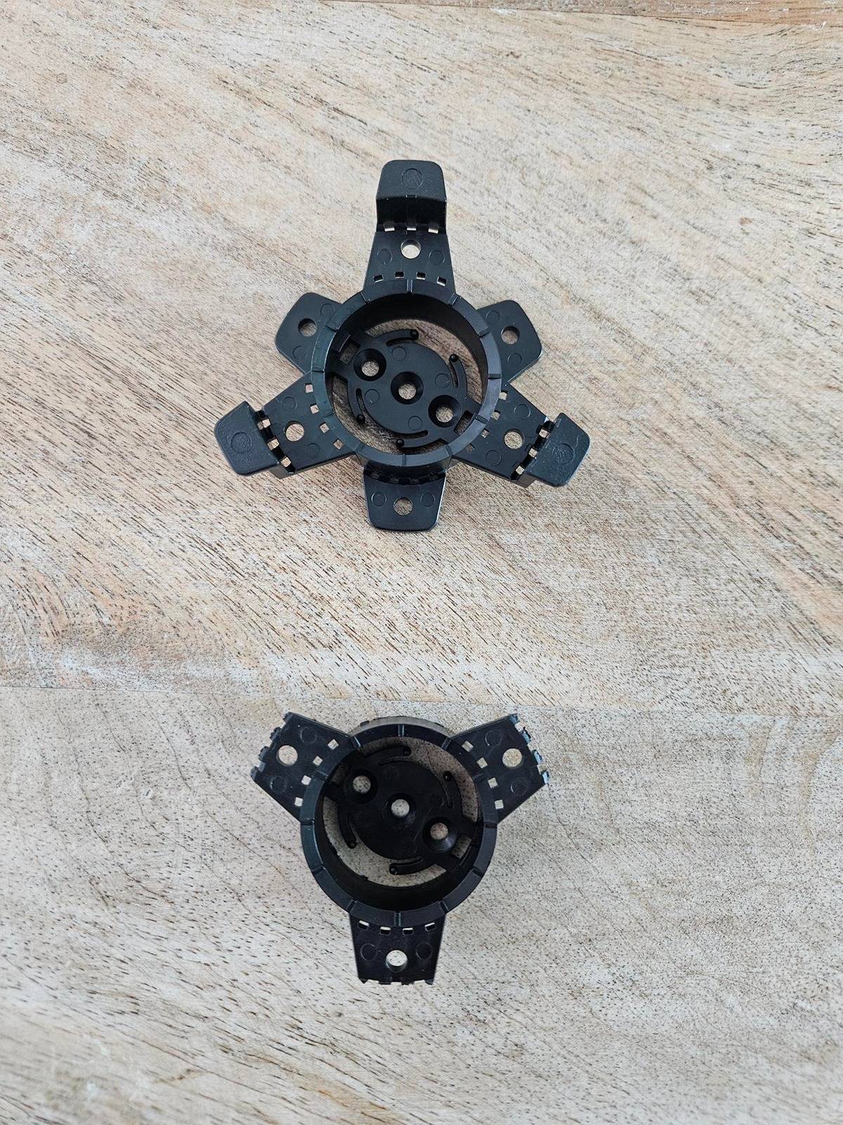

The little dome tweeter was a bit more difficult. The tweeter came with a variety of mounting brackets. I used the one pictured below, modifying into a simple flush mount. Then I used a hole saw to make a hole in the mounting adapter, supplied by Crutchfield, to mount the flush mount bracket to. I used glue to secure it.
Jeep Gladiator 2024 Mojavicon to be 1000000809
Jeep Gladiator 2024 Mojavicon to be 1000000807
Jeep Gladiator 2024 Mojavicon to be 1000000810
Then it was just a matter of wiring up the Metra adapter and stuffing all the wiring and crossover behind the mounting adapter.
Jeep Gladiator 2024 Mojavicon to be 1000000816
Coupled with the new speakers in the dash, it sounds great!

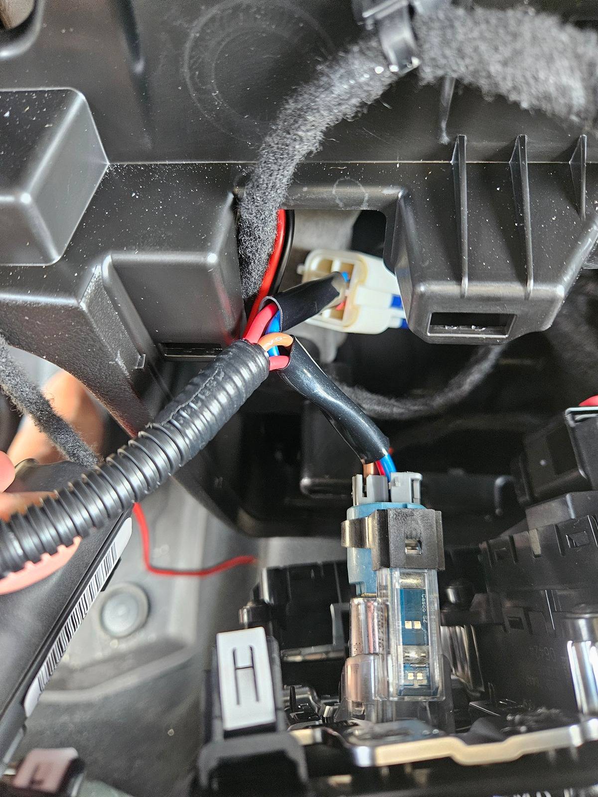

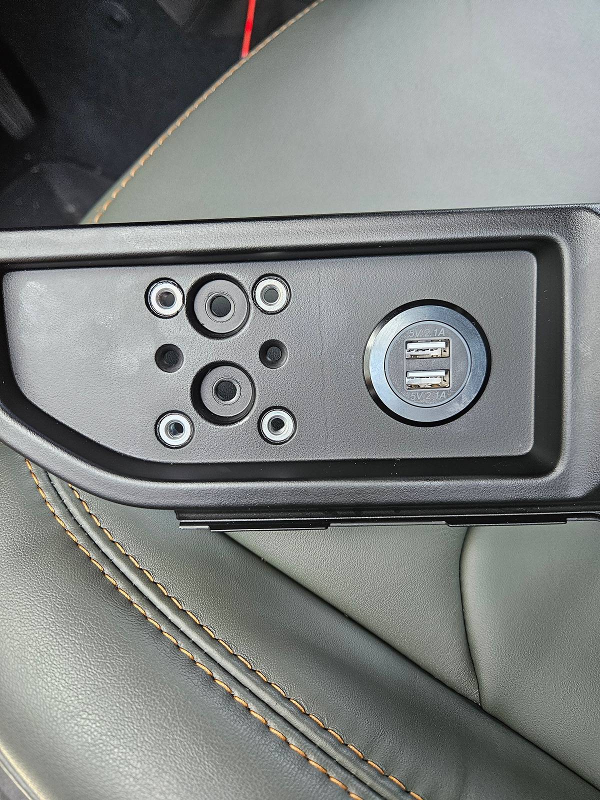

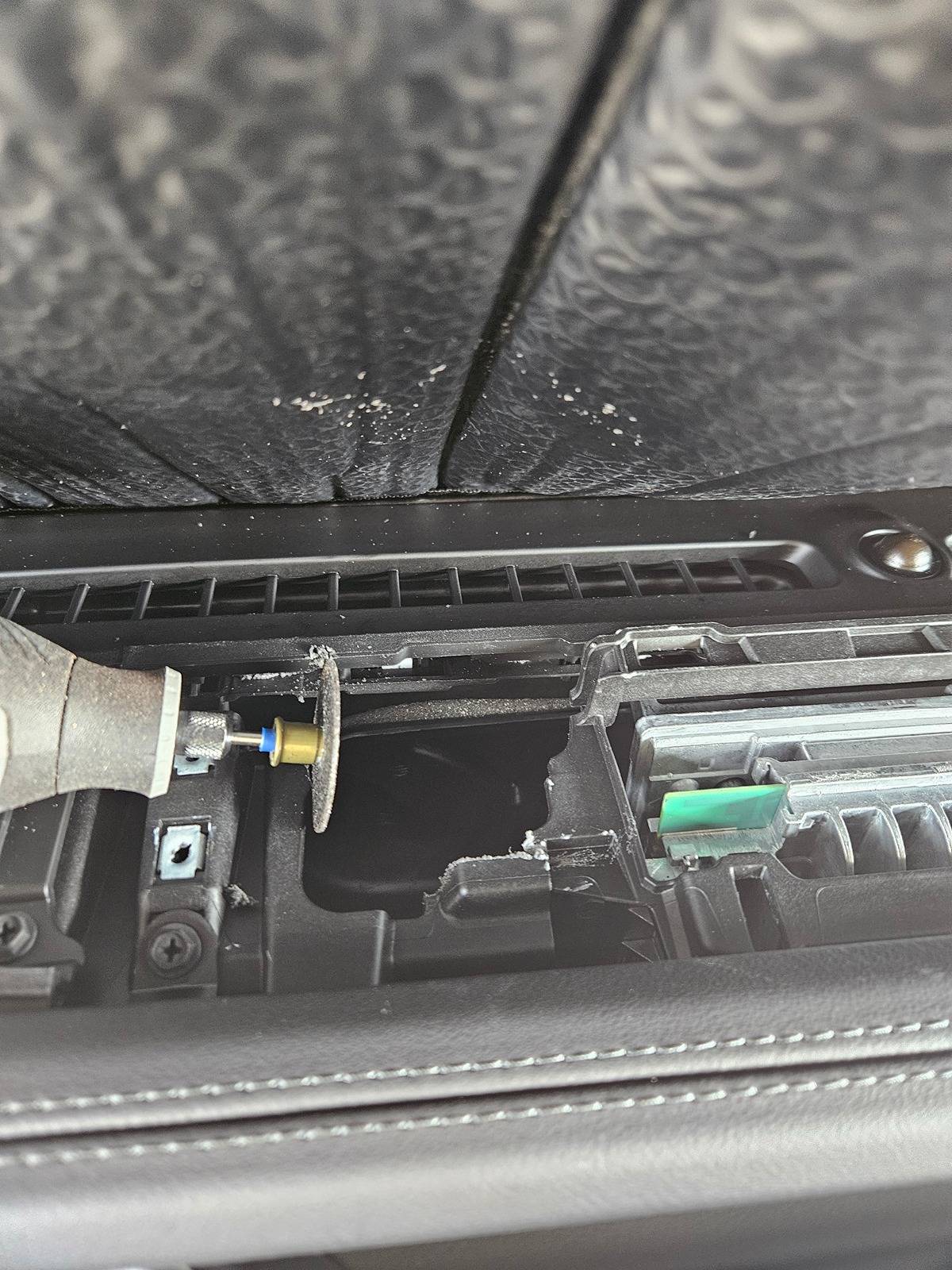

Added USB power to the top of the dash for the Bullet Point phone holder/charger.
The idea was to use the Quadratec 12V Power adapter to tap power from the 12v outlet on the driver's side dash.
Jeep Gladiator 2024 Mojavicon to be 20240511_134528

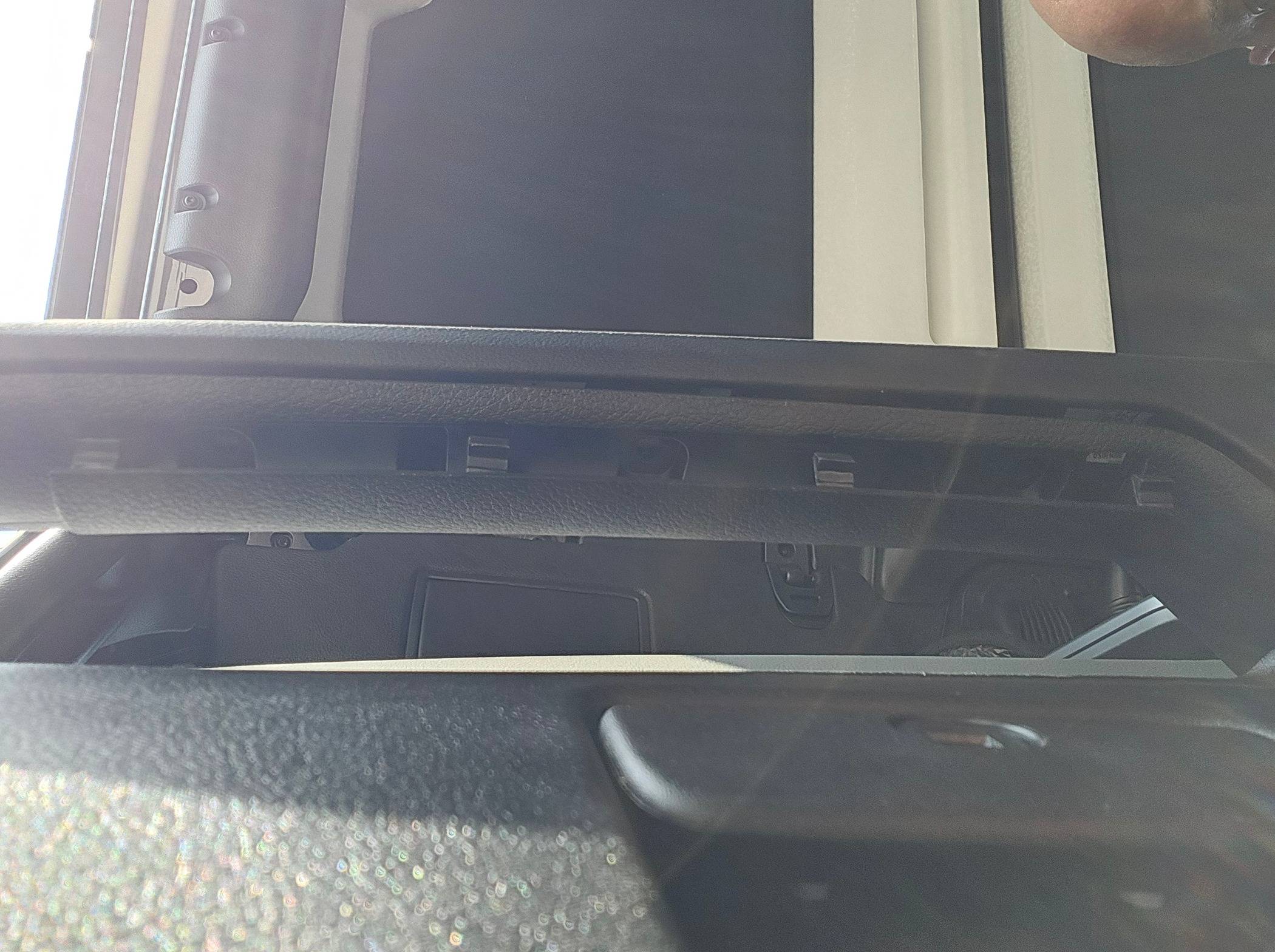

I removed the top dash trim to locate a place I could fit the USB socket.
Jeep Gladiator 2024 Mojavicon to be 20240511_101941
Since there was no space for that to fit, I had to make space with a Dremel.
Jeep Gladiator 2024 Mojavicon to be 20240511_104604

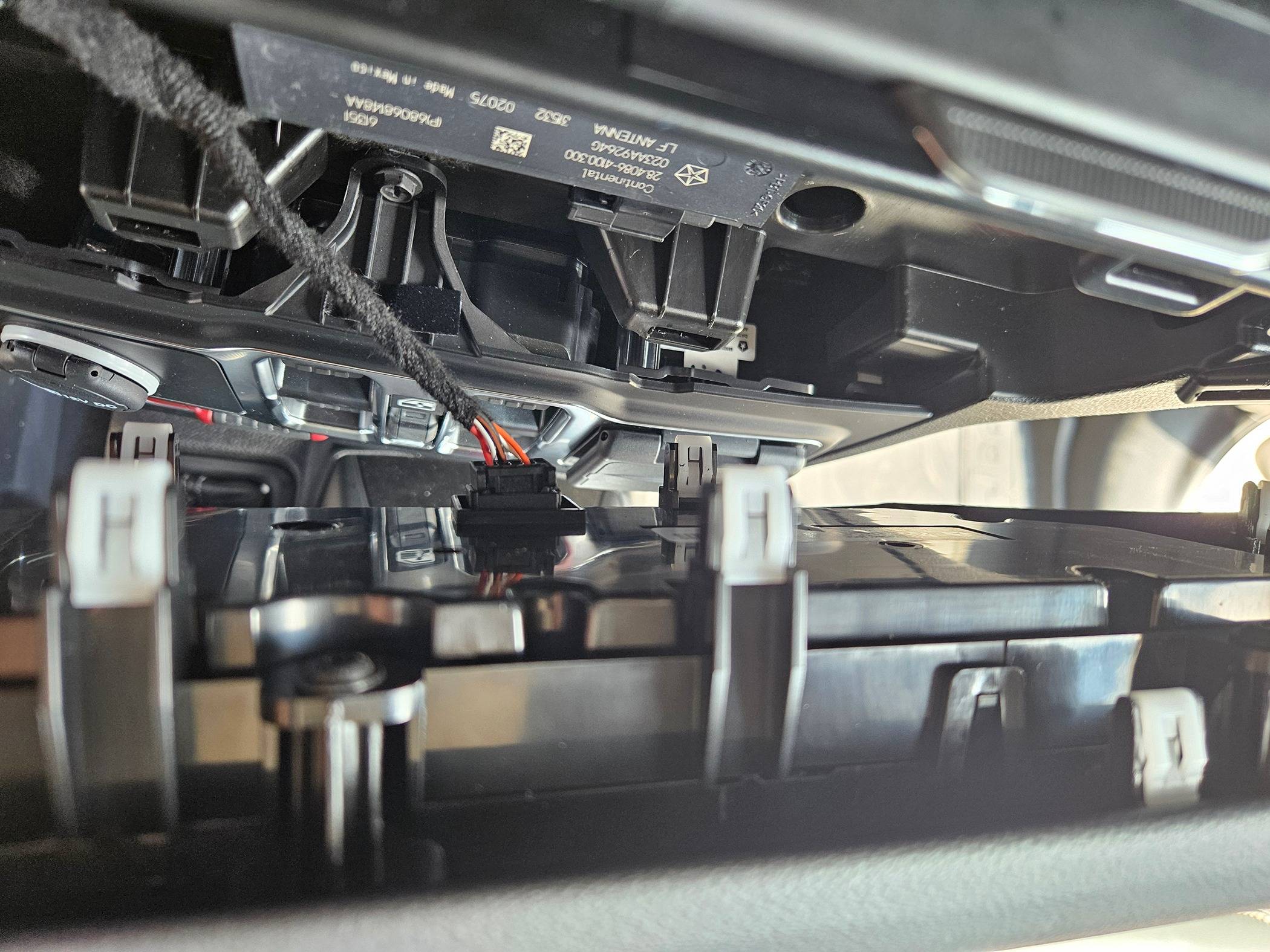

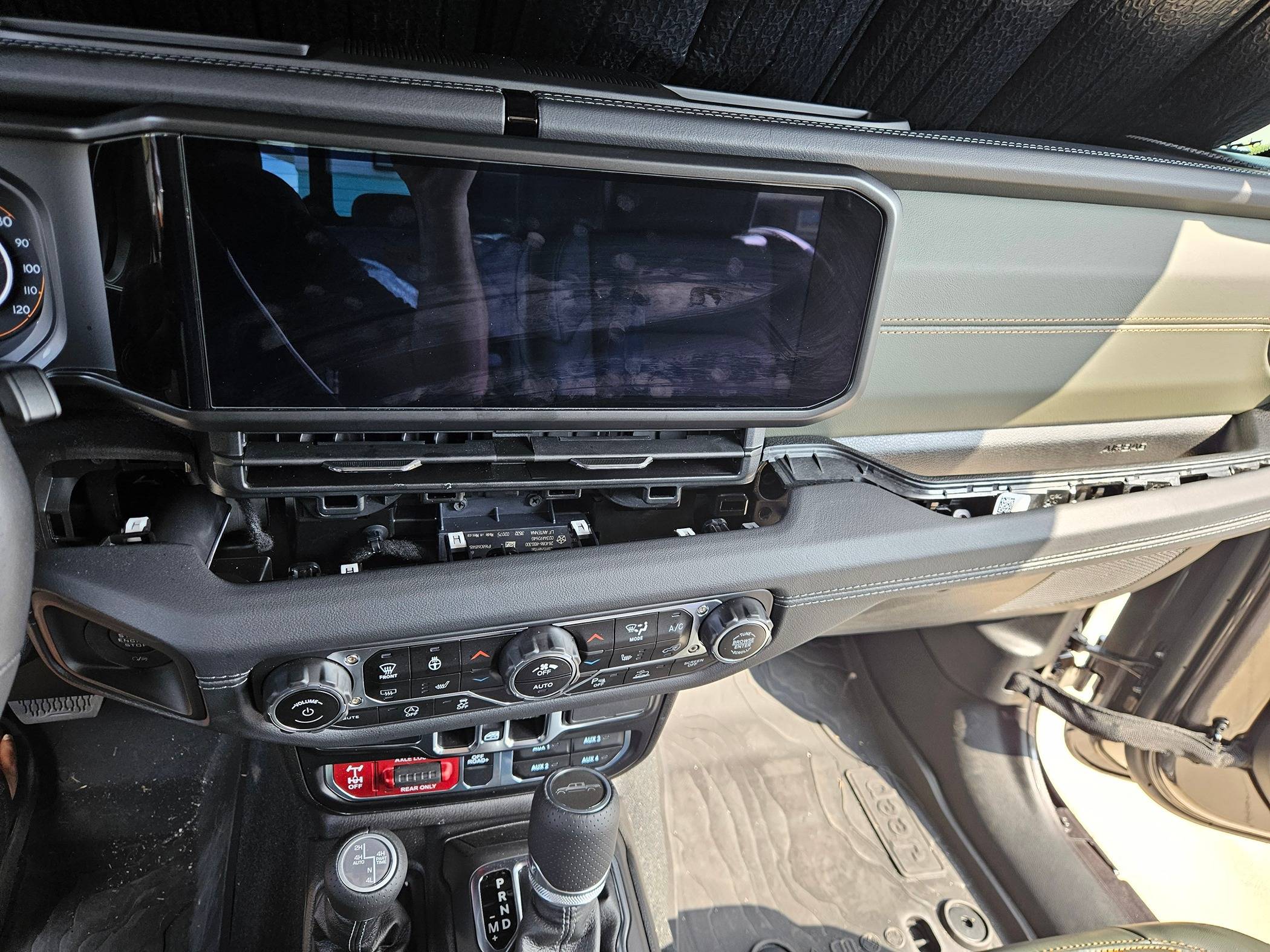

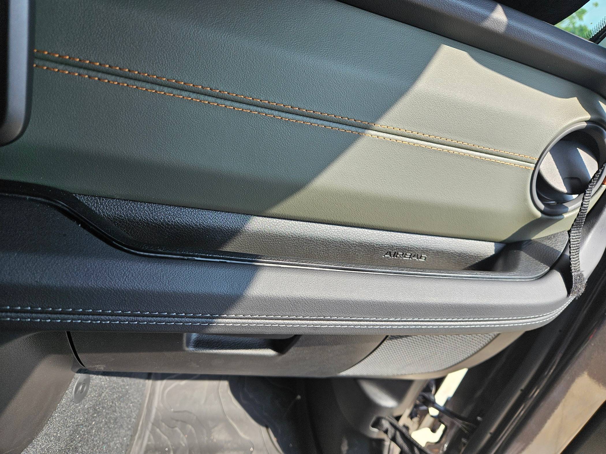

Next it was time to remove parts of the dash. I started with the control cluster. The far right side (passenger side) of that dash piece requires fairly extensive dash disassembly, so I left it attached there, and just pulled it off starting on the left side.
***Important: On the 2024 there are 3 screws hidden behind an access panel on the underside of the passenger grab bar. These have to be removed. *Pro Tip: Opening the glove box gives you more room to get a screwdriver in there.
Jeep Gladiator 2024 Mojavicon to be 20240511_101017
Jeep Gladiator 2024 Mojavicon to be 20240511_101003
Jeep Gladiator 2024 Mojavicon to be 20240511_101204
There is a plug on the back of that panel that is easy to remove so you can pull the panel out far enough to work behind it.
Jeep Gladiator 2024 Mojavicon to be 20240511_101325
There is a screw at the top of the lower dash panel (the lower dash panel is where the 12v outlet is). Once that screw is removed, unplug the harness from the back of the 12v outlet and install the adapter harness.
Jeep Gladiator 2024 Mojavicon to be 20240511_115039

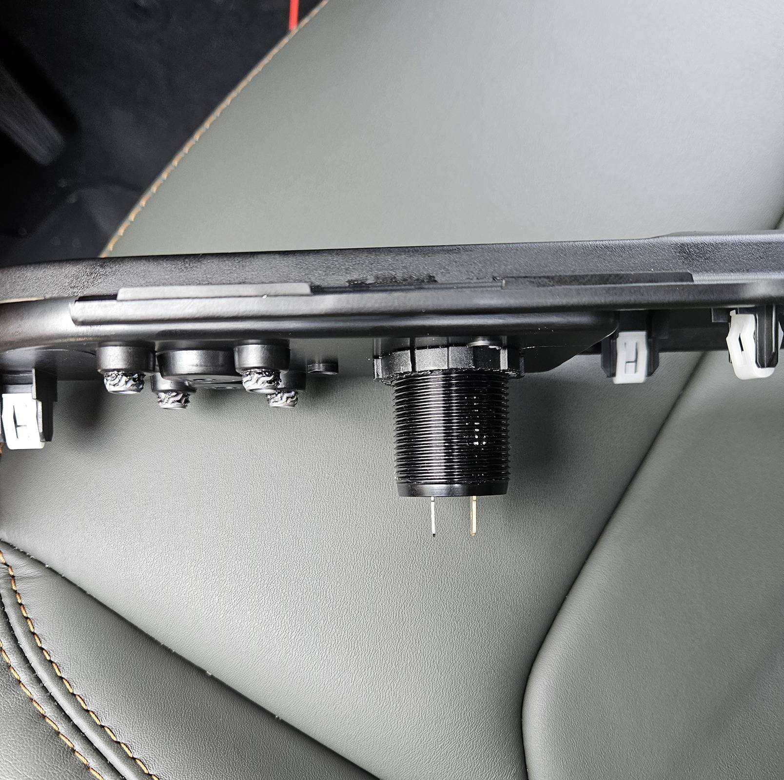

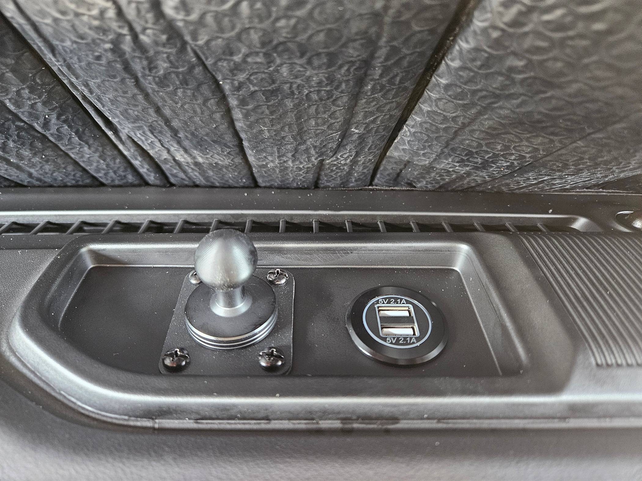

Next I ran the adapter harness fused power leads up inside the dash to where I Dremeled a space for the USB socket. Then mounted the USB socket into the top dash trim.
Jeep Gladiator 2024 Mojavicon to be 20240511_120825
Jeep Gladiator 2024 Mojavicon to be 20240511_120817
Wired the socket to the adapter harness power leads, and reinstalled the top trim and ball mount.
Jeep Gladiator 2024 Mojavicon to be 20240511_122210

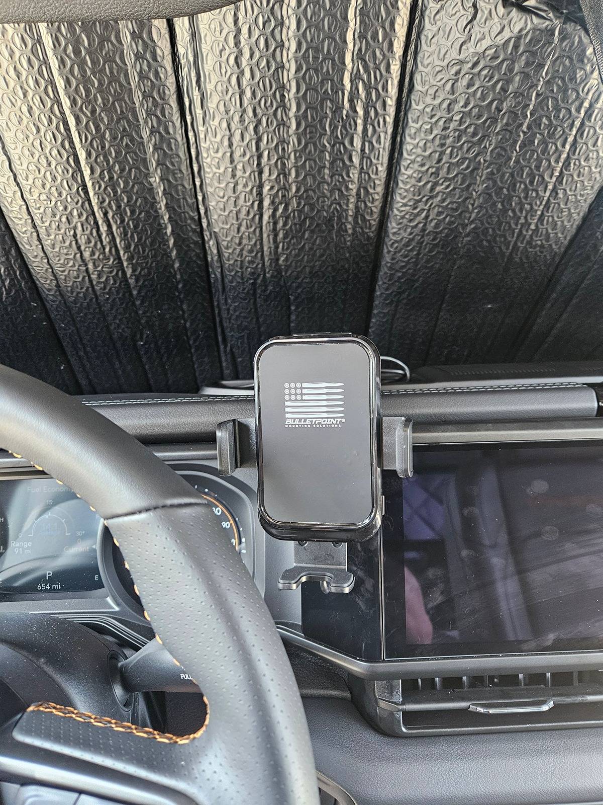

After testing to make sure it all worked, I screwed and snapped the dash back together and mounted my phone holder / charger to the ball mount.
Jeep Gladiator 2024 Mojavicon to be 20240511_123653
It was just a little bit of work to get a very clean looking install. I hate wires draped all over the dash, or anywhere for that matter. I'm very happy with the final product.

I included a picture of all the parts in their packaging in my write up above, but I think I can do one better:
ITEM​
QTY​
PRICE​
Jeep Gladiator 2024 Mojavicon to be g108R407F-F
Infinity Reference REF407F​
1​
$87.95​
Jeep Gladiator 2024 Mojavicon to be g108R757T-F
Infinity Reference REF757T​
1​
$87.95​
MasterSheet Installation Instructions​
Your MasterSheet™ is attached to this email.​
1​
$0.00​
Jeep Gladiator 2024 Mojavicon to be g120726514-o
Metra 72-6514 Speaker Wiring Harness​
1​
$0.00​
Jeep Gladiator 2024 Mojavicon to be g120SPHKC-F
Install Bay SPHKC Speaker Installation Kit​
1​
$5.00​
Jeep Gladiator 2024 Mojavicon to be g120727902-F
Metra 72-7902 Speaker Wiring Adapters​
1​
$0.00​
Jeep Gladiator 2024 Mojavicon to be g120823016-M
Metra 82-3016 Speaker Mounting Brackets​
1​
$0.00​
This is for a 2024 Gladiator.
I did not use the speaker install kit.
I hope this helps
