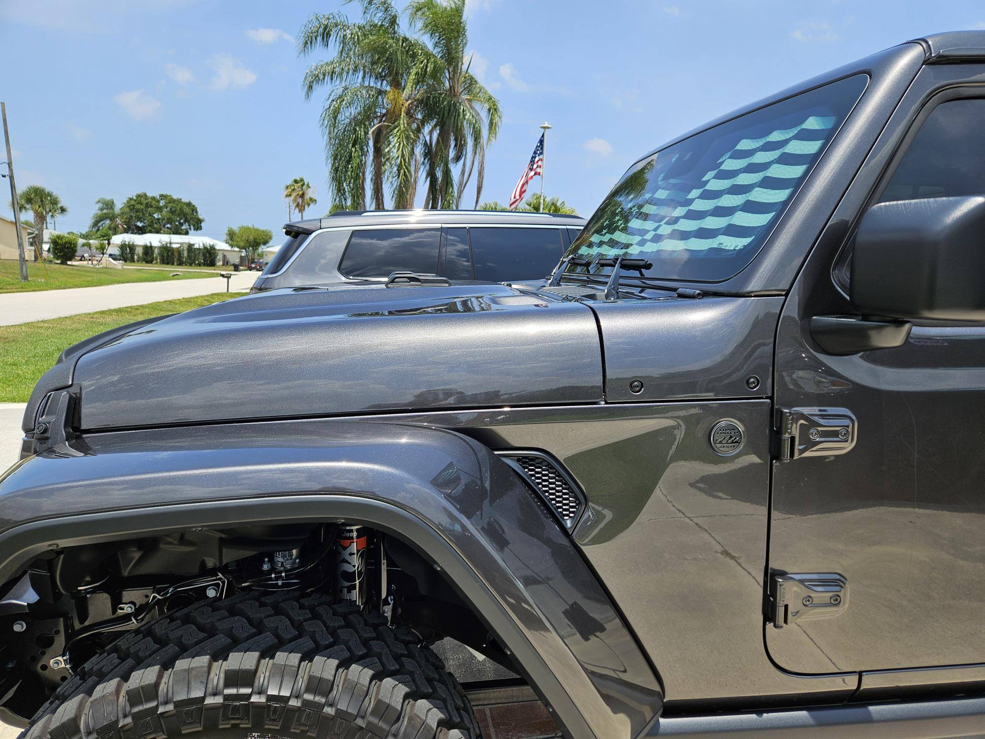

The very first mod. Locking hood latches! Why are they still using such an antiquated design? I can sleep better tonight.
These are all well and good until you loose the dam barrel keys

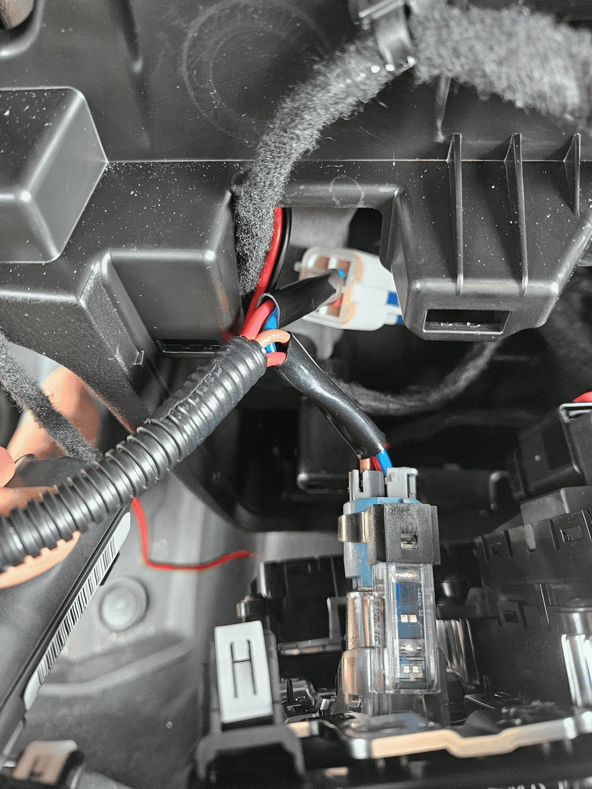

Excellent build thread. When you added the USB power to the top of the dash, do you remember if the power harness you used was the factory power for the trailer brake option or was this a different harness? Im always looking for more optional power and have moved the 12v and installed the OEM trailer brake and am curious if there is yet another harness back there unused that I didn’t see.
FL Robert
FL Robert
Robert
Feb 4, 2024
256
357
South Florida
2024 Gladiator Mojave X
Thank you!
I used this harness:
Jeep Gladiator 2024 Mojavicon to be 1717510626299-zd
It connects behind the 12 volt outlet (cigarette lighter) and uses that factory harness for power.

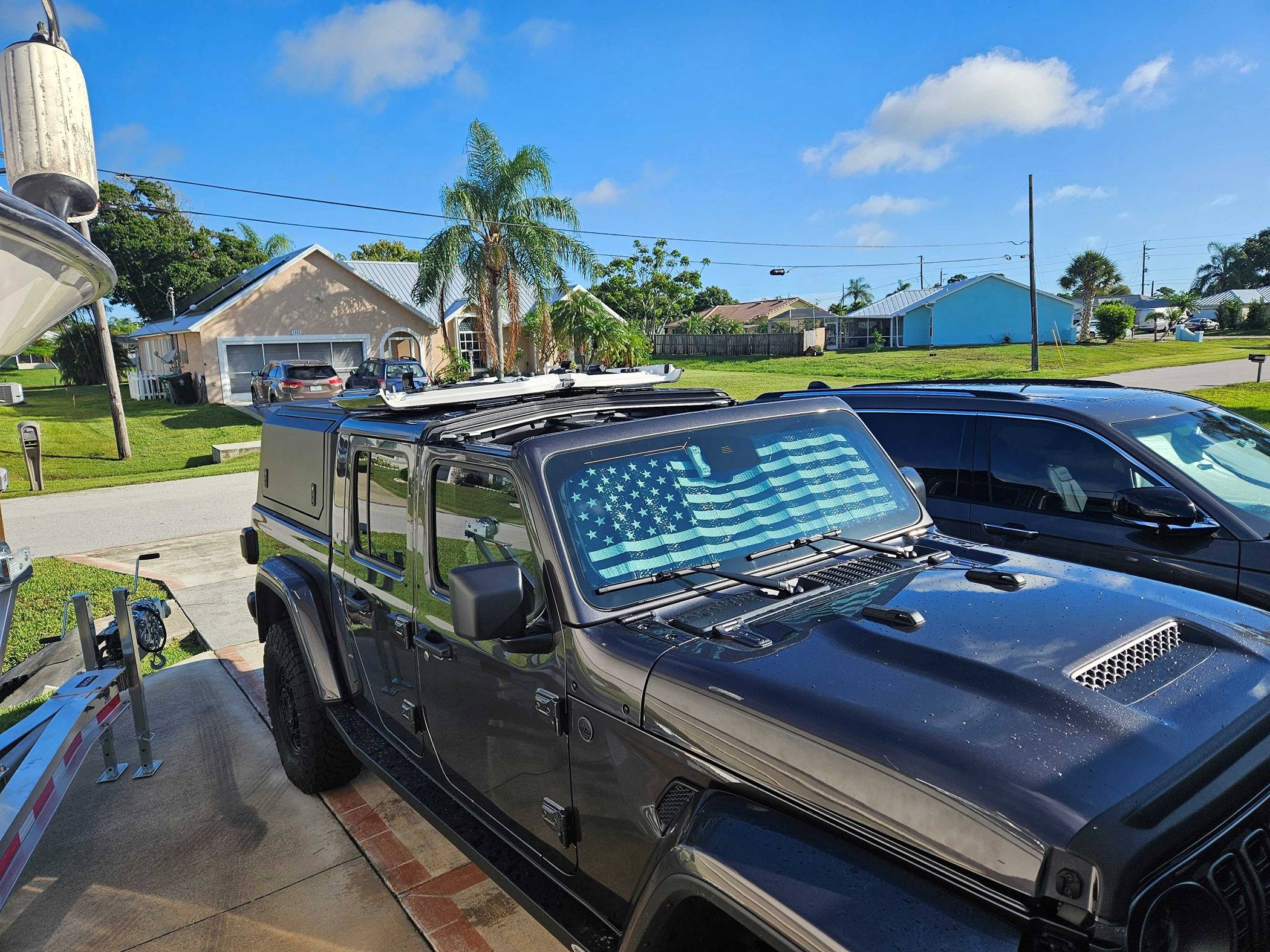

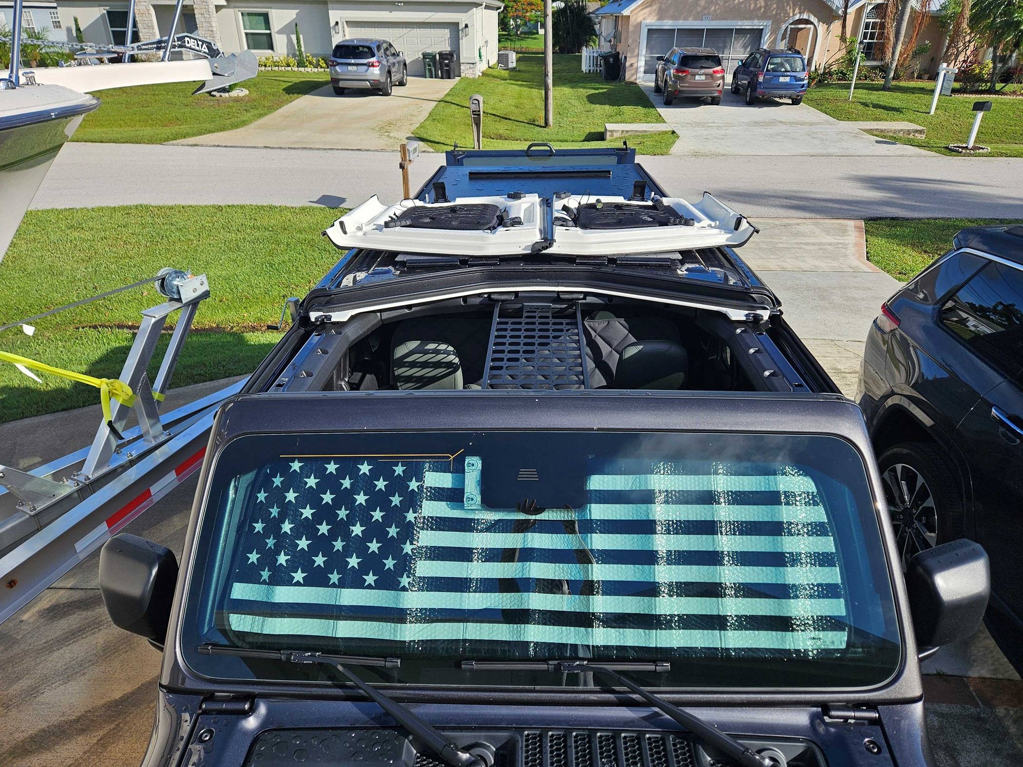

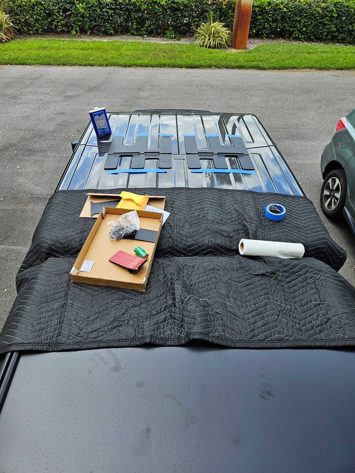

I knew when I bought my Gladiator that I would never take the freedom panels off. There is no good place to store them, and living in Florida, rain just happens out of the blue. So, I found a fix...
After some prep work, I mounted some EZ Freedom Top Hinges with VHB tape.
Jeep Gladiator 2024 Mojavicon to be hinge install small
I love it! So easy to open / close, and now I can actually use the freedom panels! It take seconds to close them.

Interested in your opinion on that mod! How’s the hwy noise open and more importantly closed? Why did you decide this instead of a sunrider (not second guessing you just curious)? When open do they bang in the top when open over large bumps or are there bumpers? It looks phenomenal.
FL Robert
FL Robert
Robert
Feb 4, 2024
256
357
South Florida
I would not leave these open at freeway speeds. I have noticed no additional wind noise when closed. When open, they lock down with a spring-loaded clamp, and have small bumpers. No issues over bumps at city / beach driving speeds. I like the security of the hard top when closed. My current project is a comm and switch paned using the overhead molle panel in the picture. A soft top would just be inviting trouble, in my opinion.
