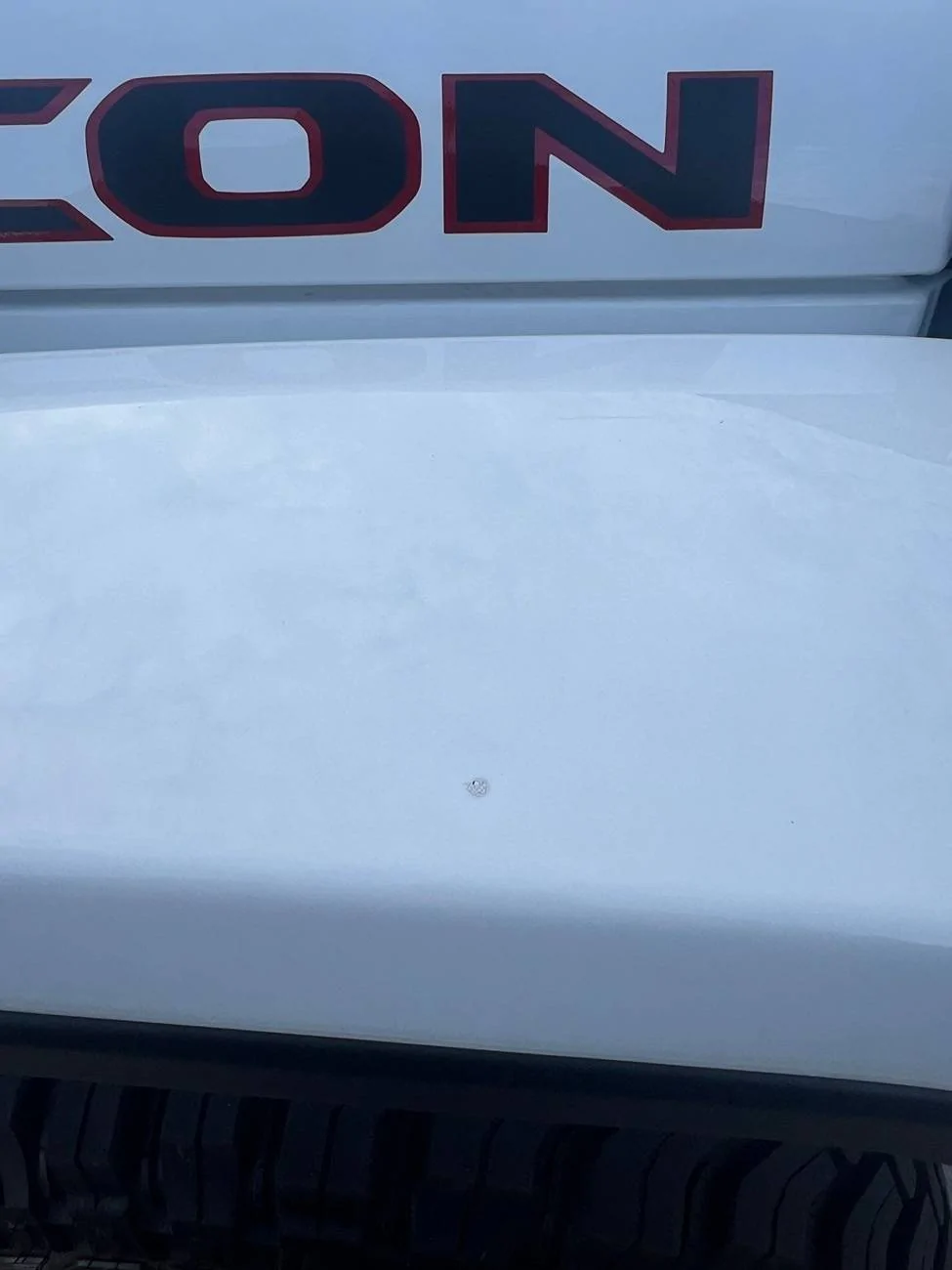

Any paint issues with the white paint on 24 ? Top of the right upper fender has a spider web effect on the paint. Took to service dept at local dealer and they didn't want to help because I didn't purchase from them and blamed purchasing dealer for not catching the error. Ive had the Gladiator 1 week,

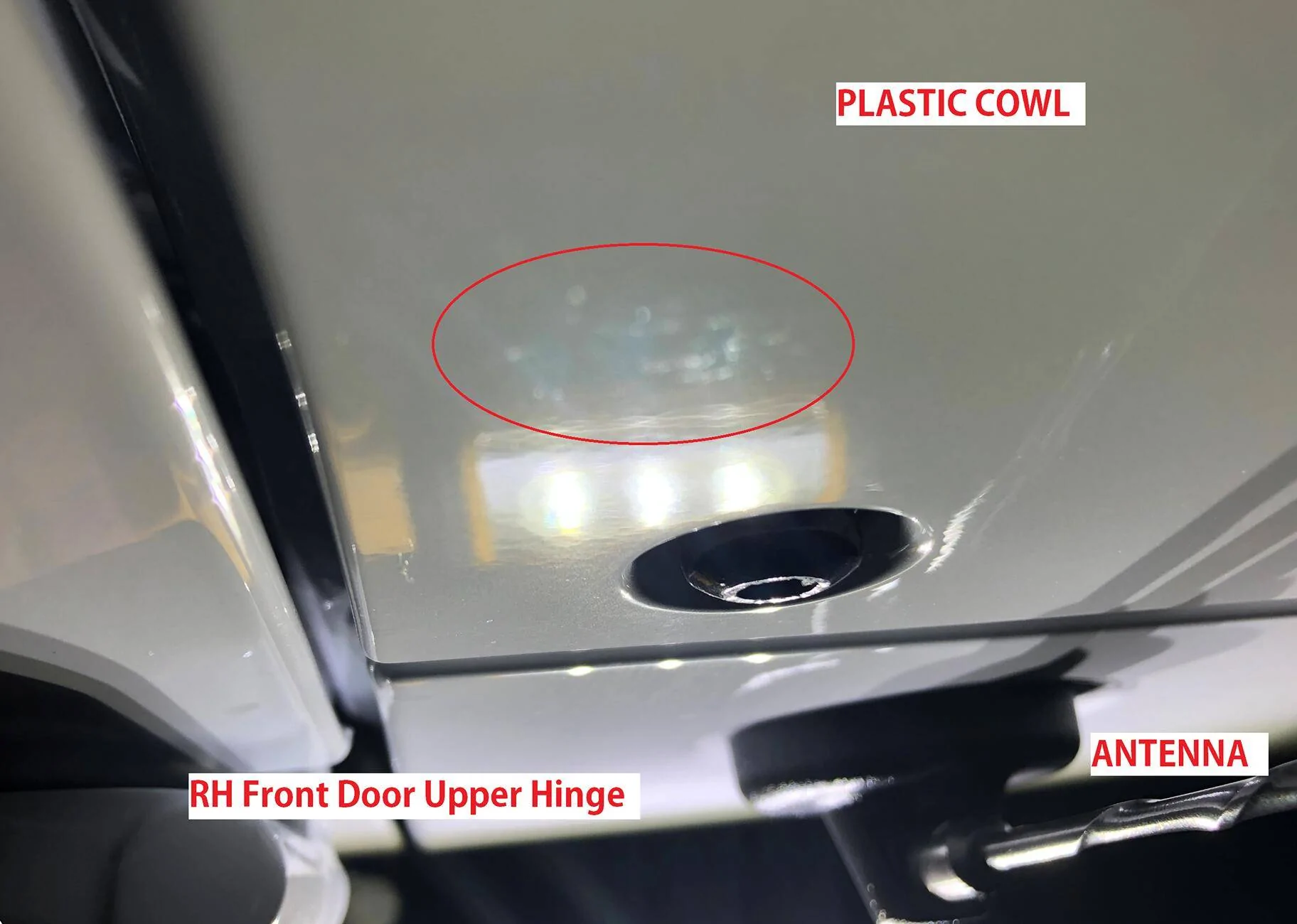

Can you post a picture?
I'm curious to see where it is and how large the area is.
My white 2021 Mojave has a small area of the paint that is a little 'funky', and it was there at delivery. It is on the right side plastic cowl piece that is above the fender at the base of the windshield. I can barely feel the area with my fingernail, so I should be able to buff it out without much effort. The problem is that I keep forgetting about it because you can only see it when the light hits it just right.
Anyhow, my thought is that if your 'spider webs' are in the same area and look similar, then it may have something to do with the manufacturing/assembly process.

Here is a picture of the area on my paint. I'm standing just behind the RH front wheel, facing the vehicle, looking down. Sorry for the crappy pic, but I needed the flashlight to get a reflection and my camera keeps focusing on the light reflection and not the funky spot.
Jeep Gladiator 2024 rubicon white paint issue 1736990965749-82

My first thought, looks like someone put their cigarette butt out on it.

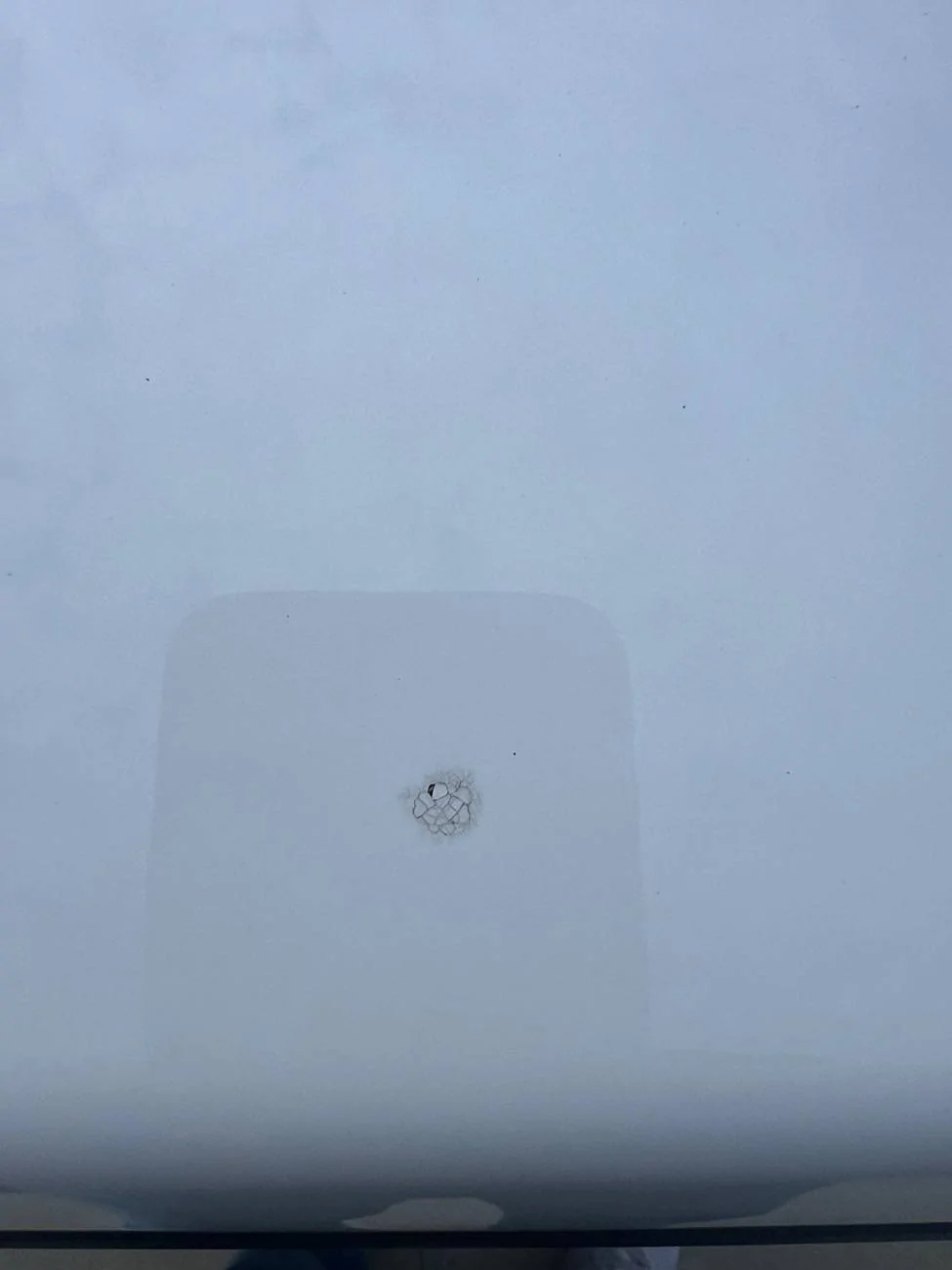

Jteakus
Teakus
Feb 19, 2022
2,083
3,810
Oil City, LA
2020 JLURD, 2022 JTRD, 2017 JKU, 1983 CJ-7
My black JL has those on the color matched flares. Looks like tree sap.
My white JT has something else going on on the color matched flares, I'll grab pics in the am.
jac04
Jeff
Apr 20, 2021
1,551
2,262
CT
2021 Mojave, 2014 JKRX SWB
Ahhh, completely different than mine.
That looks like a spot of dried tree sap to me. If it is, put a blob of alcohol-based gel hand sanitizer on it and let it sit for a while - like overnight if possible. That should soften the tree sap and let you wipe it off.
But, with that said, is that little black spot actually a small chunk of paint missing? It almost looks like someone tried to remove the substance with their fingernail and ended up chipping the paint.
