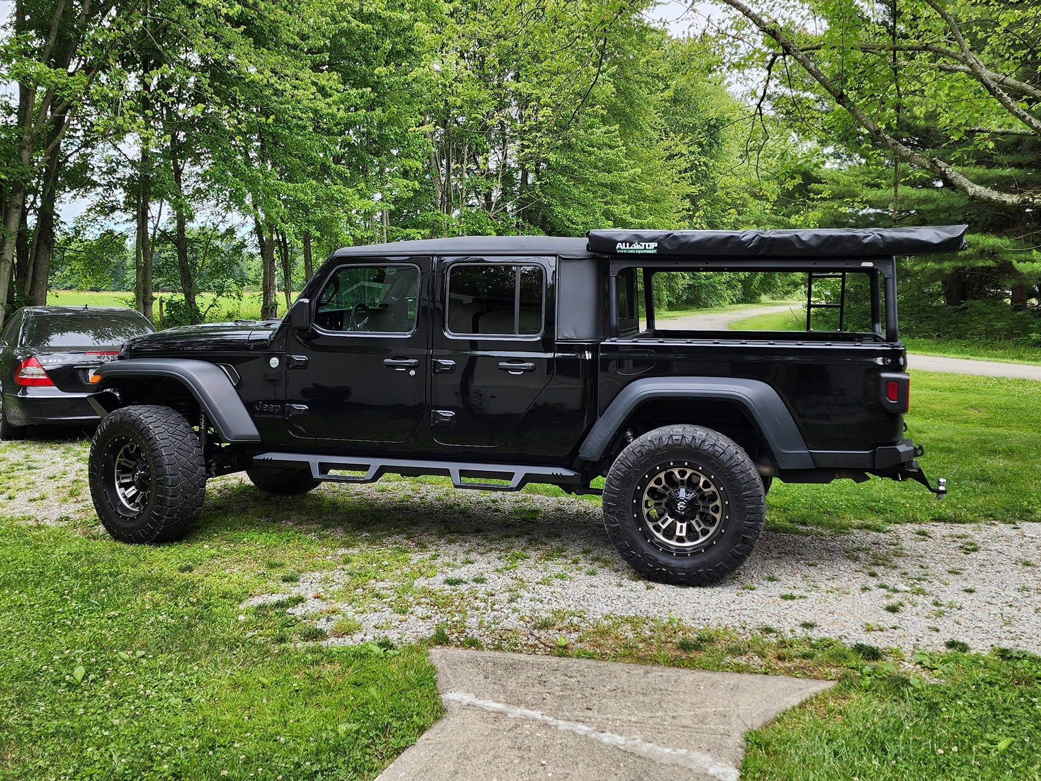

I have a '22 JTRD. Have a 4" Franken lift on it. Core control arms and front track bar. Clayton rear track bar, and front and rear springs. Teraflex front geo brackets, and rear track bar mount. 37's on 17x8.5 with 0 offset. Still using the oem stabilizer, drag link, and tie rod.
Lowing the air pressure on mine made a difference in handling. Have 28 front and 26 rear. Above 32, it starts to wonders.
Your dead spot. It's either play somewhere in the steering linkage, or steering box.
Make sure your track bars are adjusted properly. Process of elimination.

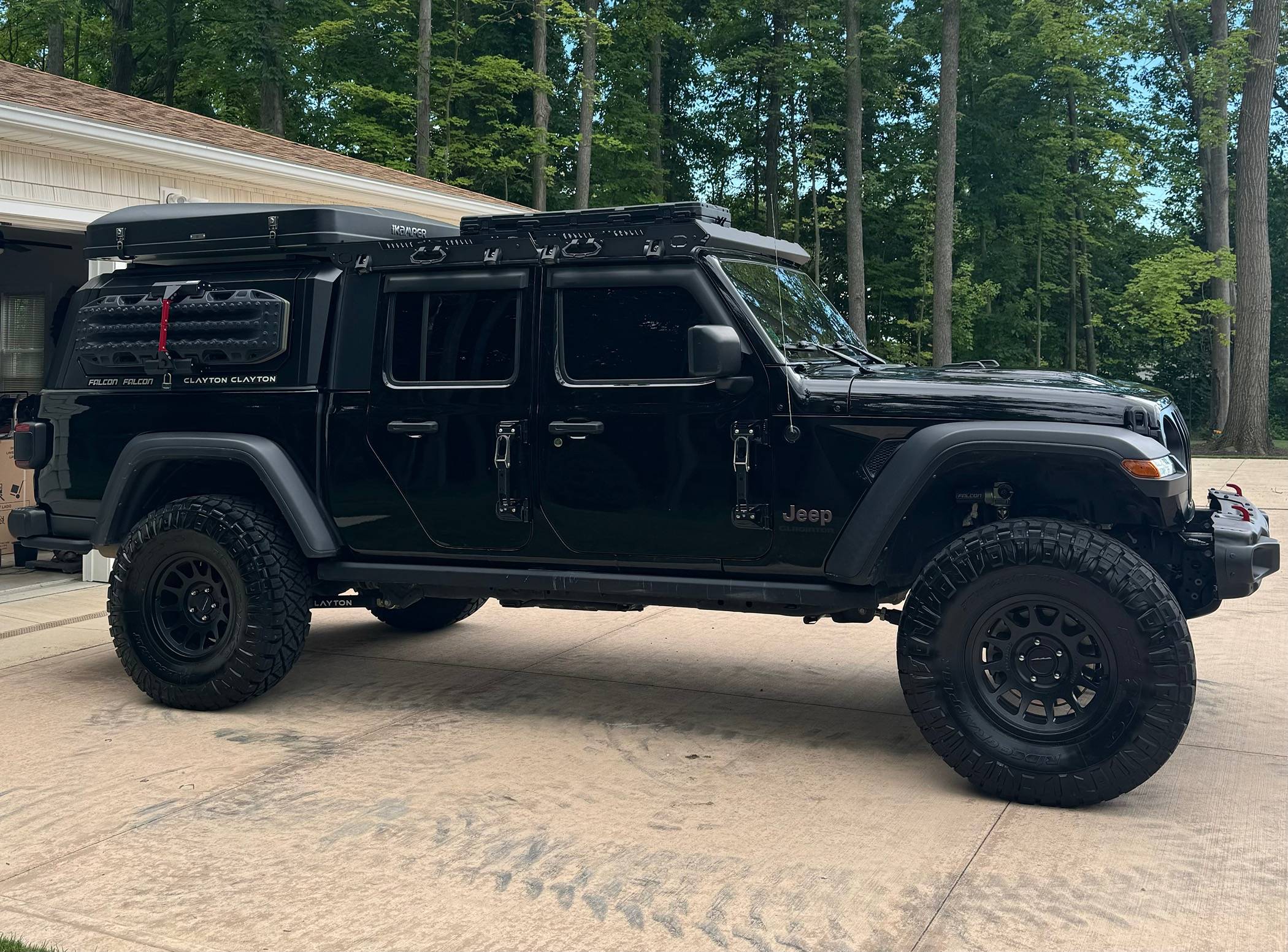

Hey all. Looking for some help here.
Just had my 2021 Rubicon Diesel Gladiator lifted by Total Offroad & More in Cleveland Ohio with;
-Clayton Offroad 2.5' Premium Diesel kit and HD springs, Falcon adjustable Shocks and steering stabilizer
-37" Nitto Ridge Grapplers (37X12.50R17/8 124Q)
-Method Race Wheels 703 (17X9 5X127 -12MM)
After, I noticed 2-3" of slop or play in the steering when trying to hold center. Basically the steering wheel is unresponsive for those 2-3" causing a constant correction back and forth to keep the vehicle straight. Super unstable. I called Clayton Offroad, the only thing they offered was that is wasn't an issue with their kit and to maybe check the steering box to ensure it was not the aluminum version. I confirmed the steering box is not aluminum and is the updated version.
Took the jeep back to Total Offroad. They adjusted the castor after I suggested such from reading up on forums to 4.5 which helped a little but the vehicle is still unstable at highway speeds of 60-70mph. I am having to over correct and at times feel as if I could flip the jeep if I don't pay critical attention to the steering. A constant back and forth to keep it steady. There's no way I can take the jeep on a 4 hour trip somewhere to Offroad. How can I fix this.

UPDATE: PROBLEM SOLVED
They removed the Falcon Adjustable steering stabilizer and replaced it with a basic $80 Teraflex one and the Jeep drives like factory. The Falcon may be defective. When pushing the rod down it feels gritty instead of smooth. Had it at 70mph on the highway with a couple fingers. Cool calm easy drive. Very happy and ready for Michigan trips. This was with 38-40psi so the tire pressure didn’t have anything to do with it in this case.
Caster was always at 6. I’m not sure where they got the 4.5 number from. I think the guy at the counter was mixed up when he told me that.
I did just drop the pressure today from 39-35psi in the tires and didn’t notice anything other than feeling less bumps per usual. (I can’t see lowering my rear tires below 35psi for on road use. I can already see the start of a sag in the tires with all the extra weight of my overlanding gear in the back. The clayton HD springs really helped that.
Thanks everyone for the help. Will be contacting Falcon next to see if they can check the stabilizer out.
