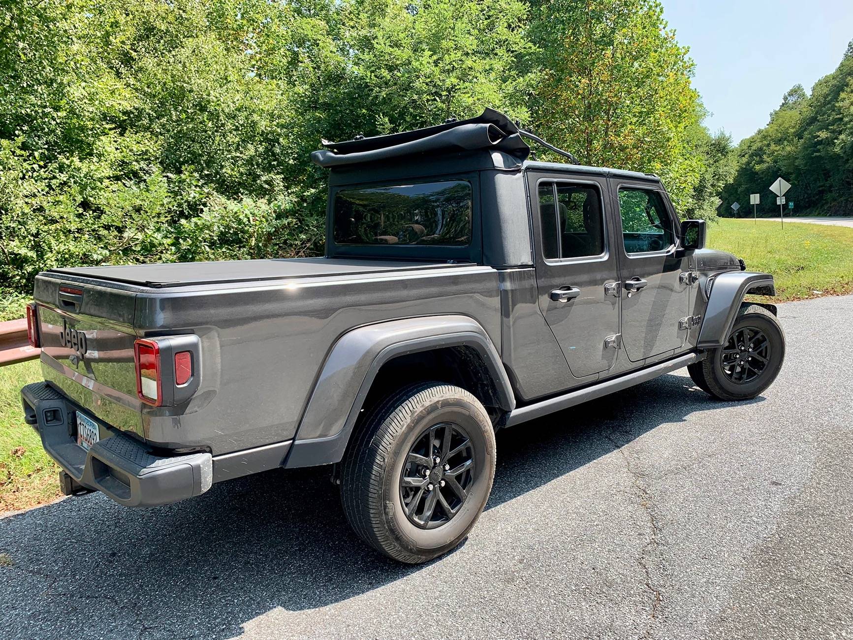

2022 Jeep Gladiator Sport S
pilot
I upgraded my Sport S from 245/75R17 to 265/70R17. I really was leaning toward the 255/75R17, but it is such a rare size and special order in most shops if I needed replacement on a road trip. The 265/70R17 is a very common OEM size with many manufacturers to choose from.
A great tool to help to compare and decide:
https://tiresize.com/calculator/
Jeep Gladiator 22 Gladiator Sport replace OEM tires IMG_5502
