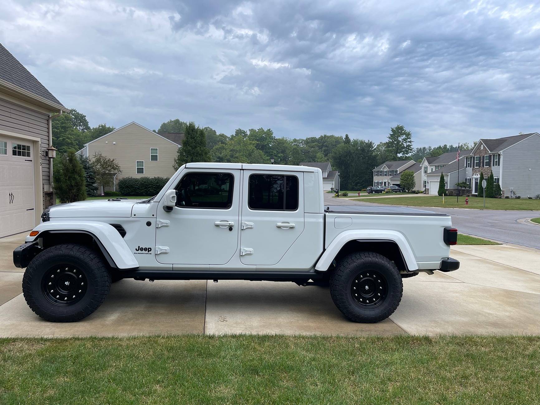

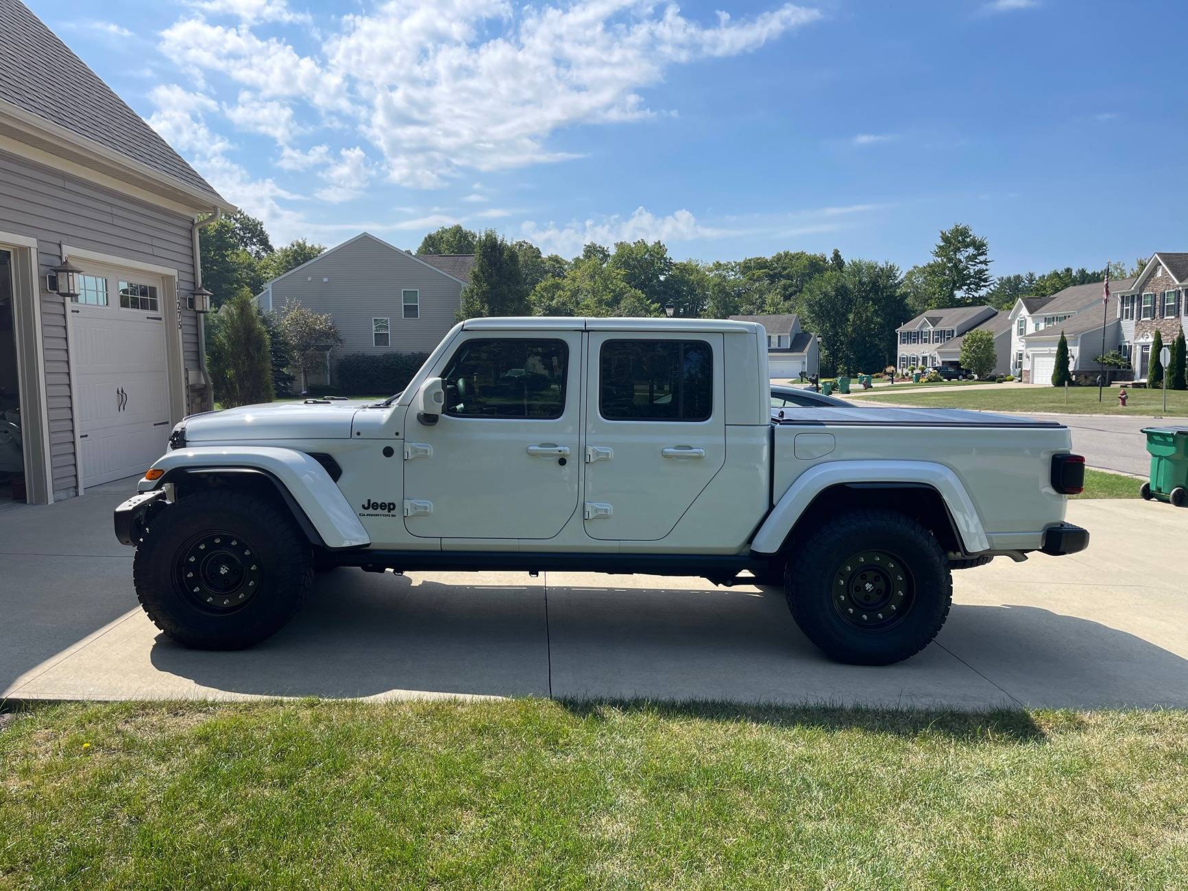

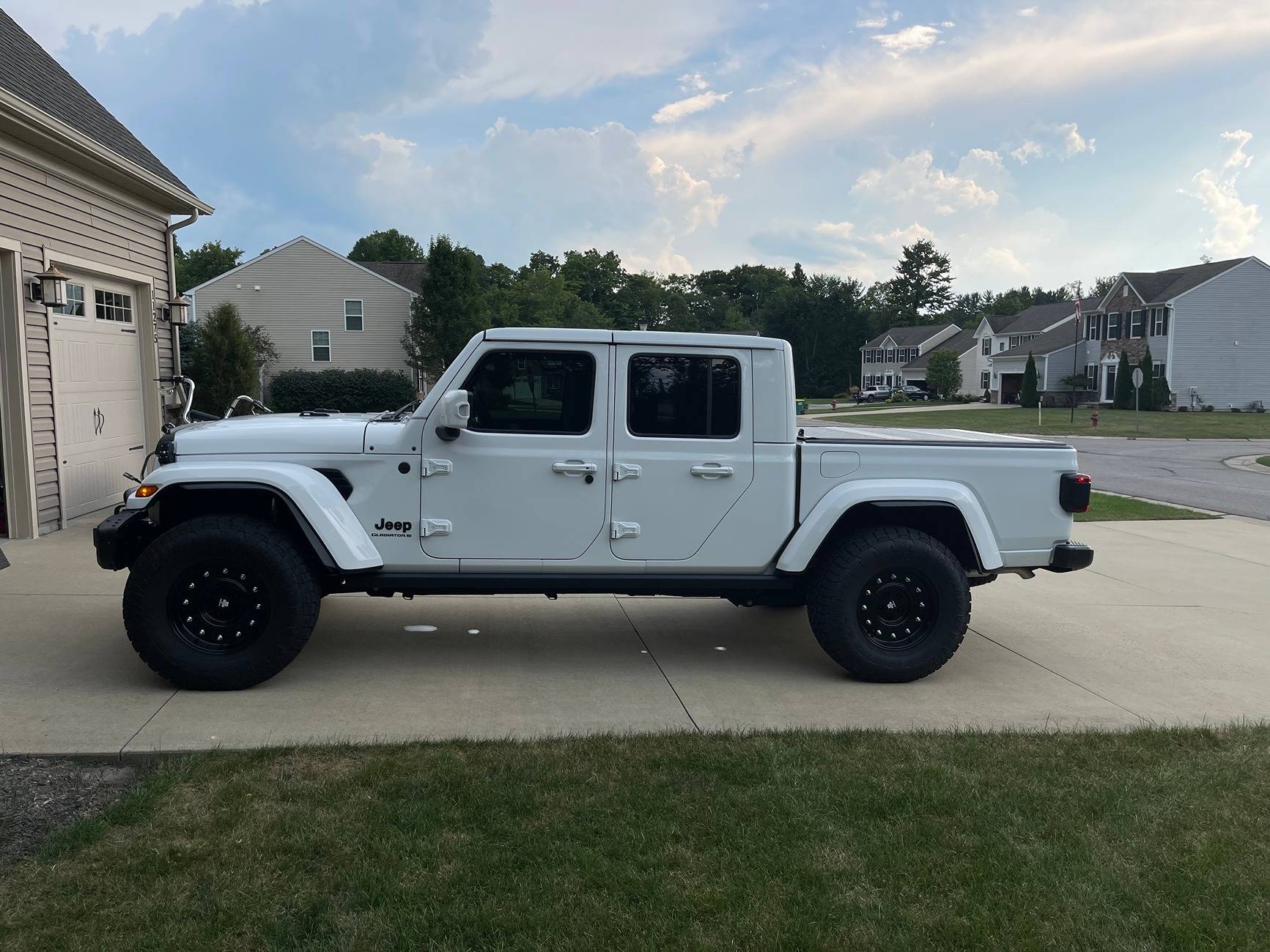

Well got most of it on (1.5" TeraFlex Front spacers and Daystar .75" Rear spacers and Bilstein 0-1.5" shocks (F) and 0-1.0" (R) shocks).
The two kits above are on as are the shocks, the Mopar longer, lower control arms aren't, as I had no tool strong enough to break the bolts loose. I should have that by mid-next week and will swap those out then.
Measurements:
Before:
FF: 37
Clearance: 3-7/8
(both sides)
RF: 38.5
Clearance: 5-1/4
(Both sides)
FDLCA Angle: 1.16
FPLCA Angle: 1.24
(both taken on top of the LCAs, just in front of flag nut where it sticks out)
Jeep Gladiator 23 JT High Altitude - White 1725113331008-7d
Before Install
After:
FF: 38.5
Clearance: 5-1/8 (approx)
(both sides)
Increase: 1.5" (approx)
RF: 39-1/4
Clearance: 6"
(Both sides)
Increase: .75"
FDLCA Angle: 4.24 (+3.08 degrees)
FPLCA Angle: 4.10 (+2.86 degrees)
(both taken just in front of flag nut where it sticks out)
Jeep Gladiator 23 JT High Altitude - White 1725113379925-fv
After install
Jeep Gladiator 23 JT High Altitude - White 1725113446640-j9
After front spacers only. Trucks level but I didnt want to have it dip in the rear when towing and wanted some rake for gas mileage so added the .75" rear spacers. Pic is just for reference for anyone interested.
Overall Impressions:
Probably too early to tell yet (just did this yesterday) but, I feel it rides OK, not great (handled bumps on road better before). I think the new angles for the LCAs may be making it feel slightly more abrupt when hitting normal road imperfections. Its definitely stiffer and adding the bilsteins (0-1.5" lift shocks) is probably part of that too. When I get the new LCAs installed, the axle should shift forward a bit and those numbers should be closer, which hopefully adds back some smoothness.
I also need to adjust the drag link today to re-center the steering wheel (its sitting between 11 and 1130). So it didnt change that much but it did shift slightly to the left. Will get that done today.
I also noticed the axle appears to have shifted to the right (when standing in front of it) by 1/2" or so and that's to be expected but nothing I saw doing research beforehand mentioned this but I've done this before and know that gonna happen. So, an adjustable track bar for the front is in its future too. If anyone has any recommendations on a good adjustable Track Bar for this application, pls let me know. Not sure about the rear. Will check later. I only loosened the passenger side rear track bar bolt, not both.
The install wasn't horrible, just time consuming (took me 9 hours to do both front and rear). That included a lot of back and forth with the jack/jack stands and getting the right height to get the droop necessary to remove the springs (front and rear). That's without changing the LCAs too. If I had to do that, it would easily have been another 1-2 hours.
Front was much easier than the rear. Had to remove both rear calipers and hang them from the frame to avoid pulling too hard on the lines. Didnt have that kind of trouble up front but i did loosen up the UCAs and the track bar. I did NOT remove the track bar bolts either. I left them loose so I didnt need anybody to help get the axle Track Bar bolt back in. I did not loosen any control arms in the rear (probably should have and that may have made the spring work easier but again, I didnt have a tool w/enuf oomph.
Ultimately this is a budget friendly lift that should allow me the tire clearance I needed for the 35's I have (was rubbing the fender liner at full lock only/now its not) and to potentially take on some mild trails here and there.
A full blown lift will be put on later when and if the vehicles use calls for that.

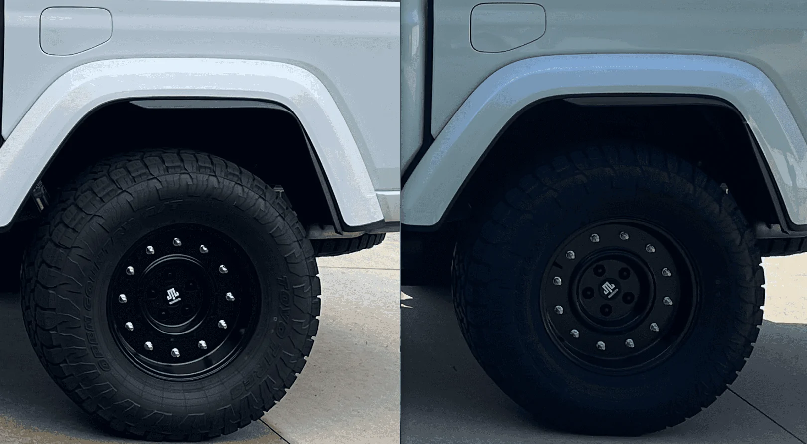

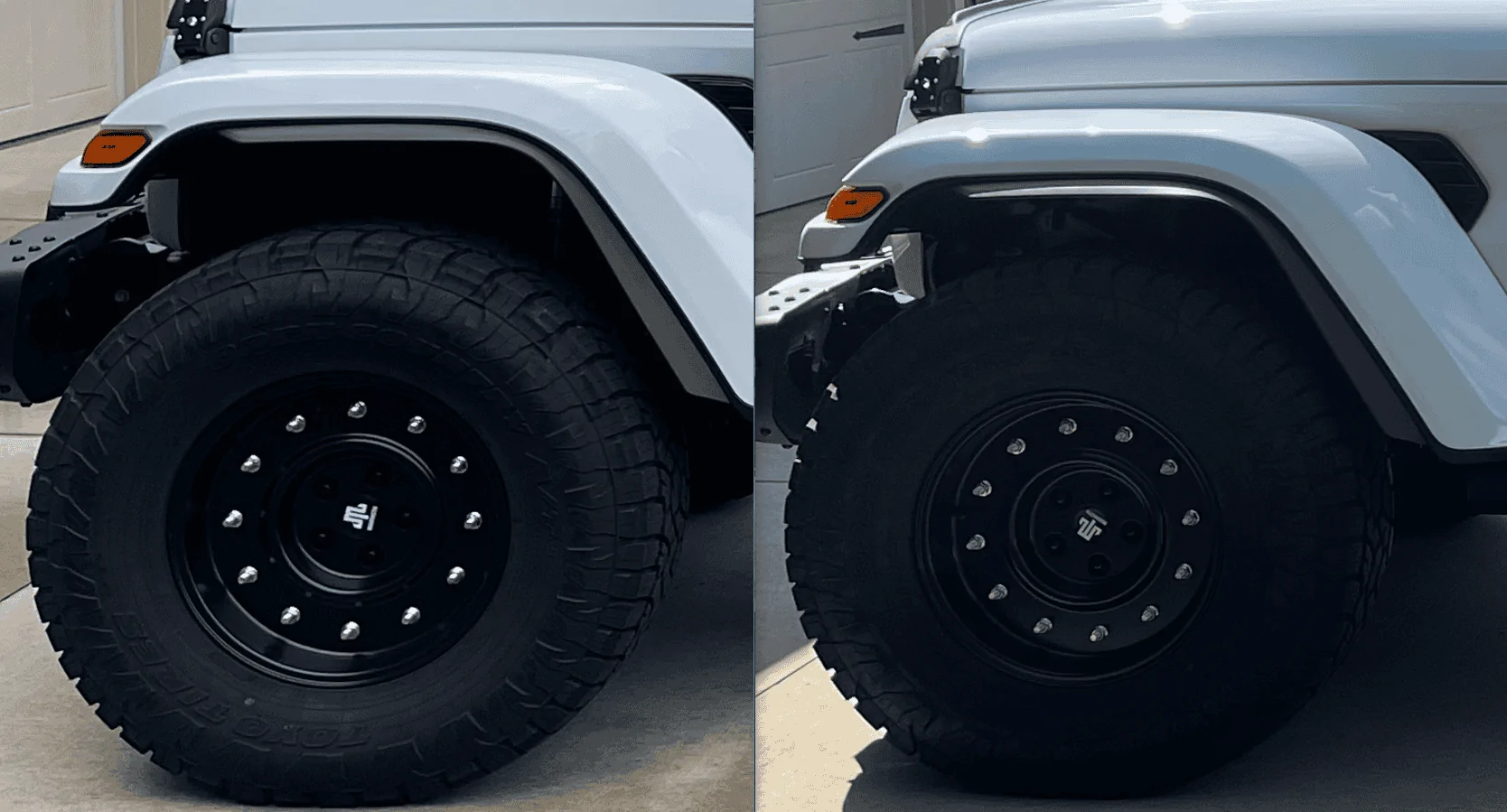

Adding a couple more comparison pics for front/rear. Pics arent the greatest light-wise but U get the idea what the lift does for it. Before's are on the right
