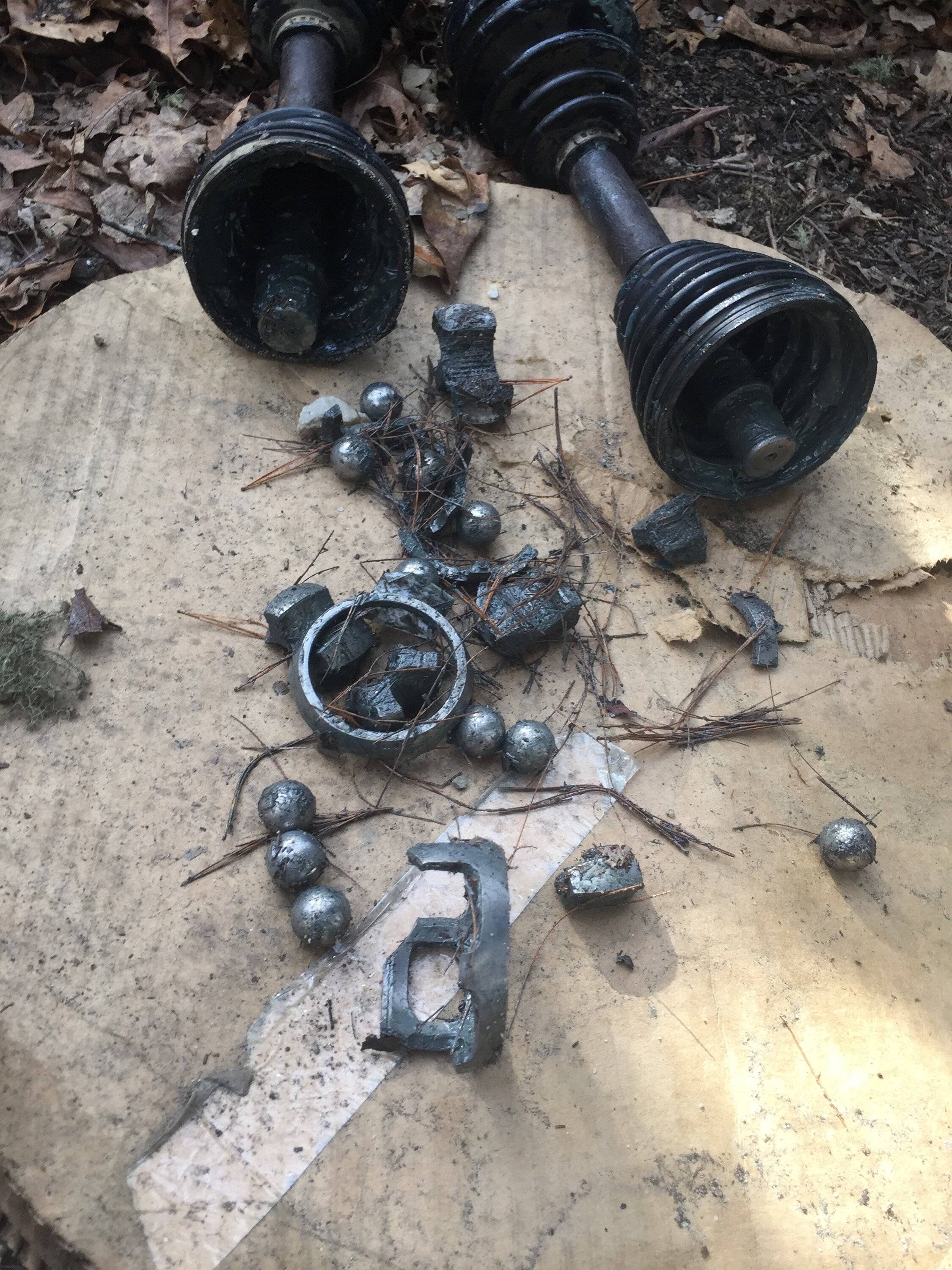

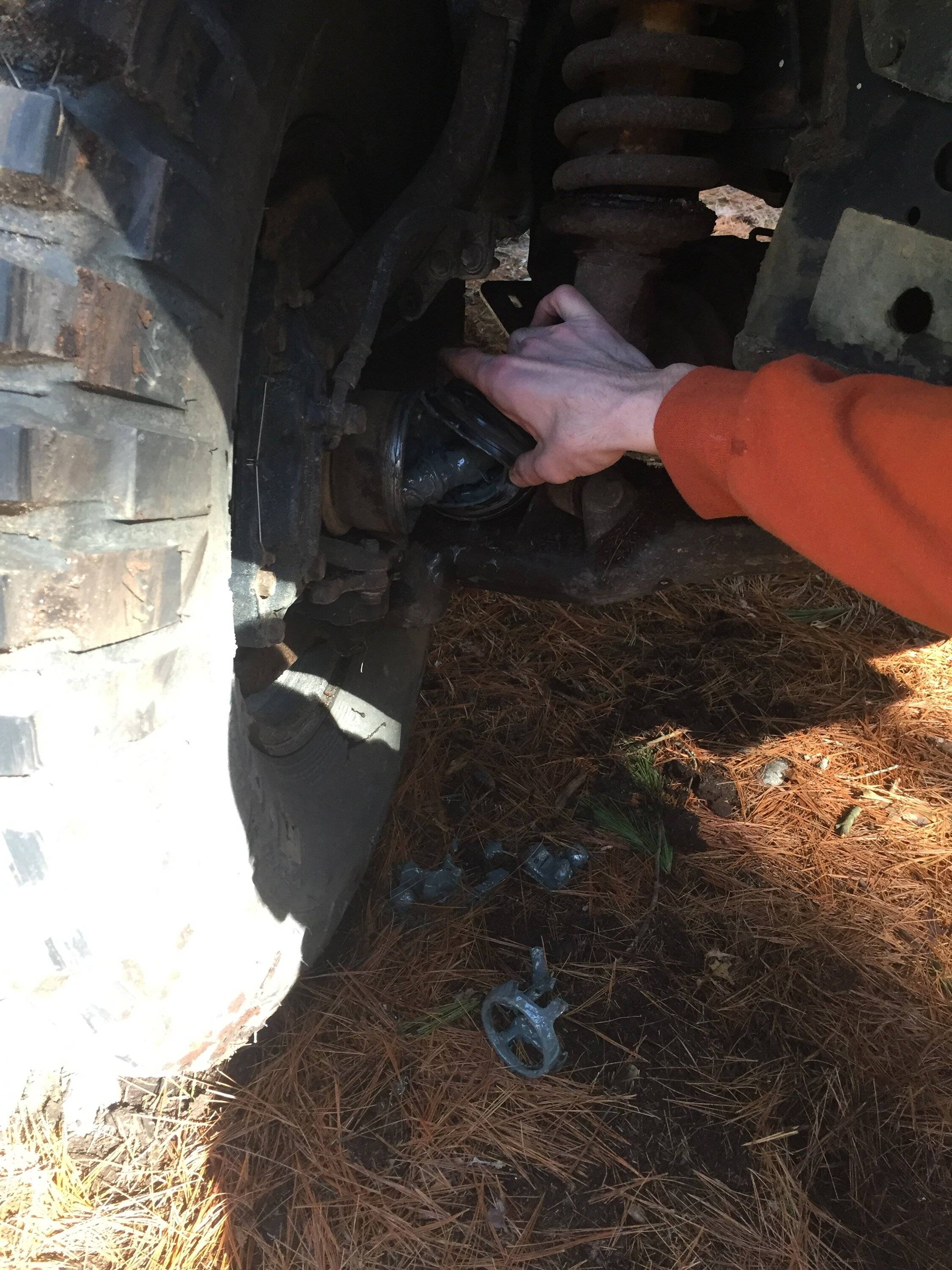

bye bye CV. OH lord the amount of Toyota CVs I have replaced trailside. Its astonishing for what's supposed to be the most reliable 4x4 u can buy. Hell the GX470 in my profile pic had a blown CV when i took the shot. ?
I broke a ton of them. Trick was to buy the autozone ones with a lifetime warranty. It would tie me up for about 45mins if I did it on the trail. Then I added a doubler to mine and got both at once. But if you leave the stub shafts in either end you can remove the center with a screw driver and drive home.
