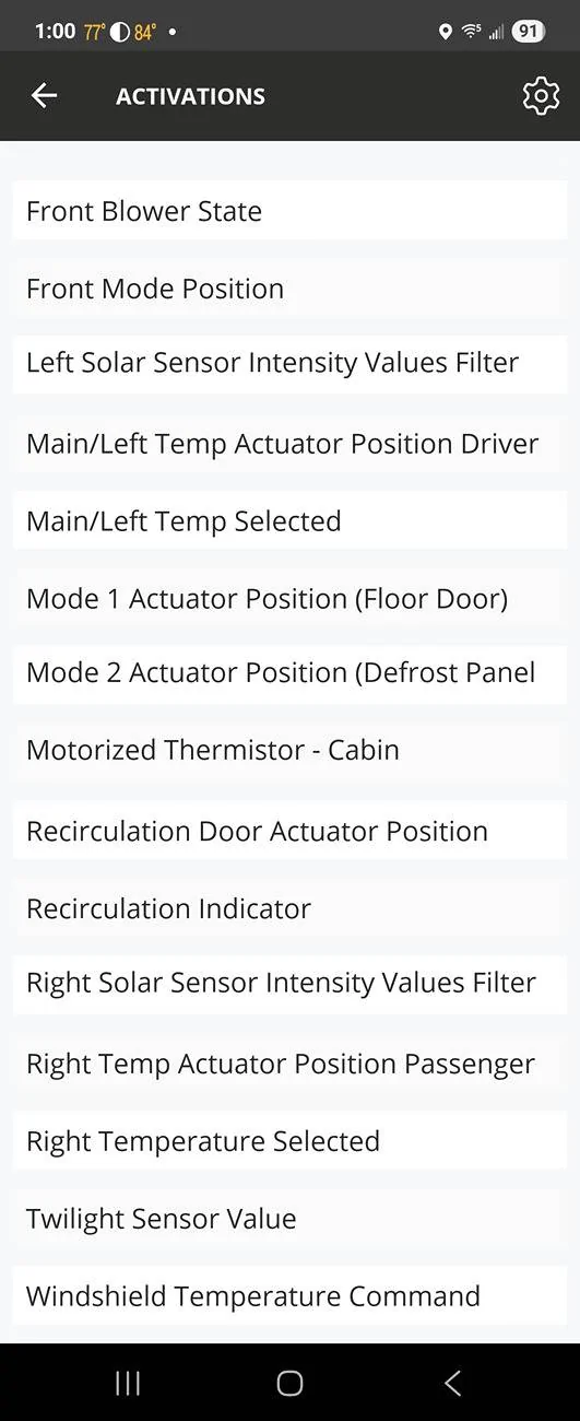

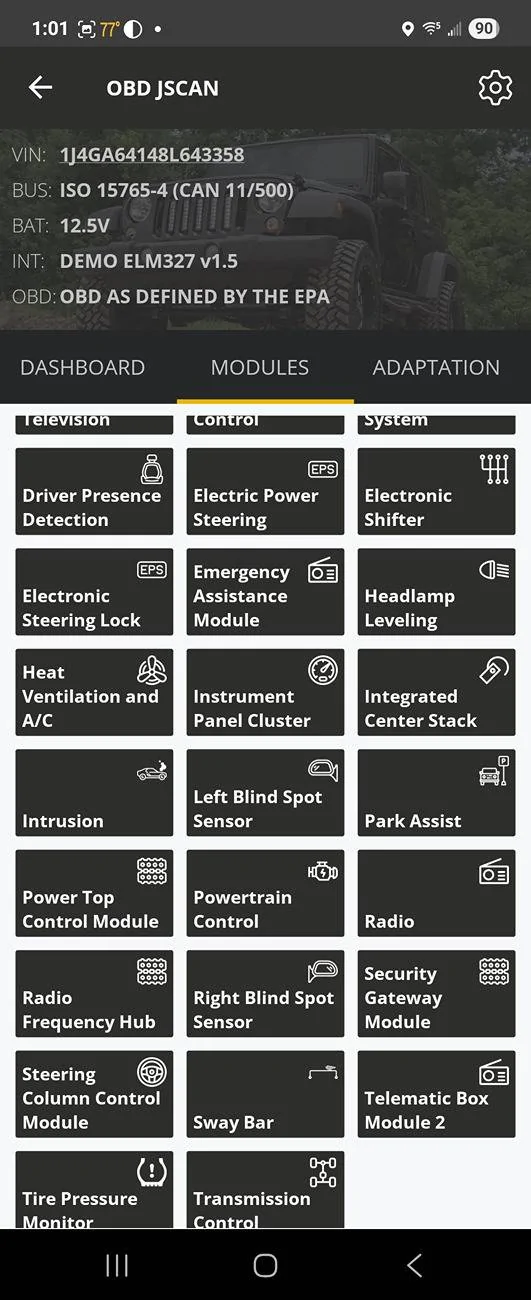

Looks like a trip to the dealer unless you have Jscan, you could at least operate the side affected.
Jeep Gladiator 25 Mojave passenger side vents blow hot Screenshot_20250520_010003
Jeep Gladiator 25 Mojave passenger side vents blow hot Screenshot_20250520_010122
