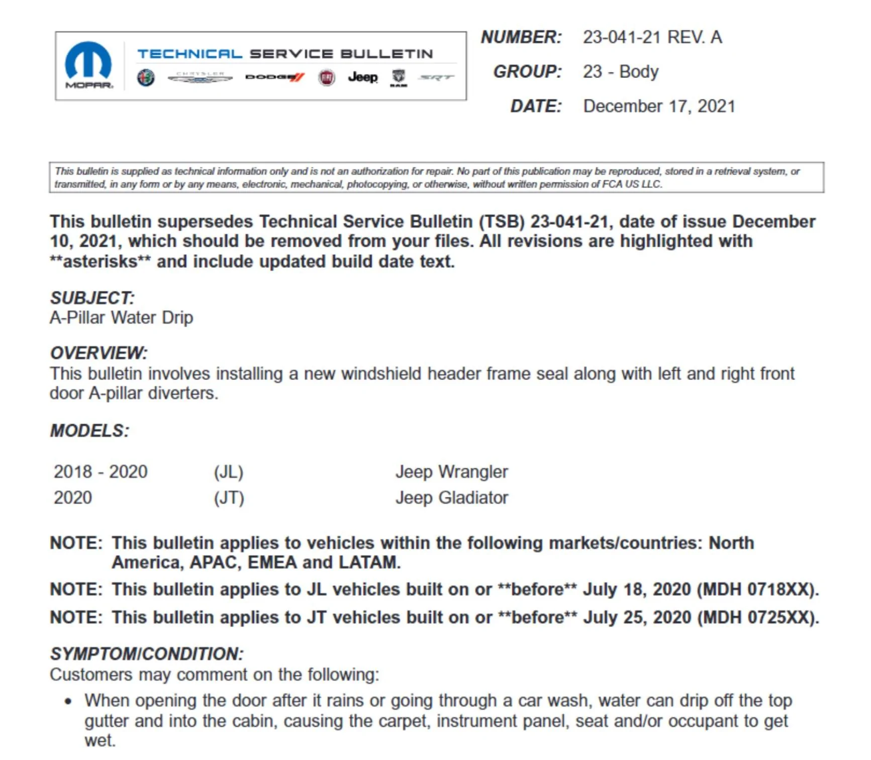

If the info in this TSB does not help, you could try narrowing down the origin point by putting a rag in the door seal to see if it gets wet when it rains.
Windshield header seal TSB 23-041-21
Replace windshield header seal and add diverter pieces to a-pillar
Build sheet for Sport S with TSB completed -
https://www.jeep.com/webselfservice/BuildSheetServlet?vin=1C6JJTAG7LL153158
Posted complete by RetCop402 from Indiana on 12/1/22 - https://www.jeepgladiatorforum.com/...tsb-23-041-21-rev-a.63674/page-5#post-1067199
A Pillar Trough Right 68453376AA X1 $35.69
A Pillar Trough Left 68453377AA X1 $35.69
Seal Windshield Header 68271695AI X1 $70.65
Rivet Windshield Header X4 $ 1.50
Jeep Gladiator Water Leak Bottom Passenger Side 1672097553381
https://www.jeepgladiatorforum.com/forum/attachments/jl-jt-header-seal-pdf.286237/

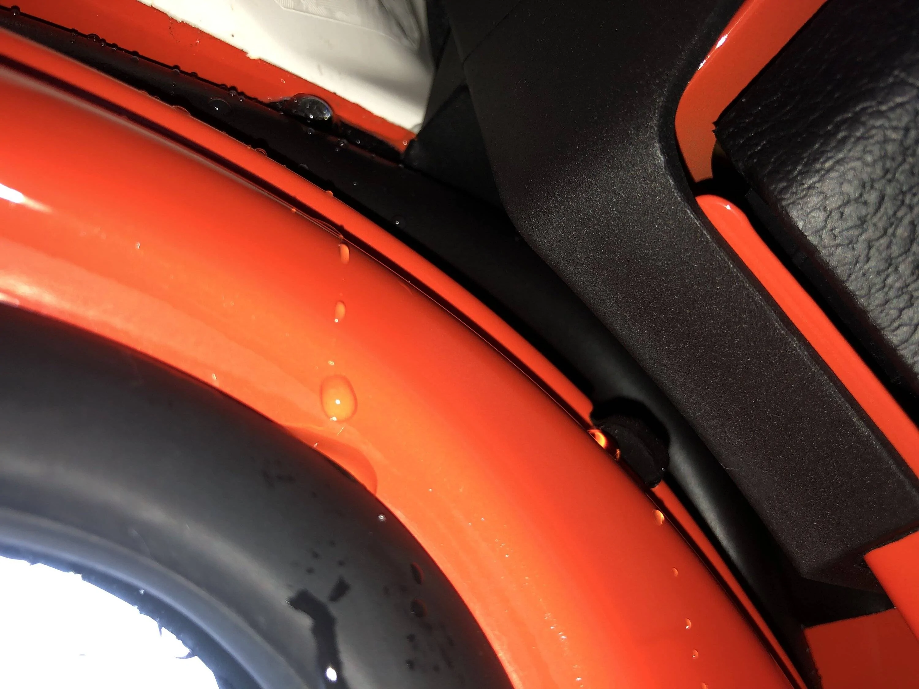

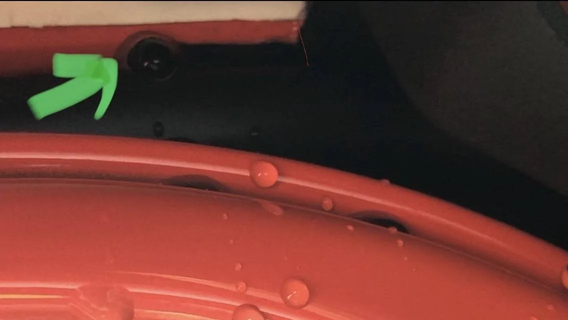

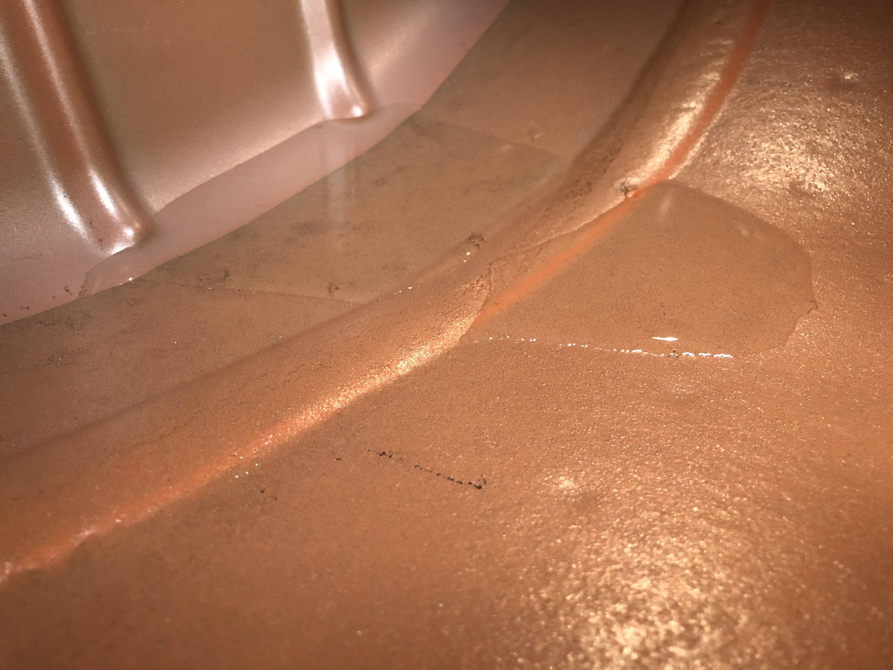

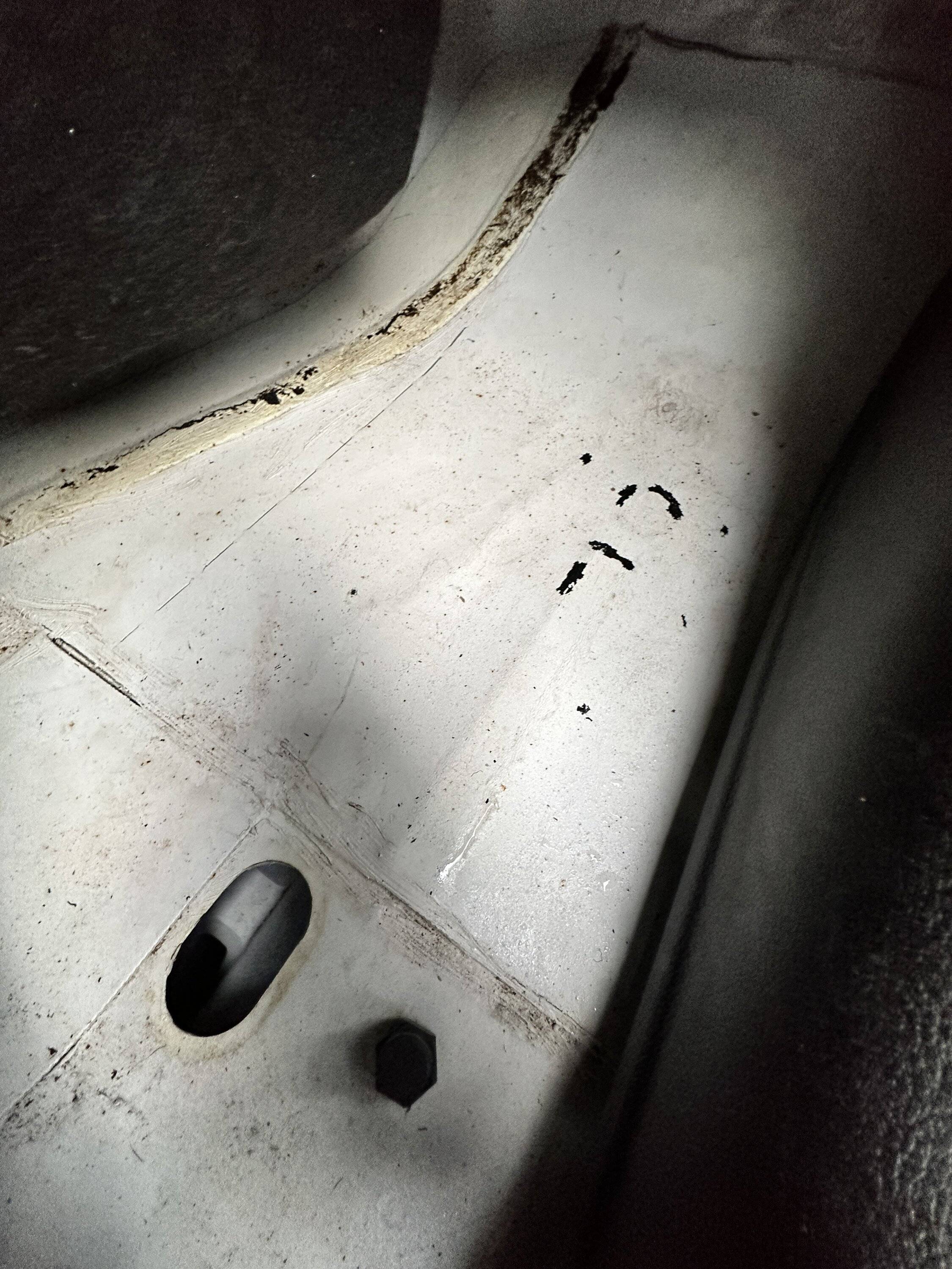

I had a similar leak (from the corner of the Freedom top on the passenger side of my 2020) that would fill the passenger floorboard. It would run down the side of the seat similar to the seat water marks I see in the OP's photos. I never had the top off before this issue started, but I reset the top panels several times to see if the leak would stop. The gaskets were totally clean with no visible imperfections.
Here is where I tracked it to:
Jeep Gladiator Water Leak Bottom Passenger Side IMG_3245
Jeep Gladiator Water Leak Bottom Passenger Side IMG_E3248
Unfortunately, I cannot report what a repair would be. My 5K mile truck was totaled at the dealership when I brought it in for this repair....
Jeep Gladiator Water Leak Bottom Passenger Side under water
