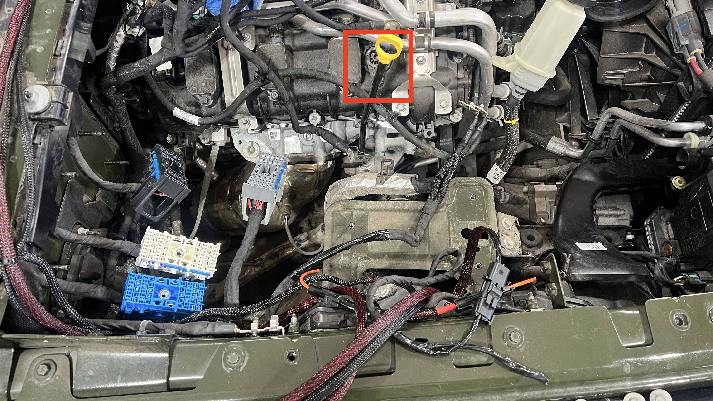

Man, bummer.. Is it not able to come off without pulling the battery tray?
It can be done, but it is much easier with the TIPM and battery box out of the way.

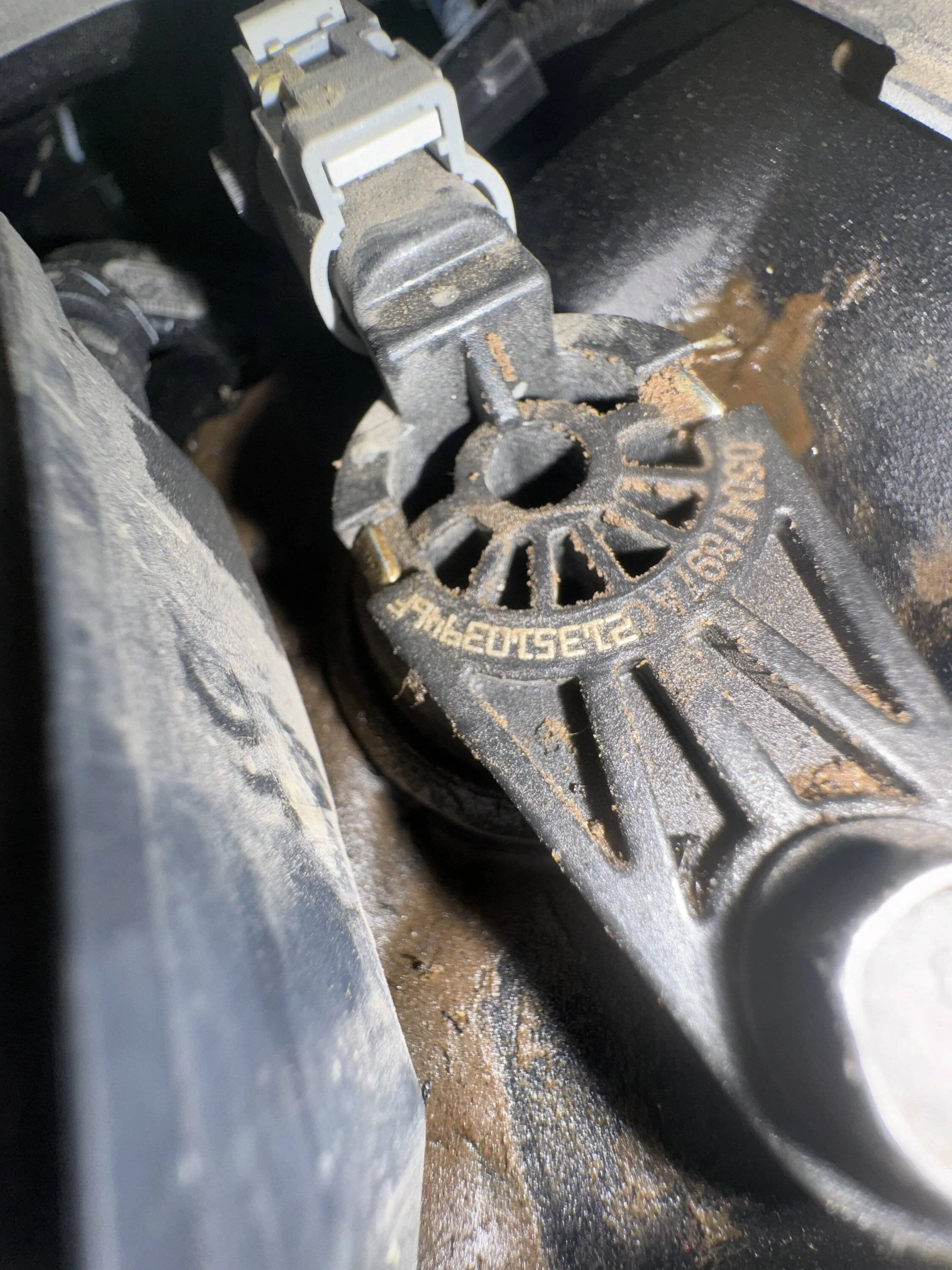

This position sensor also was leaking on both my wrangler
I remove it cleaned the sensor and gasket put a small amount of black RTV silicone on the seal area and so fare no more leaks
That is actually the variable valve lift solenoid. It is a common leak point on these engines, but the leaks are relatively minor.

Your are right. It is the variable valve lift solenoid
On both my Wranglers there was a small amount of seeping oil
Remove the one bolt unplug the wire
Clean both areas
Coat area with RTV silicone
reinstall
This will stopped the seeping oil

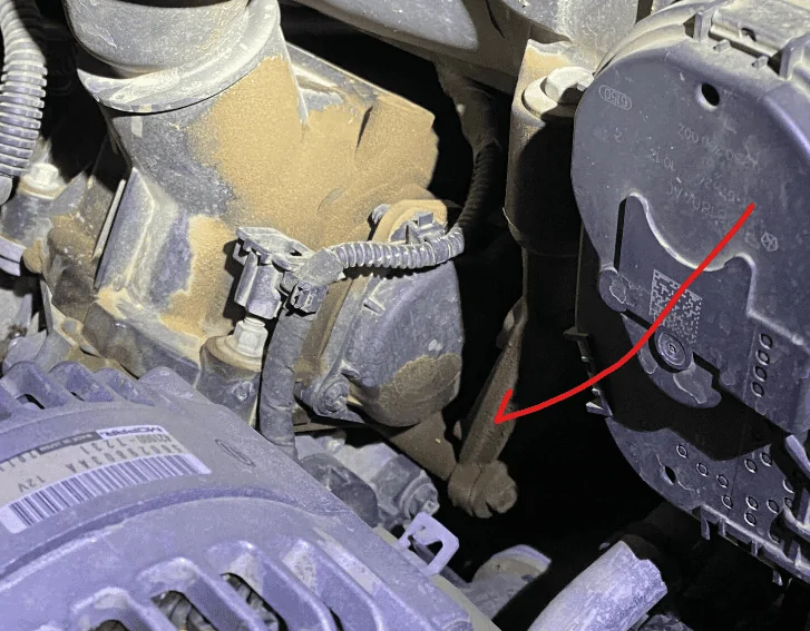

All I see is a lot of red AZ dust - do you mean what the dust is sticking to?
I don't see oil here - except in this part of the top pic -

When doing battery work last weekend I noticed a very thick buildup of sludge (probably just dirt adhered to oil seepage) around this area. Pretty sure this is the camshaft position sensor.
This is an old picture so no visible leak here - vehicle was relatively new here.
Anyone else ever report having leaking in this area? I'll try to get a better picture later today.

36k and mine is leaking for the second time. I'm out of warranty, but have purchased the seal, but I'm having a hard time removing the electrical clip. Any suggestions? I've pushed the large tab back and squeezed. wiggled and prodded to no avail. Help?
