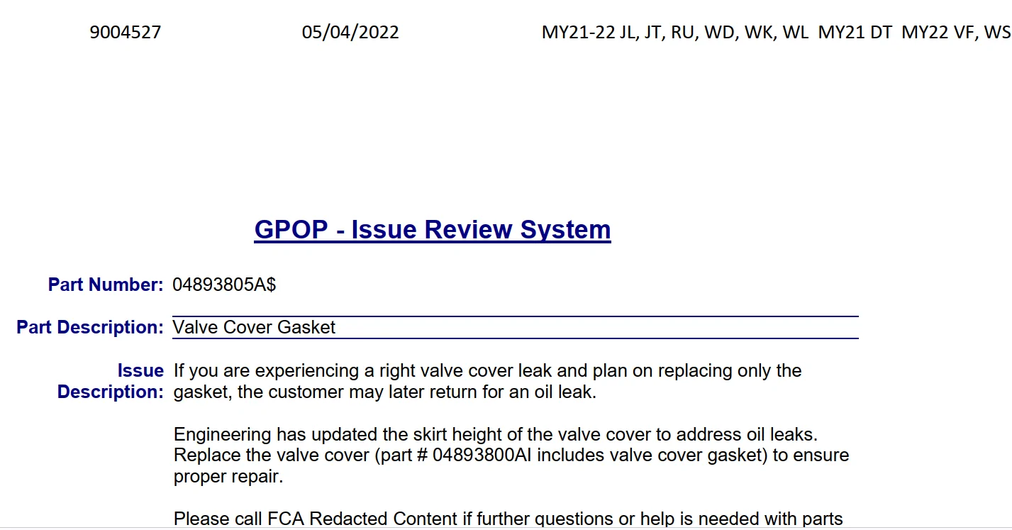

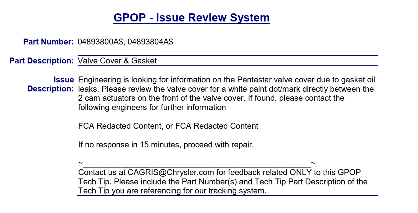

The first one applies to 21 and 22 model years, but I wonder..................the second one applies to 2020...
