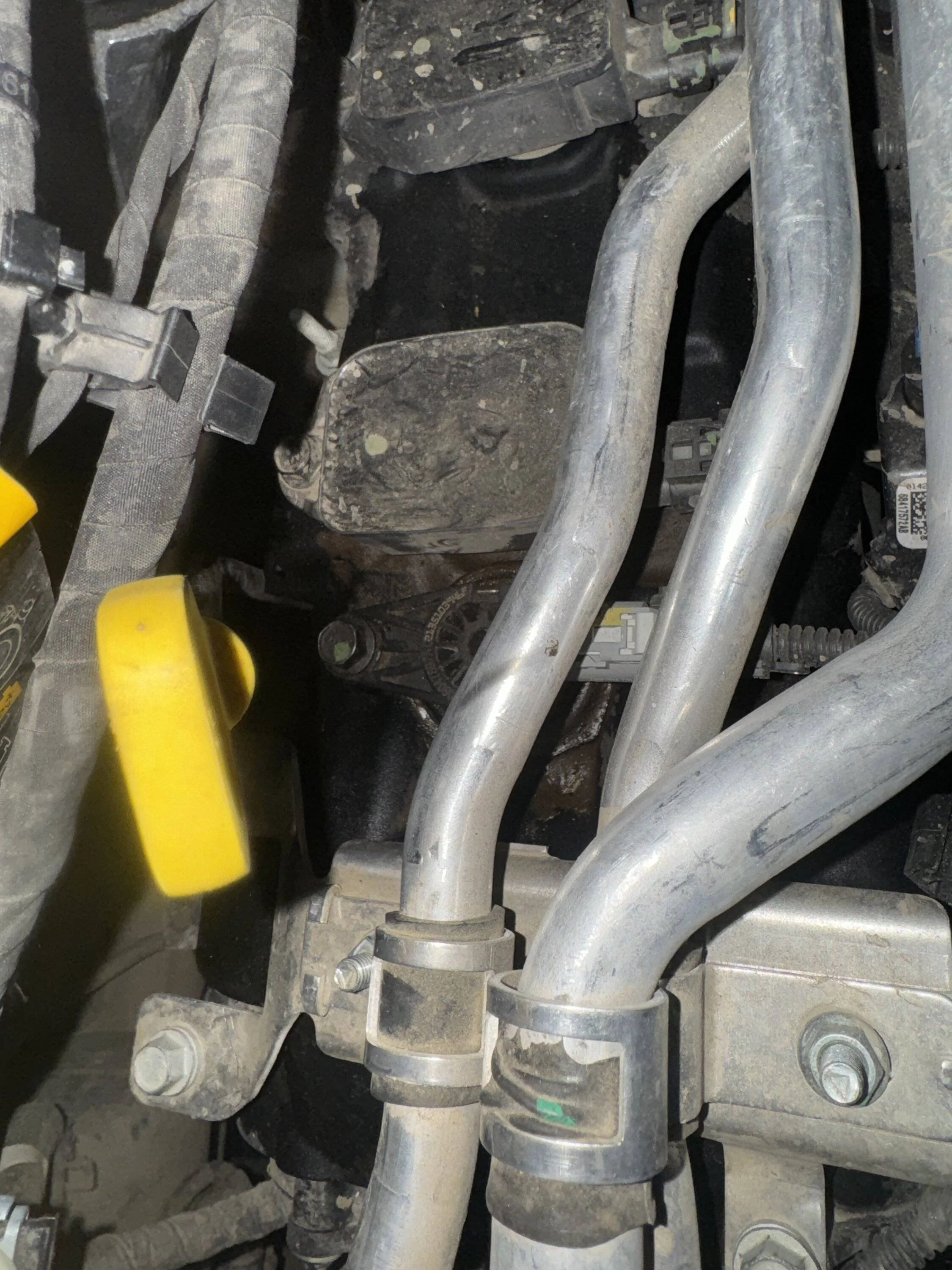

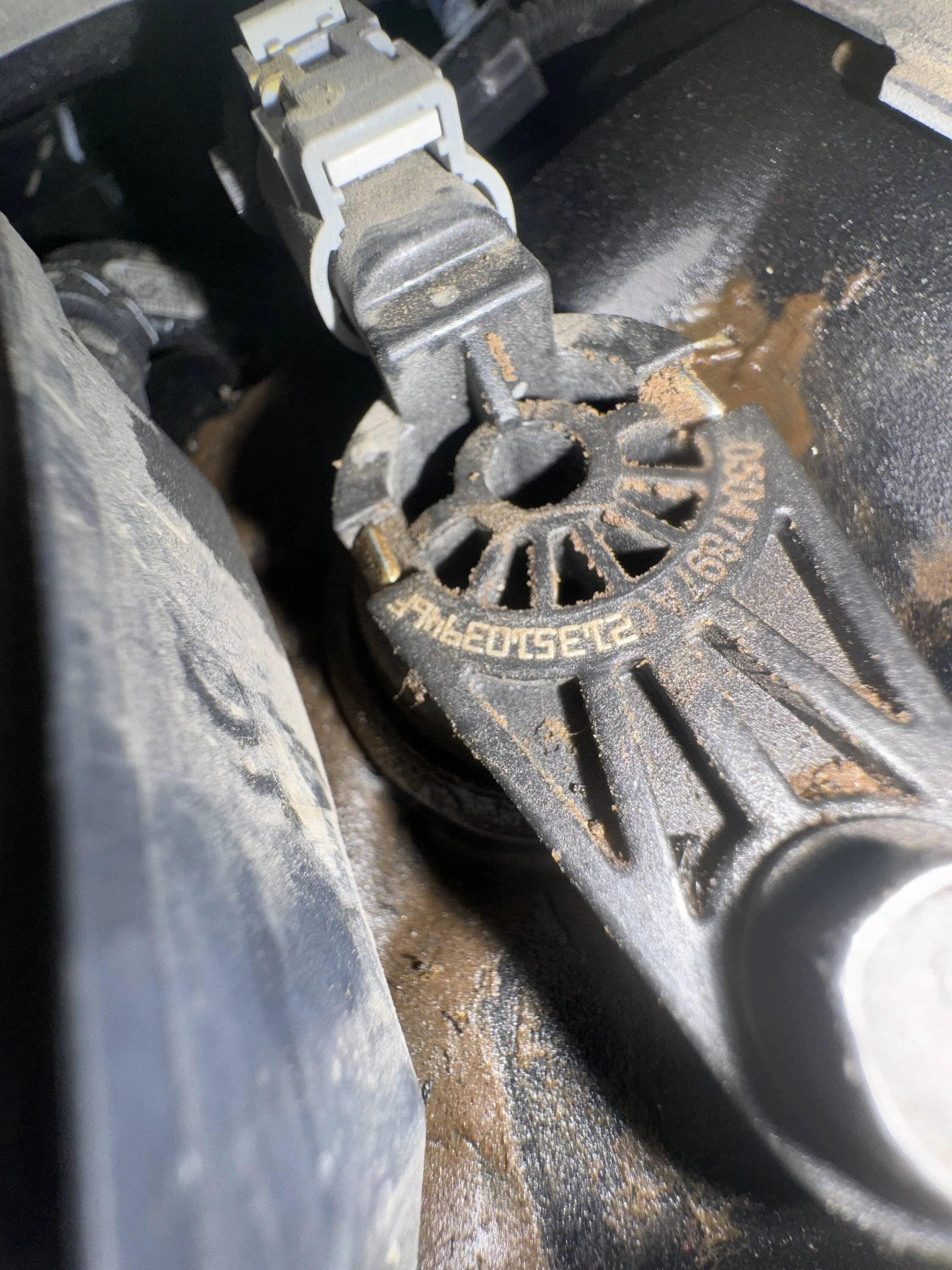

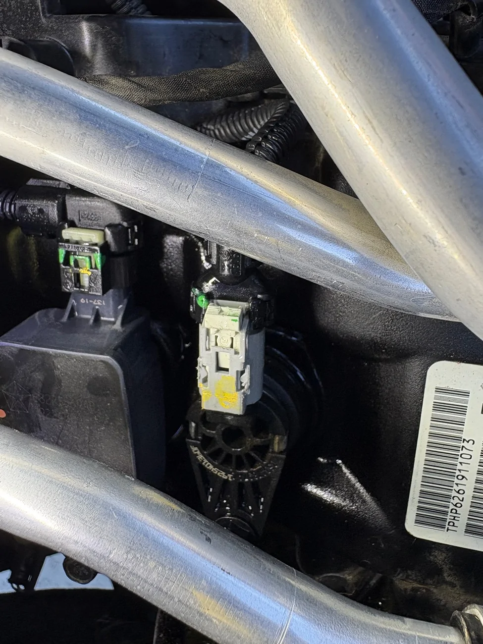

36k and mine is leaking for the second time. I'm out of warranty, but have purchased the seal, but I'm having a hard time removing the electrical clip. Any suggestions? I've pushed the large tab back and squeezed. wiggled and prodded to no avail. Help?
Try pushing the connector in while pushing down on the tab, sometimes this helps release them. They can be a pain sometimes.
