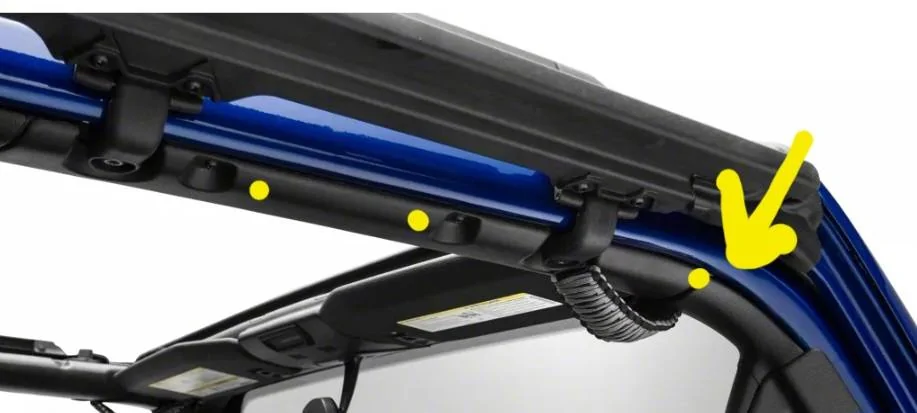

My top right bolt that screws into the front/top by the windshield comes loose and rattles.
The screws by the yellow dot.. the one that constantly rattles is the one behind the arrow.
