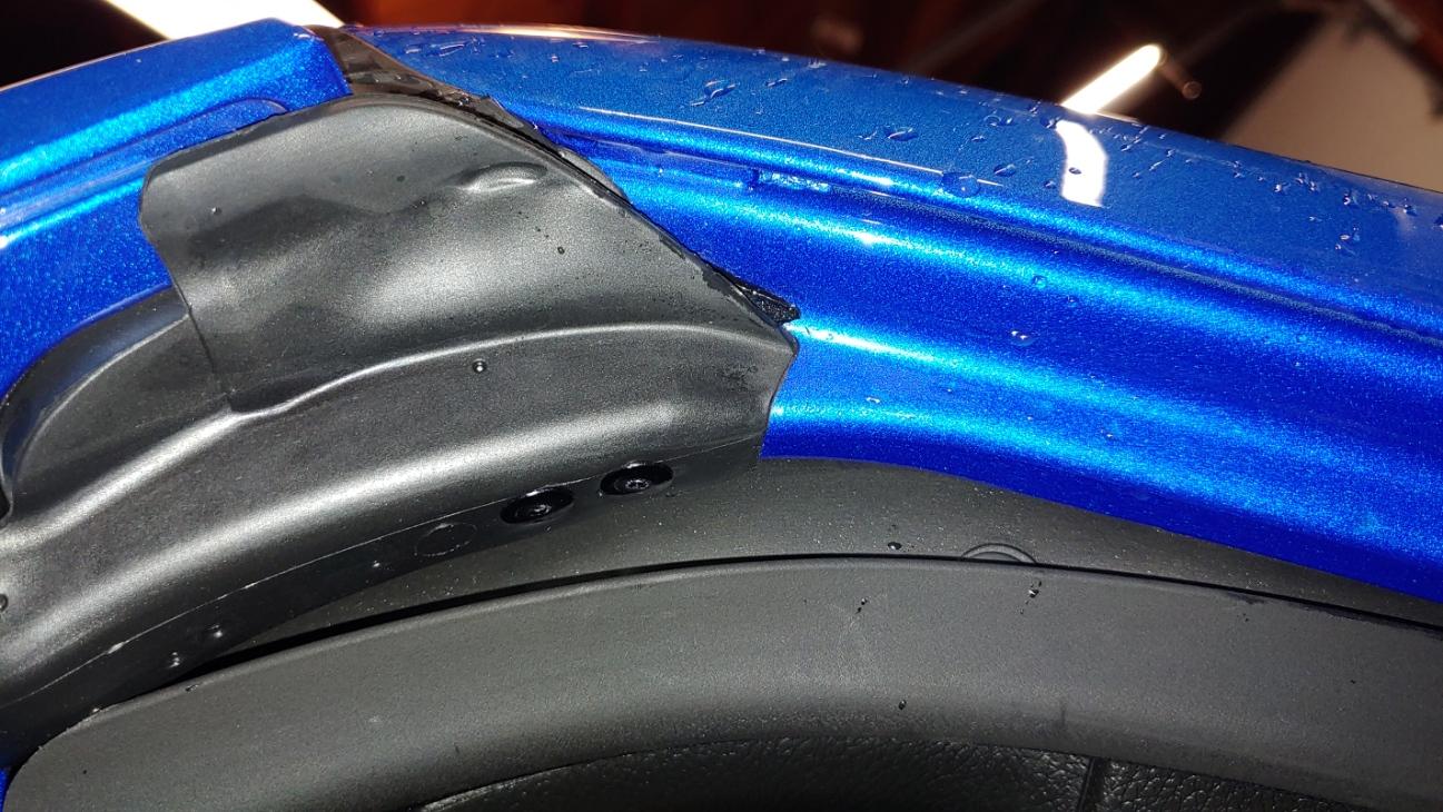

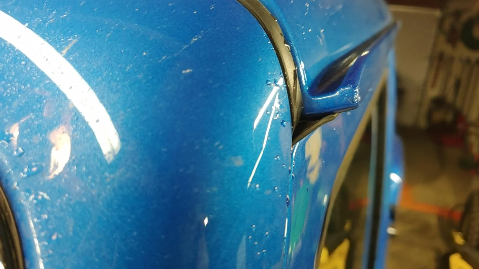

I'd call this an improved design - not that the original was "flawed" really. Not ideal, no, but hardly a warranty item, IMO. This is just "better", either a lot better or marginally so - that's up to the individual.
Water from driver side drip rail, which ideally is slanted inward, drops off the front of the drip rail to the rubber "funnel".
Jeep Gladiator A-Pillar Water Drip (TSB 23-041-21 REV. A) 20221129_123609
Water follows the inside of the "funnel" or guide, like water does, clinging to the smooth surface, and drips or runs into the plastic channel below -

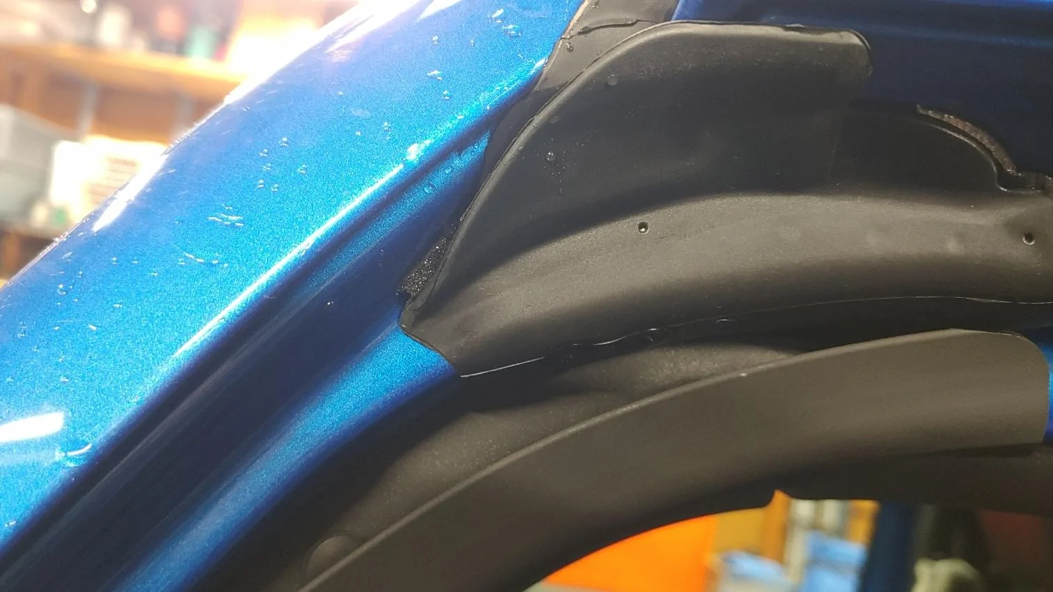

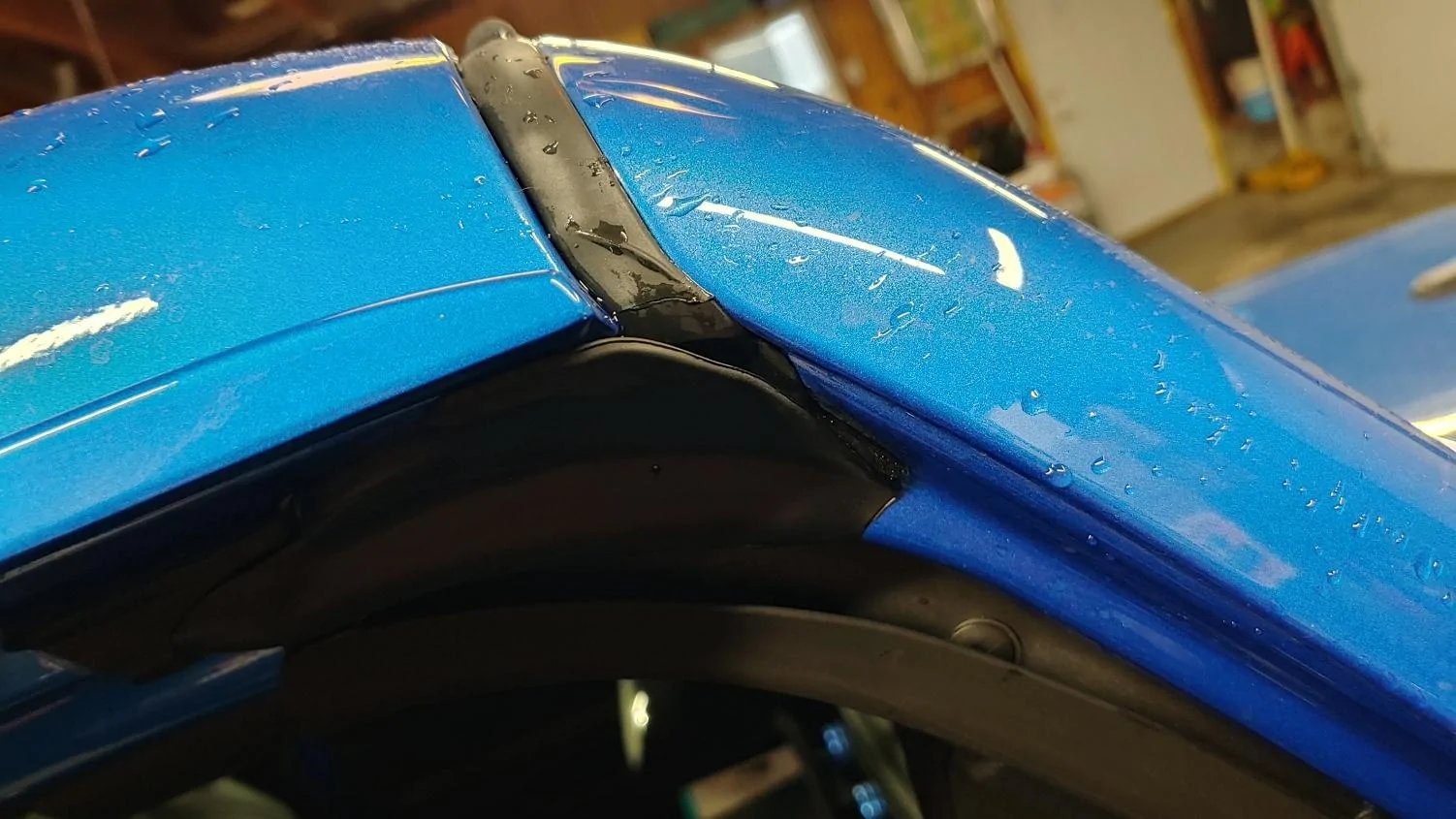

Same for right side - water hopefully caught as it exits the front of the right drip rail, into the rubber guide/funnel and follows that forward and down -
Jeep Gladiator A-Pillar Water Drip (TSB 23-041-21 REV. A) 20221129_123527_HDR
...where it drops to the plastic channel and down

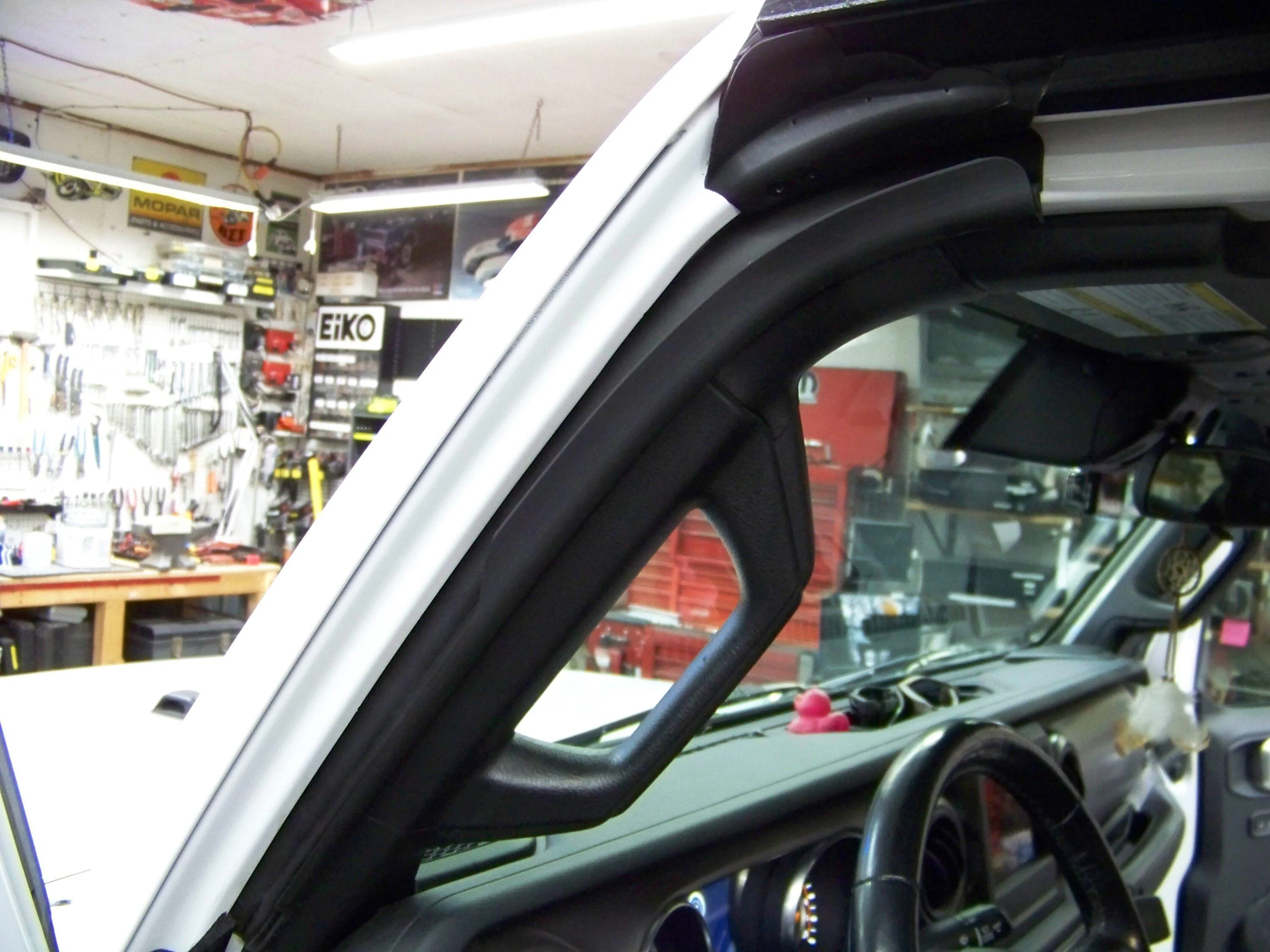

Just picked up my 2020 Gladiator Sport S from my dealer this afternoon, they had it for 2 days to install the left and right A-Pillar seals and the Windshield Header seal per the TSB 23-041-21 REV. A. Will keep everyone posted on if these seals take care of the water running in onto the floor!
Jeep Gladiator A-Pillar Water Drip (TSB 23-041-21 REV. A) 100_8129
Jeep Gladiator A-Pillar Water Drip (TSB 23-041-21 REV. A) 100_8130
Jeep Gladiator A-Pillar Water Drip (TSB 23-041-21 REV. A) 100_8131
Jeep Gladiator A-Pillar Water Drip (TSB 23-041-21 REV. A) 100_8132
