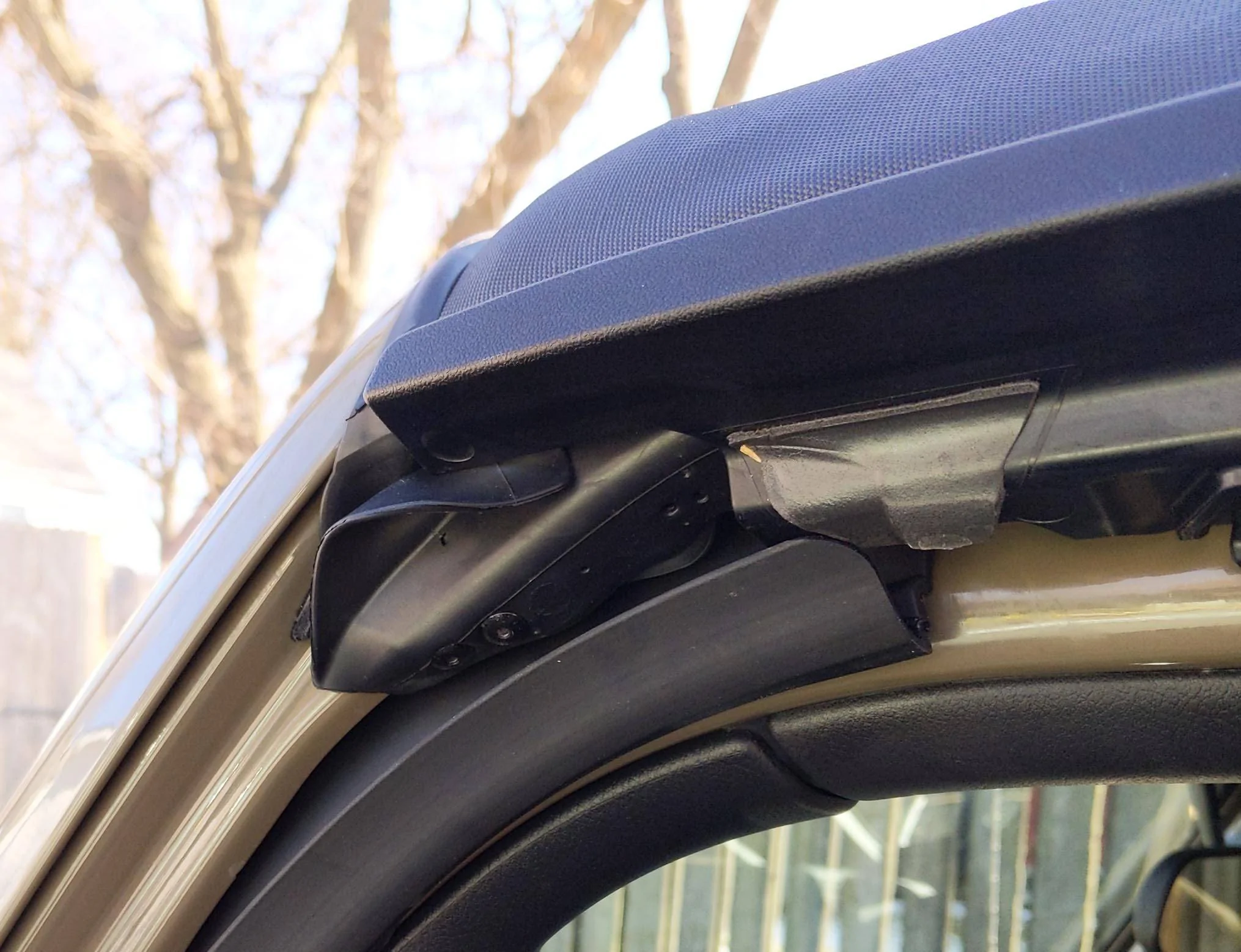

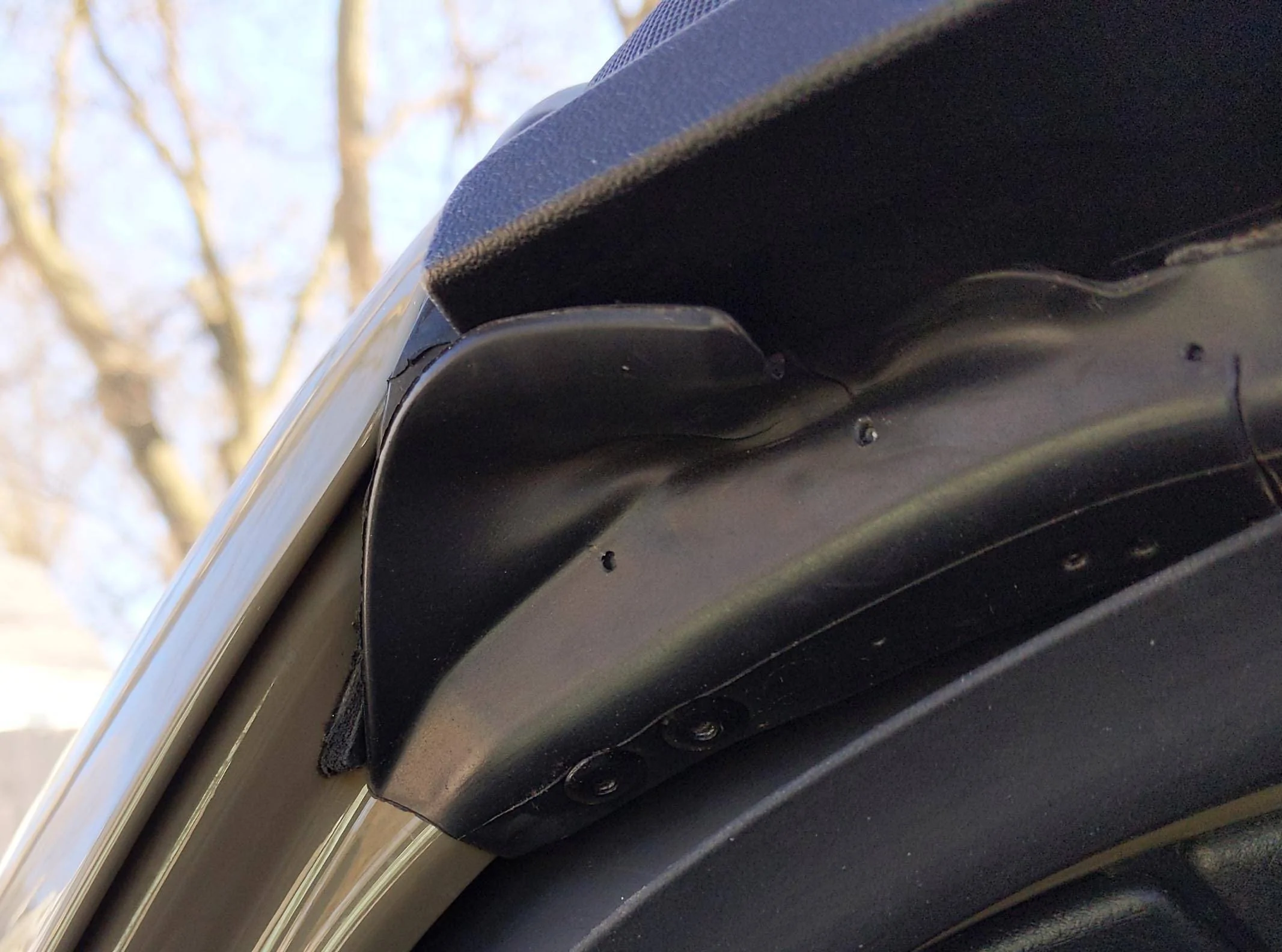

I recently had this done and was looking at it today and thought it didn't look quite right. My initial thought was that it's not compatable with the Sunrider, but after some additional investigation I realized it was just a sloppy install.
Jeep Gladiator A-Pillar Water Drip (TSB 23-041-21 REV. A) a pillar drip fix
It still seems a little off, but I got it adjusted enough the that seems seal correctly when the door is closed.

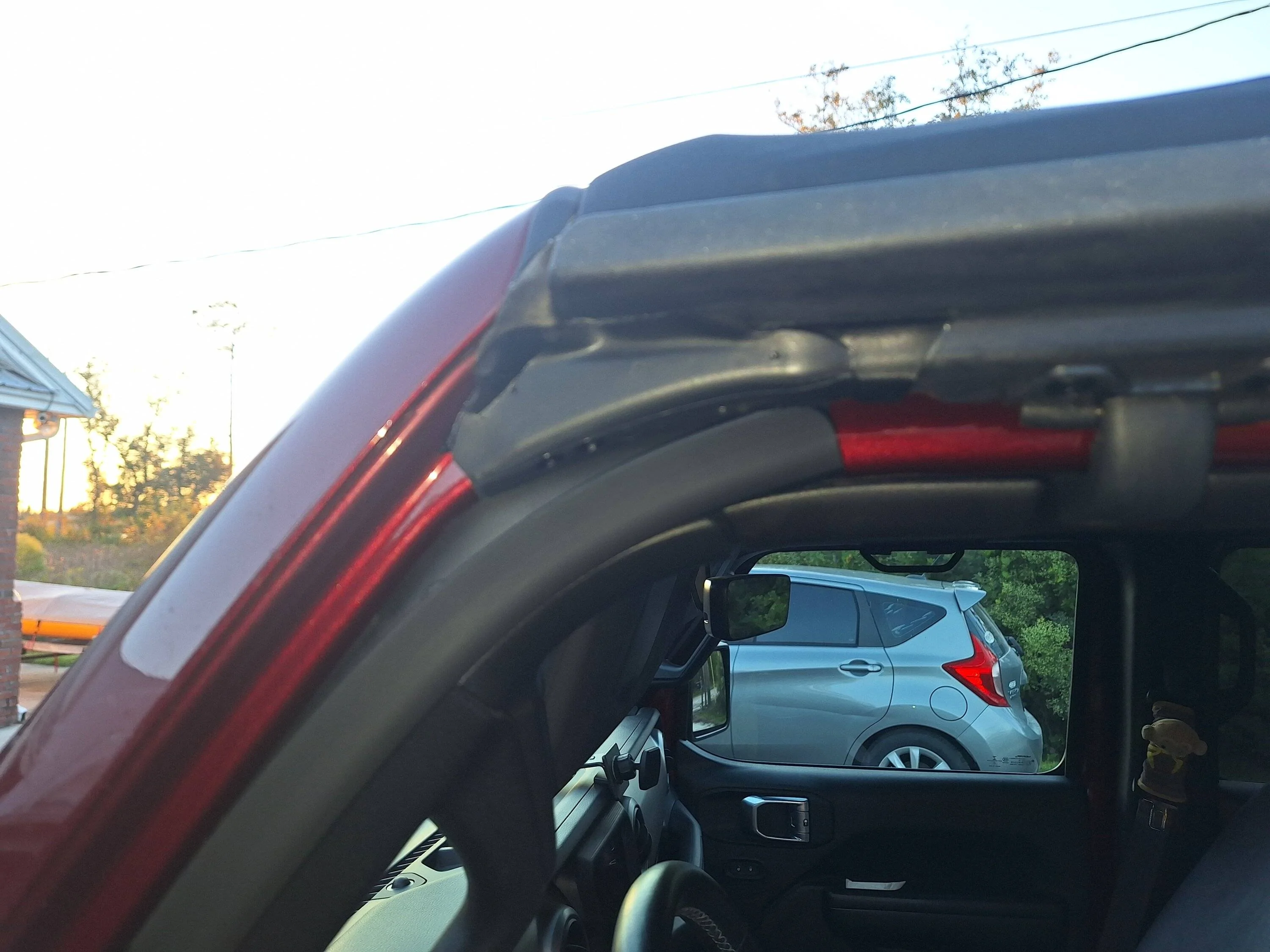

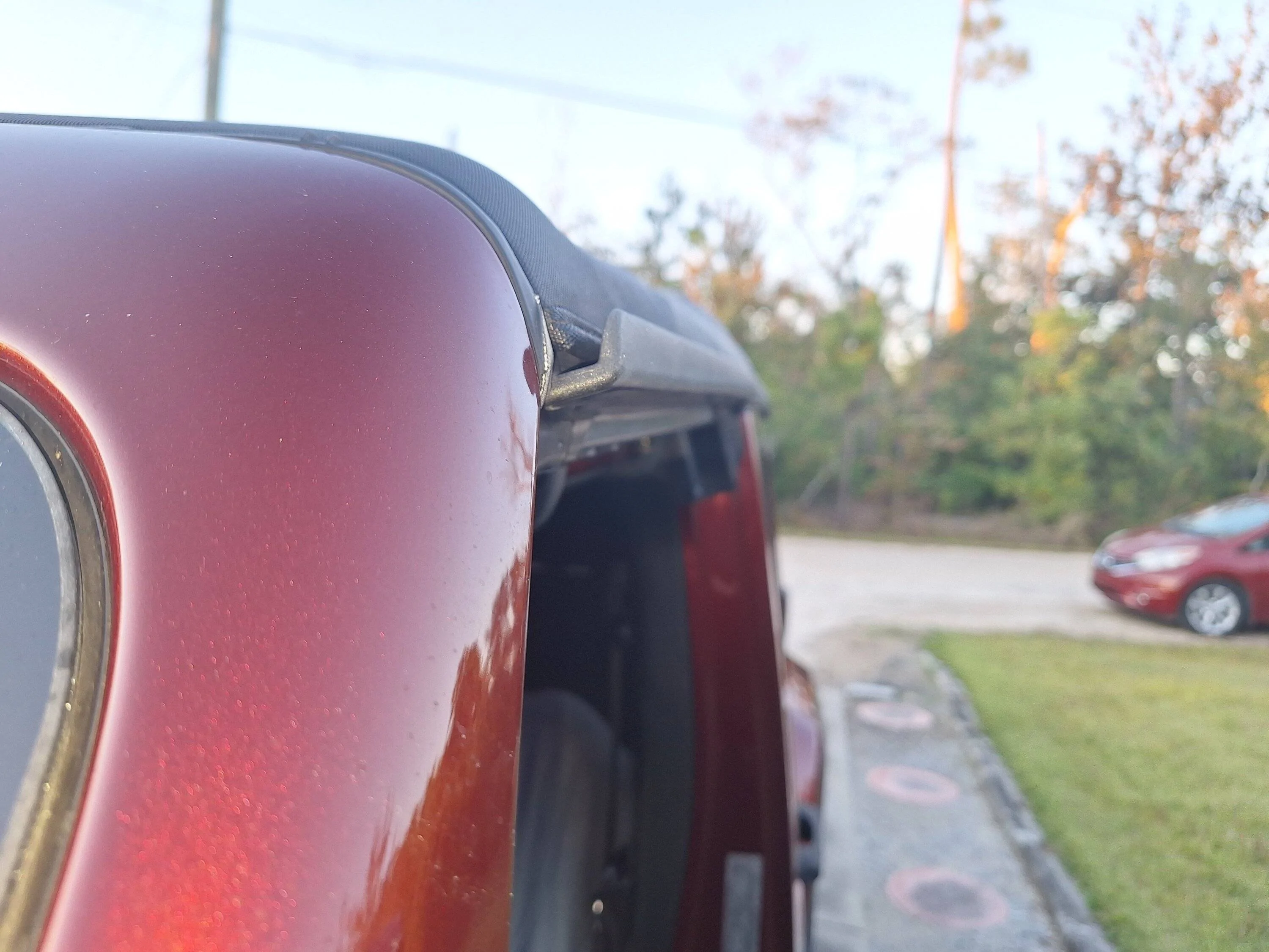

Yup, My 2021 does not have this latest seal at the windshield header (or its installed wrong) and the water pours in vs being channeled into the Diverters by the seal flap..
I have been to my dealer a few times trying to get it replaced/fixed and they keep telling me mine is fine and the TSB does not apply to my year..
I have sent them photos of ones with the TSB done and told them to look at the ones on the lot and compare to mine and they still wont touch it.
Perhaps @JeepCares can provide some assistance on this.
