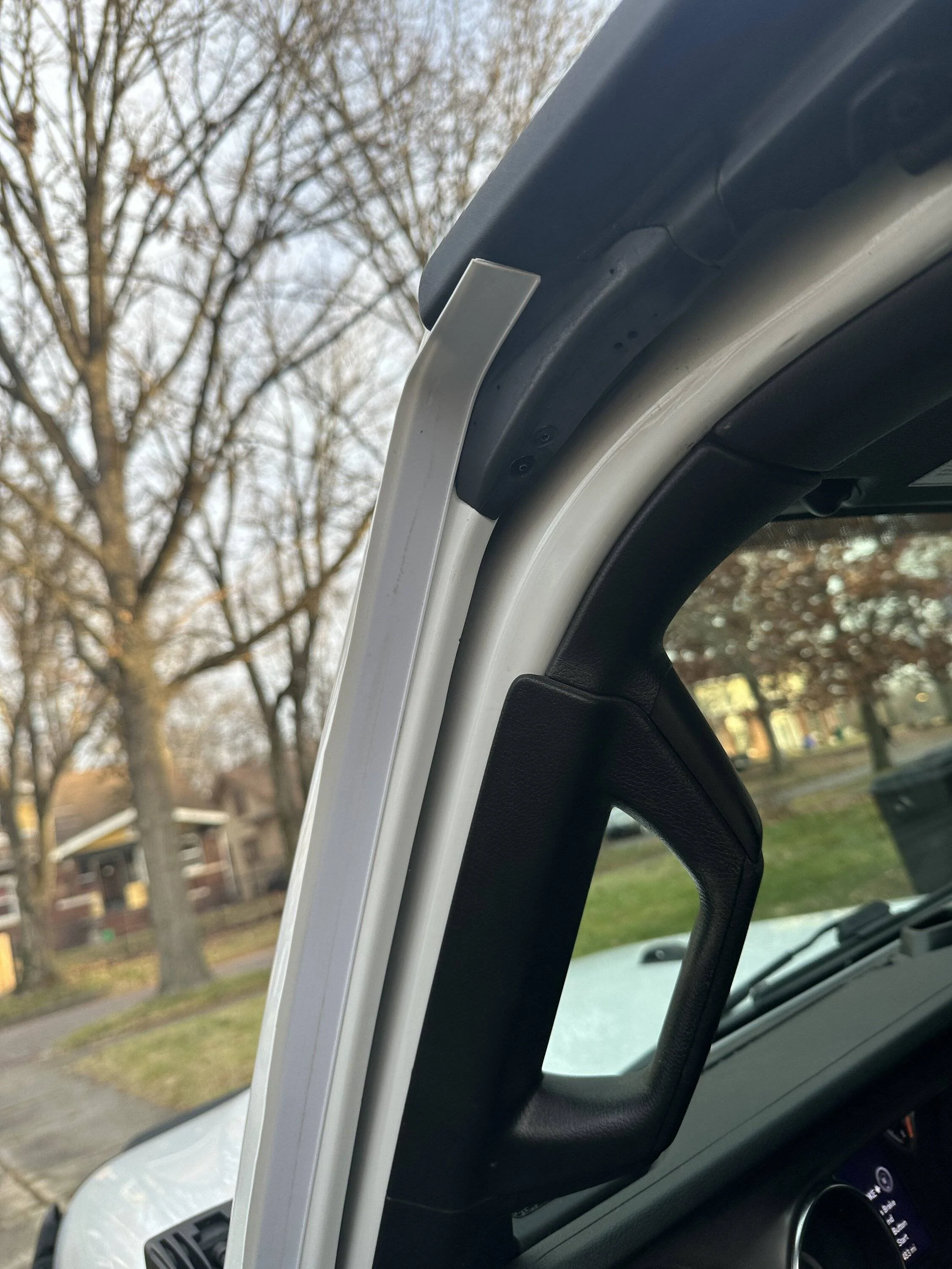

Yup, My 2021 does not have this latest seal at the windshield header (or its installed wrong) and the water pours in vs being channeled into the Diverters by the seal flap..
I have been to my dealer a few times trying to get it replaced/fixed and they keep telling me mine is fine and the TSB does not apply to my year..
I have sent them photos of ones with the TSB done and told them to look at the ones on the lot and compare to mine and they still wont touch it.
Perhaps @JeepCares can provide some assistance on this.
Yours looks like the one All Mopar Parts shows in their kit though?
Map Title 23-041-21 REV. A (allmoparparts.com)
It's different than the previous images with the little tabs added on but I think that you have the newer style? You at least have the "diverter" (gutter) parts
Is the part with the tabs the header then???
I'm interested too because mine looks like yours. I'm just as confused. If we just need the windshield header part that would be nice.

Yea, on the 21's I think we just need the updated header seal with the flap/tab that fits up under the gutter.
Mine as it currently is pours out over the diverters into the truck on mostly level ground.
