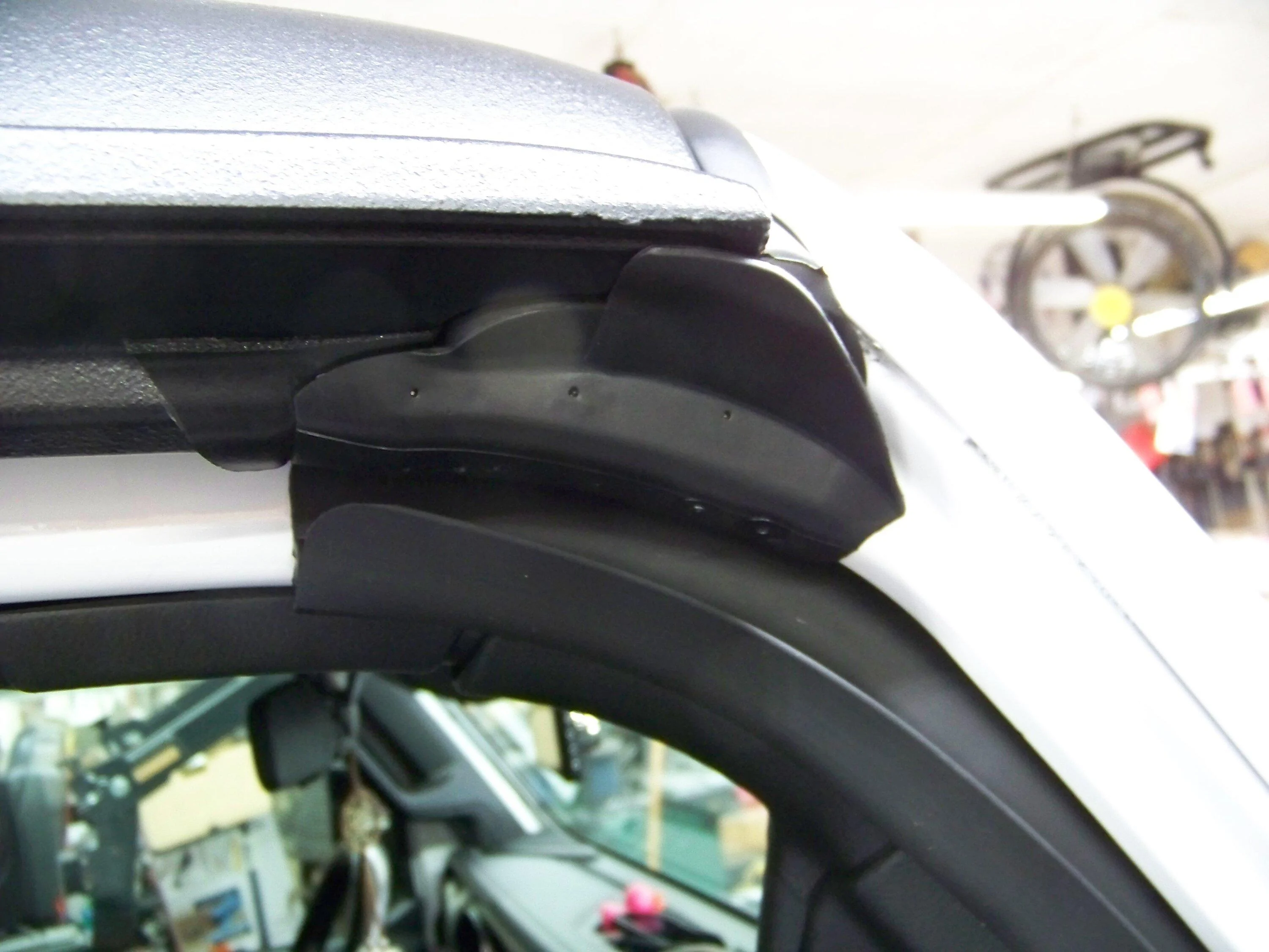

Just picked up my 2020 Gladiator Sport S from my dealer this afternoon, they had it for 2 days to install the left and right A-Pillar seals and the Windshield Header seal per the TSB 23-041-21 REV. A. Will keep everyone posted on if these seals take care of the water running in onto the floor!
big storms working across the country so should be able to test real soon,

The TSB only details the install of the diverter pieces on the sport bar. Can you post the instructions for the header piece - following is from the TSB: Remove current header seal and install new revision header seal. Refer to the detailed service procedures available in DealerCONNECT/Service Library under: Service Info 23 - Body / Weatherstrip/Seals / Weatherstrip, Header, Roof / Removal and Installation.
thx!
40,506
54,031
thx!
TSBs always refer the tech to the service library and you need access to that as a shop or tech or some paid subscription.
It's like checking the ball joint nuts - they refer the tech to the service library on how to lift the truck on a lift.
Not sure if he can actually post that part or not since it's not part of the TSB.

Does anyone have the instructions for doing this? After talking to my dealer this seems like an unnecessarily expensive repair to have done at a shop haha ill just do it my self if I can
40,506
54,031
My bet is time consuming as it involves more than just the door frame area - more than opening a door and applying a part.
If they charge $175/hour and it takes 2 hours, plus parts...........
