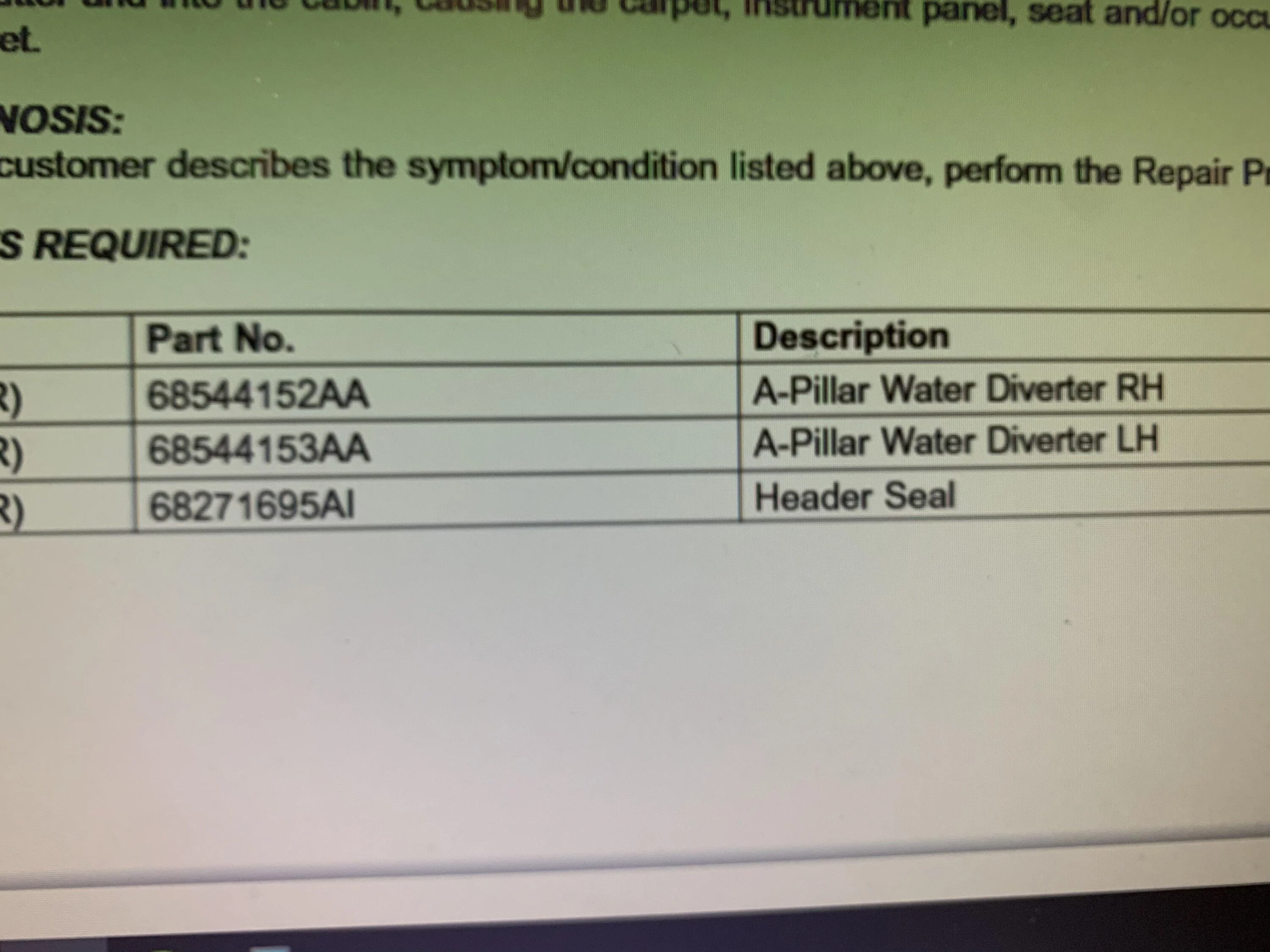

here are the part numbers
$10 for A-pillars & $75 for windshield header seal
Jeep Gladiator A-Pillar Water Drip (TSB 23-041-21 REV. A) BAEF223D-9174-42C2-BD29-8407584F52EB
